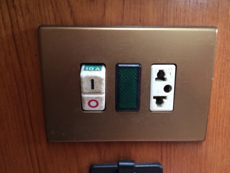

What is this? There is power to it evaluate it lights up but I don't what it's for.
The thing on the left looks to be a 10a breaker and the right side is a universal plug (flat or round pin).
It might be to an inverter or it might just run off the ship's AC power bus.
If it's still lit when you unplug the shore power or trip that breaker then it does run off an inverter.

Your boat was built in France it is a universal 110volt outlet that would take the round pin plugs they use in France.
The switch just turns the outlet on.

I would test the output with a voltmeter - set on A/C, just to be sure what you're dealing with.

What is this? There is power to it evaluate it lights up but I don't what it's for. <img src="http://forums.sbo.sailboatowners.com/attachment.php?attachmentid=70418"/>
What that is is a European style AC plug . it is attached to your shore power. Any 2 prong AC appliance or light will plug into it. If you need to plug in a standard 3 prong plug you have to use a cheater that eliminates the ground. I have these same units on my French built Beneteau 375. If you turn of the switch/breaker it turns off the outlet

Many European countries require outlets to be controlled by a switch. Though I think this is just simplifying the circuit protection by combining breaker and outlet. It's enough juice to supply a blender, curling iron, or a Hitachi Magic Wand. ;-)

I changed mine out to GFI's. As per above, it is your 110V outlet from your AC panel. They have a built in 10amp breaker.
