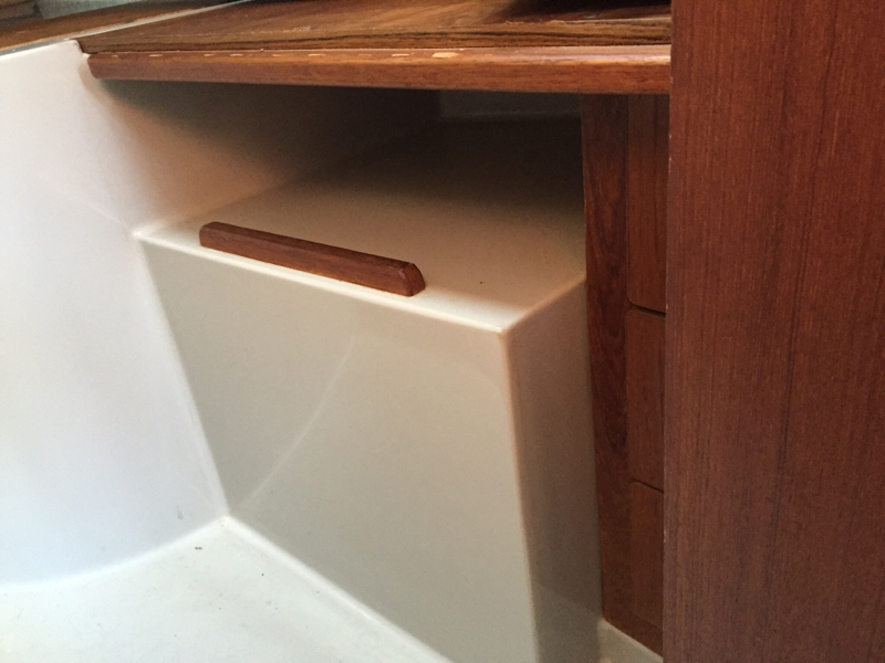

STill exploring a my new-to-me O'Day 322.....
This is on the starboard side of the V-berth....don't see any way to access it....is it just wasted space? Anyone cut an access door so you can use the space? There is a smaller one on the port side adjacent to the hanging locker (but not as big as this one...

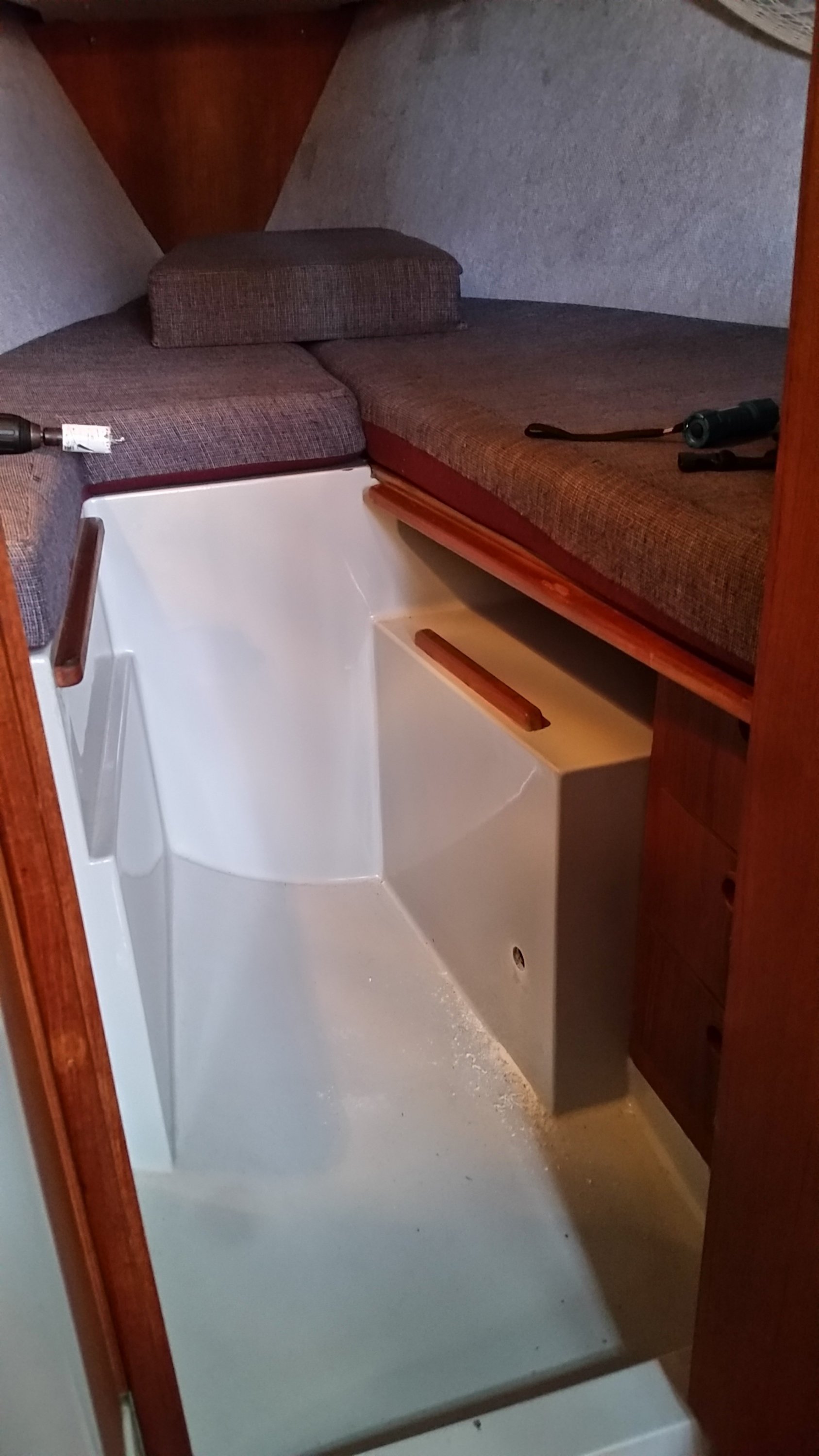

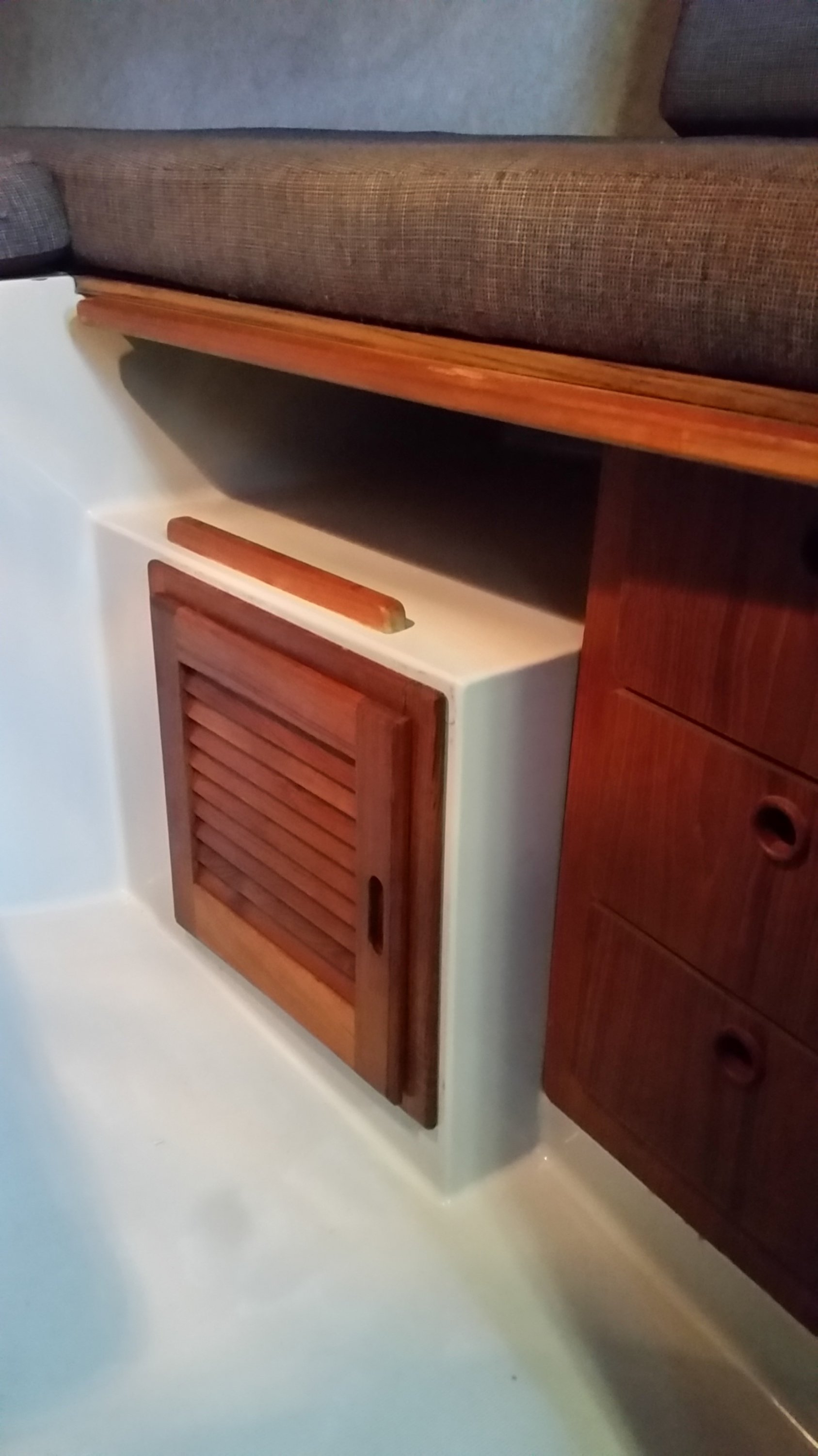

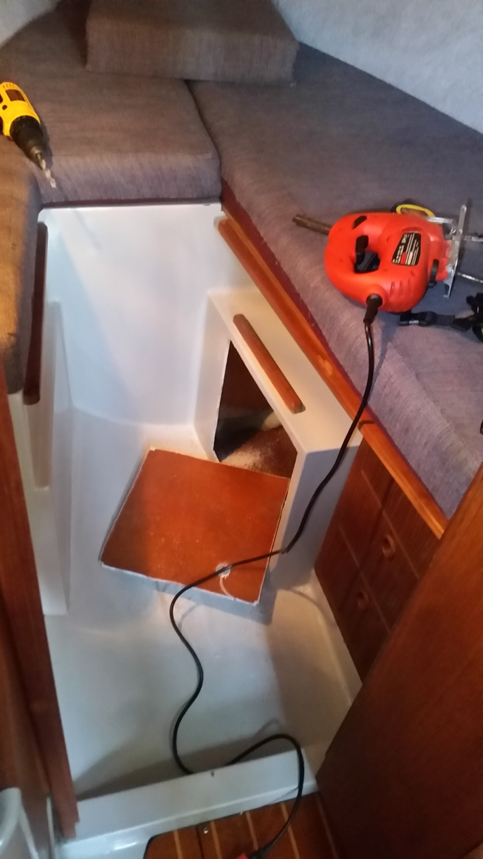

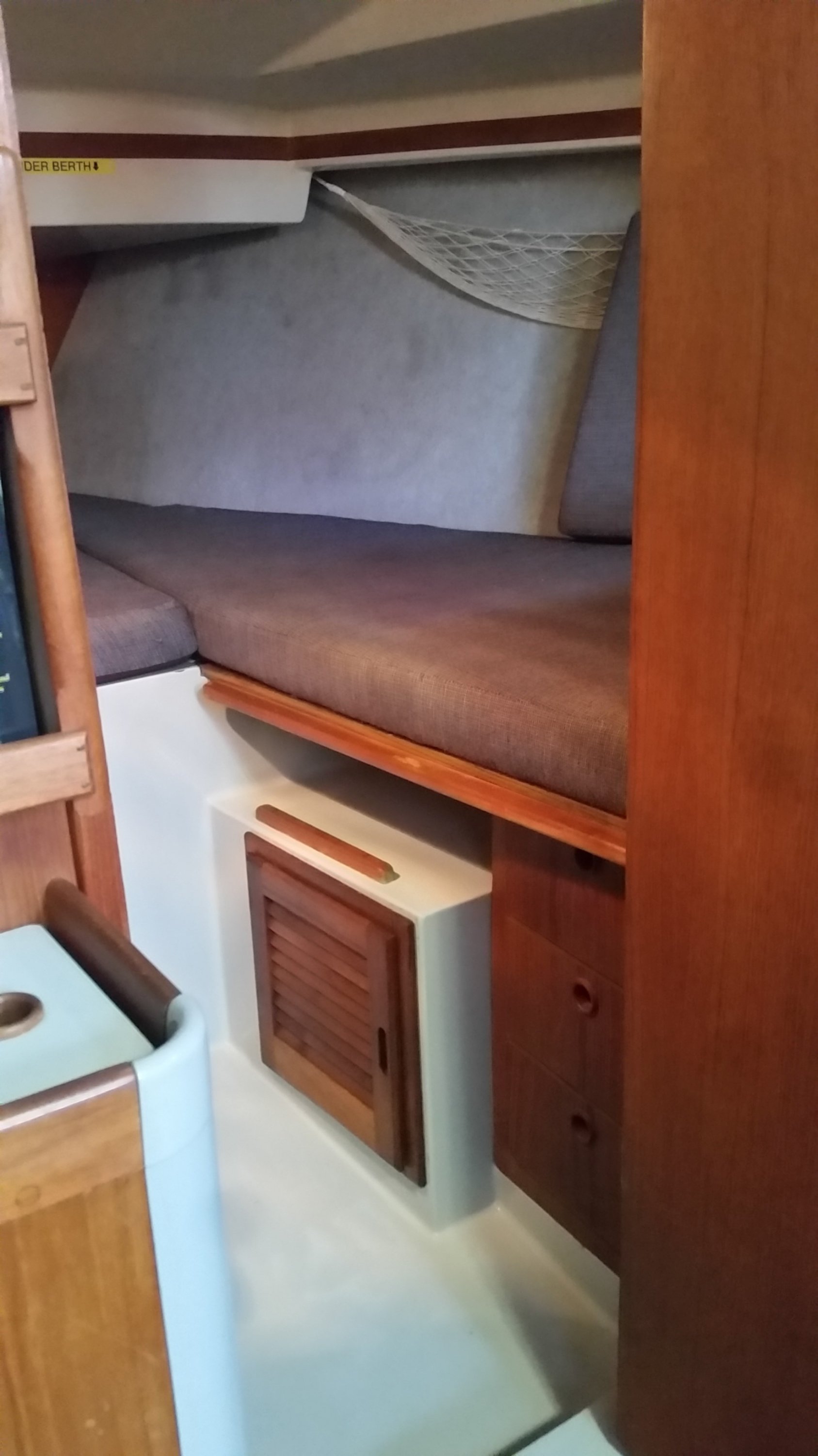

Well, this post was inspirational. I just got my O'day 322 this spring and have been busy with little projects all summer. After seeing this post a few months back, I finally worked up the courage to cut a hole in the panel under the v-berth this week. Sure enough, this revealed a fairly large compartment that O'Day sealed off. Major score! I used a 15" x 15" louvered teak door from Whitecap. Thanks Tally, Gzito, & Tanq! This post needed pictures so here are a couple from my project.
