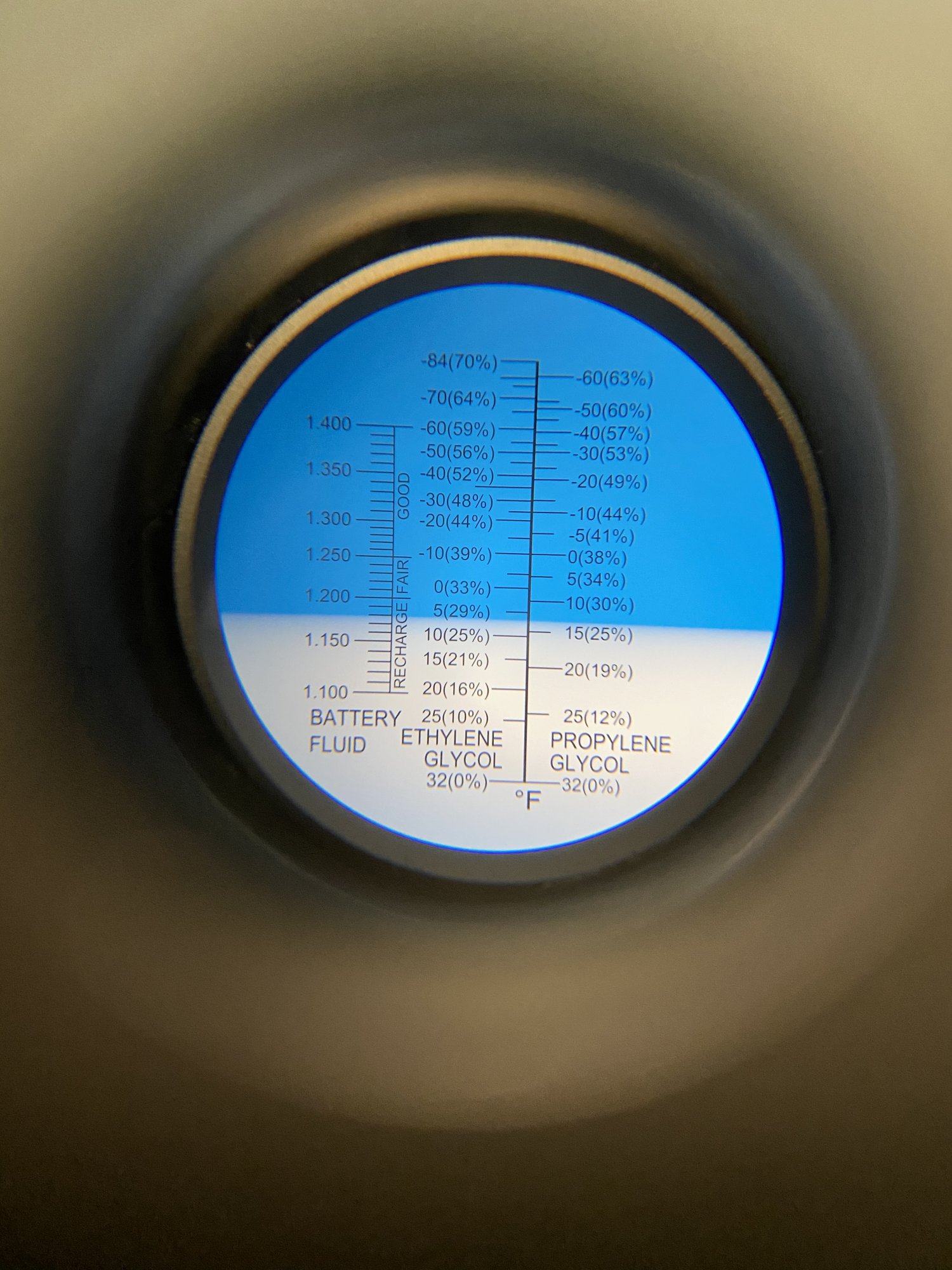

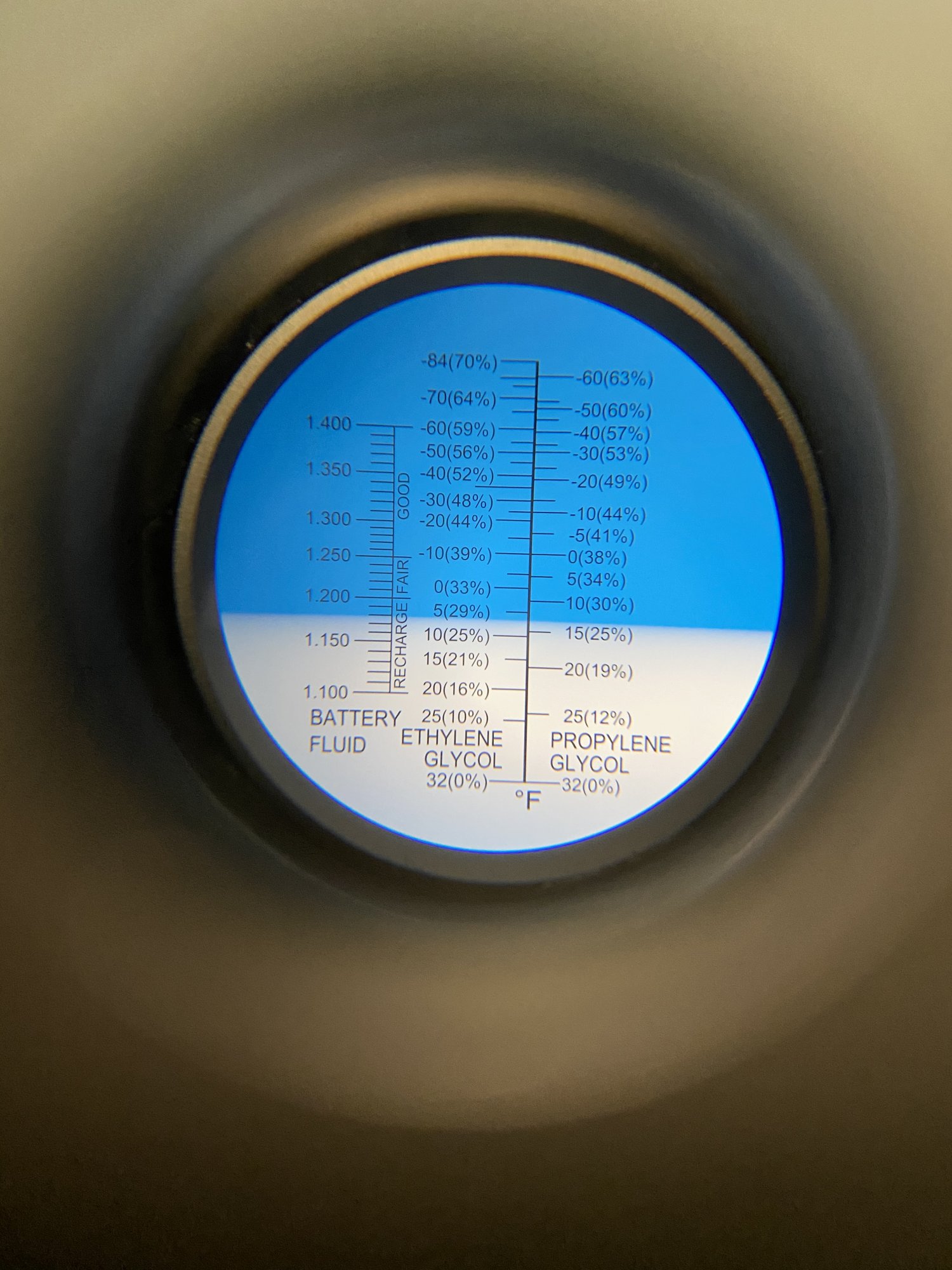

Here’s another data point - I just checked a brand new unopened Starbrite -50 PG bottle. It’s dated from October , after their recalled batch ended. Here’s what I saw -
Closer to 25% than 30%. Freezing point around 13 degrees!?
I checked an old bottle of Camco I had from last year (which may have even been out of my water heater after it was purged, I’m not sure) and it was right on the 30% line. I double checked with distilled water and the calibration was spot on.
I did find on the Starbrite product page that “When testing with a refractometer or with a hydrometer designed for use with PG, freeze point readings on the PG scale will range from +14°F to +18°F.” So I guess mine is in spec.
Yes, that is normal. The spec is typically 26-27%.
to repeat from above:
Many people are confused by this each winter. If you live where temperatures below 10F are common, I suggest stronger AF, since the "burst point" claim is...
1. based on copper pipe. plastic and cast are weaker than that.
2. for a single freeze cycle. If there is repeated freezing in a complex system (engine or water system), the ice floats to the top creating a layer of very weak AF in the cylinder head or other high spots. Your funeral. I've seen heads burst and long vertical pipes burst (at the top).
