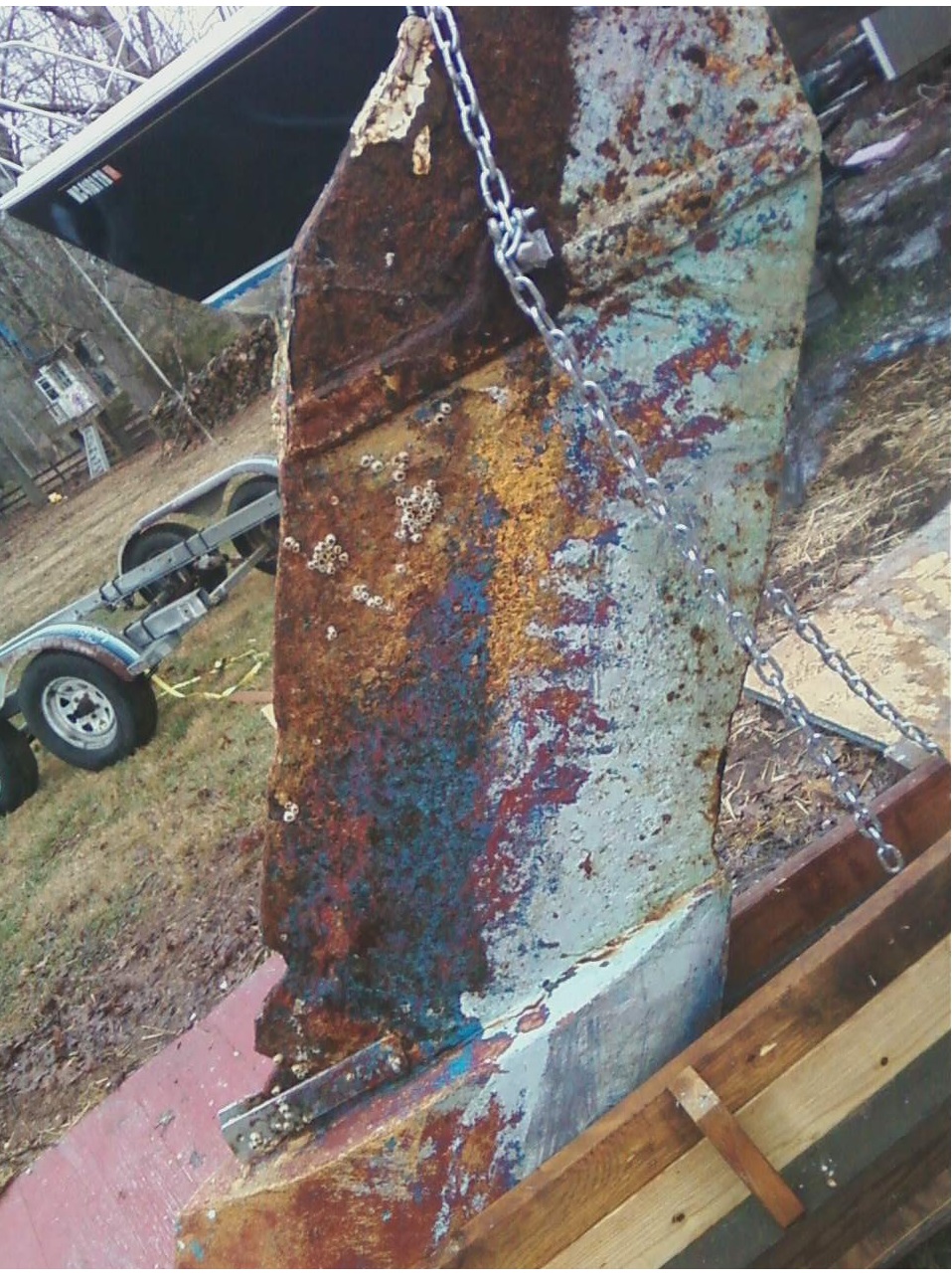

Hello! We've got a new-to-us 1971 Venture 17 and are unsure which direction to go with this keel. Repair it? Get a new one? (I read Blue Water Yachts may still have a few.). Pictures tell more than I can so I'm attaching some. Thoughts? Thanks! ~Kim

I am not sure when if the keel is the same but on my 1970 Venture 21 is made of two pieces of sheet steel that are roughly in the shape of the visible keel. The plates are then encased in fiberglass. The bolt for the winch cable and the pivol are through the plates. So there is no question of it breaking off.
If you are experienced in fiber glassing I would cut the broken area out and re rebuild the that area with fiberglass.

That is not a very badly damaged keel. Take a look at these two pics.... before and after...
I like what @Knuttle suggested. Simply cut away the damaged glass, fill it in with some copped mat and epoxy resin, fair, barrier coat and paint. You are good to go. If you can get the boat lifted off of the trailer and remove the keel. It will be a simple long weekend type job.

That looks like it was previously repaired/rebuilt as the shape is a bit unique. I have a V21 that was cracked due to rust expension on the steel bar at its core. Water leaked in around the pivot bolt... I had to do some major surgery to get it unstuck from the keel pivot well.
Mine is a steel bar enbedded in lead at the bulb end, then glassed/filled to create the shape. I intend to use the old keel core and recast the filler, then glass, fair, coat, etc. I've pieced the the old bits back together and plan to make a 1/2 mold from the shape. Then I'll lay the core in it, fill, shape, glass, fair, sand, seal, and paint/gelcoat. I had no luck finding any keels ready to reinstall (from BWY or elsewhere), so I think the standard path is to repair/remake. Most of the Venture boats seem to have had repaired keels and the various stucture (cast iron to custon welded plate faired to shape) dictated how the rebuild process goes.

Looks like you are well on your way.
It appears the damage was dine while the keel was riding on the trailer support, perhaps due to one side of the cable harness being detached at the bolt? Mine had two pieces of stainless strap loosely attached to that bolt and to a single winch cable.
What does it look like in the cabin around the pivot bolt and lock pin? You are essentially set up to drop the entire keel at this point, if it rotates freely and you can easily access the pivot bolt. I used a 2" ratchet strap around the beam of the hull to hold the top end of the keel when removing the bolt. (It was swollen in the well due to the rusting core and not going to drop, anyway...lots of banging, levering and careful sawing with the reciprocating saw to get it out!) When loosened, I lowered the lead bulb end onto a dolly and then loosened the ratchet to lower the upper end.
How do you plan to build up the cut out section?

I'll be real blunt, as a new-to-sailing sort, that this kind of keel scares me to death. I envision this thing flopping around and halfway breaking off and dragging me to the bottom of the lake, LOL! VenturED, can you tell me more about that cable? I'm going to take some more pics of ours. We just have the one cable and bolt on one side, and a metal rod on the other that sticks down from inside the cockpit. Something about self-bailing and keeping that hole clear.
Here's the keel after some welding and then epoxy and fiberglass.

Looks pretty good to me. Did you clean the rust off before you closed it all up?
I've sailed a lot of different swing keel boats. I've owned two Macgregor V21s and a Mac V22-2, a Balboa 26, a Rhodes 22 and I now own a Hunter 26.
It is not going to fall off. The real danger is the keel winch handle. When dropping the keel, make sure you do not let go of that handle or it will spin around real fast and break a finger. Or invest in a self breaking winch so it won't free fall if you let go.

You will want to fill in the grooves of the cloth with some fairing compound and then seal it up with some epoxy barrier coat and last paint it with a quality enamel paint. I like rustoleum. If you plan to keep it on the trailer, then you do not need to deal with antifouling bottom paint.
Also, a cheaper way to get barrier coat is to go to a pool shop and get the epoxy barrier coat from them. If the word "marine" appears on the can, it will cost 50% more.

Yes, the rust was all cleaned off and some welding was done before the epoxy and fiberglass. I'm sure the fairing compound is next, and thank you so much for the advice re: the epoxy barrier coat and for the reassurance that the keel isn't going to fall off, LOL! Yes, we do plan to keep this on the trailer so no antifouling paint needed but I DO want to repaint the boat itself as it's been painted a few times and there are chips that show the previous two blue colors, and it's now banana yellow. I want it to be red. That may or may not happen. ;) We're in New Orleans and our version of winter is chilly with lots of humidity and rain so if the painting does happen, it's a few months down the road.

You askEd about how the keel attached. In the initial link to my photos, the first one where thw keel is suspended by a chain in prep for angle grinding, you can just make out two stainless straps. I believe there was a short bolt in the upper holes that passed through an eyelett on the end of the which cable. It formed an inverted "V", or "Y" if you included the cable. As I recall, the ends of the straps/bolt/eyelett pulled up into the hole in the hull leading to the cockpit and winch - that seemed to be a tight fit and have potential for damaging the hull. That may get reworked when I get back to finishing the keel and installing it.
Do find some form of padding for the keel on your trailer. Common wisdom is it ought to clear the trailer when loading and launching, but then you lower the keel so it gently rests on the trailer and relieves most of the weight so the hull (at the bunks) and pivot bolt don't take all the 400# load as you jostle down the road.
