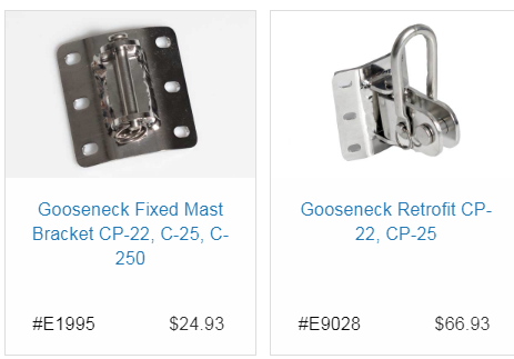

Also, my gooseneck keeps forcing the screw slugs (ordered from Catalina Direct) when I crank on the halyard. With an adjustable gooseneck, it seems difficult to secure the gooseneck in the track with "screw in" fittings that don't eventually work themselves loose. Any suggestions?

Regarding your gooseneck question, if I am understanding your issue, the sliding gooseneck is causing you an issue. On my boat, I drilled and tapped a hole in the base of the groove for the mainsail, and threaded in a button head socket head cap screw to prevent the gooseneck from sliding up. I am using a boom kicker, which needs a fixed gooseneck to work properly, but the newer Mk II Capri's all had fixed goosenecks, and there are retrofit kits available, but I found my solution to work just fine, and a far lower cost.

Someone asked for a picture on this a ways back. Finally got a chance to post one. Simply drill and tap the bottom of the mainsail groove to accept a button head cap screw above and below the location where you want to secure the gooseneck. Simple, and virtually no cost. Here is a picture of the gooseneck on my boat with the mast removed for clarity.

The fixed gooseneck retrofit kit made things so much easier on my '88 Capri 22.
