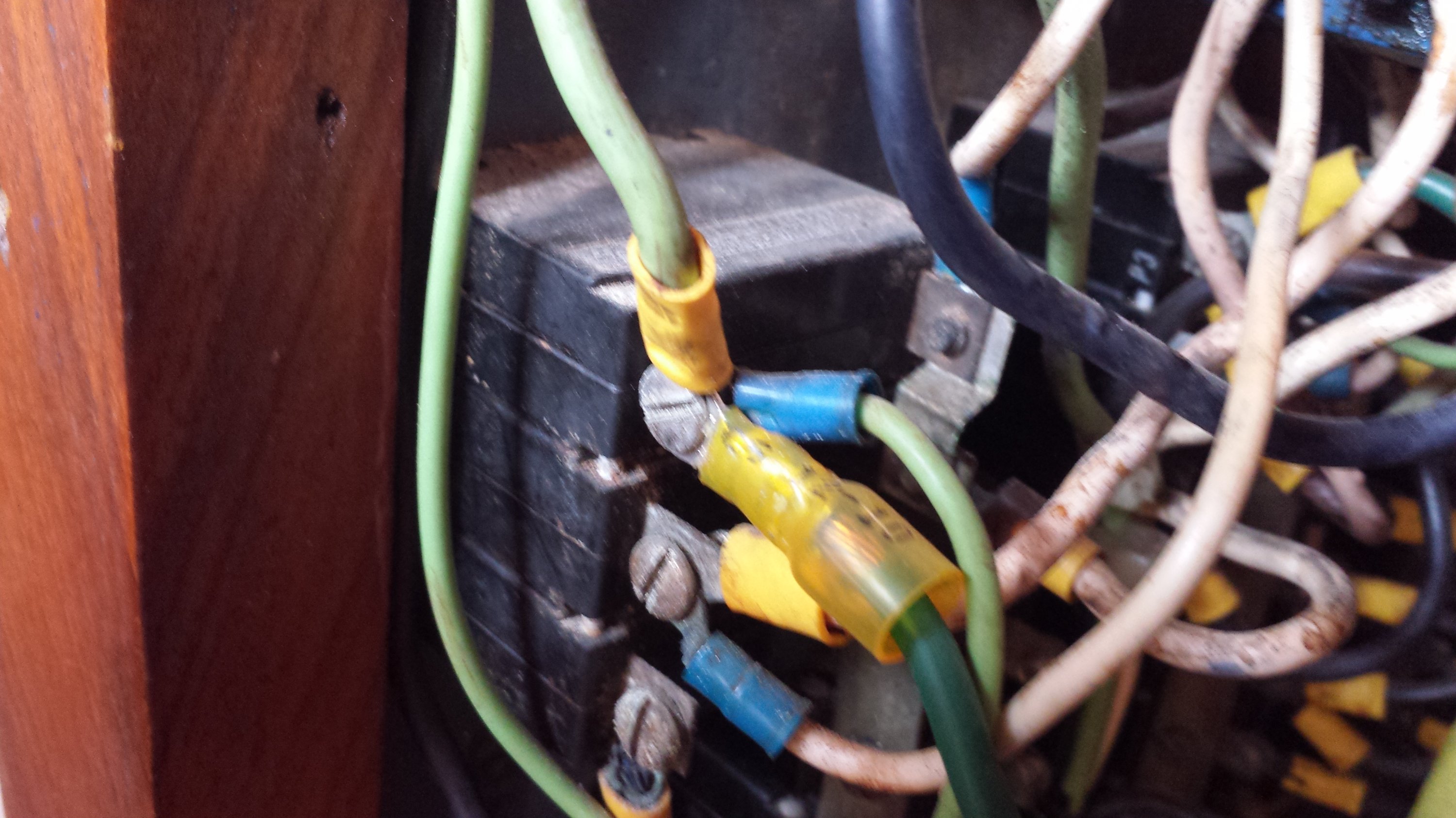

The main breaker on one of my 110v feeds has been tripping. Would like to replace it. It is triple wide with one switch. Dont understand...

Not sure about the "triple breaker" however on boats both the hot (black) and neutral (white) legs should be protected by a double pole breaker. This is different that shore based AC wiring where only the hot leg (black) is connected to the breaker.
If the breaker is tripping it would be good to figure out what is causing the circuit to overload. It could just be a failed breaker, but I'd rest easier if I knew what was causing a breaker to trip on my boat.

What is connected to the breaker? Based on the wire colors the green ground is switched. Ground should not be switched.
What you have is a single toggle double breaker (hot and neutral) with an additional reverse polarity trip coil (green wires). That breaker will trip upon sensing reverse polarity. Paneltronics has those 30A breakers but do be sure it is not a reverse polarity issue before replacing it.

the green wire to the third segment of that breaker is there to keep the breaker active in the case of reverse polarity if you have reverse polarity the third segment locks out the breaker and keeps it that way until the polarity problem is corrected
