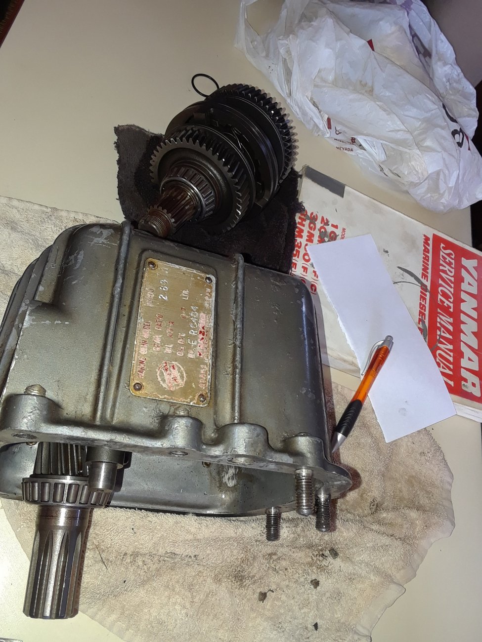

I've got a Kanzaki-Carl Hurth tranny model KBW10E on my Yanmar 3HM35F with what appears to be worn clutch discs. Reverse is fine, but very little shaft rotation in forward gear.
A search for the clutch friction discs (part # 177090-03080, 8 needed) shows they're made of almost pure unobtainium, the steel discs (6) not so much. Yanmar discontinued the model in 2016, but there should be parts out there!
Is there a tractor company out there which uses the same transmission or clutch ass'y such as John Deere?
