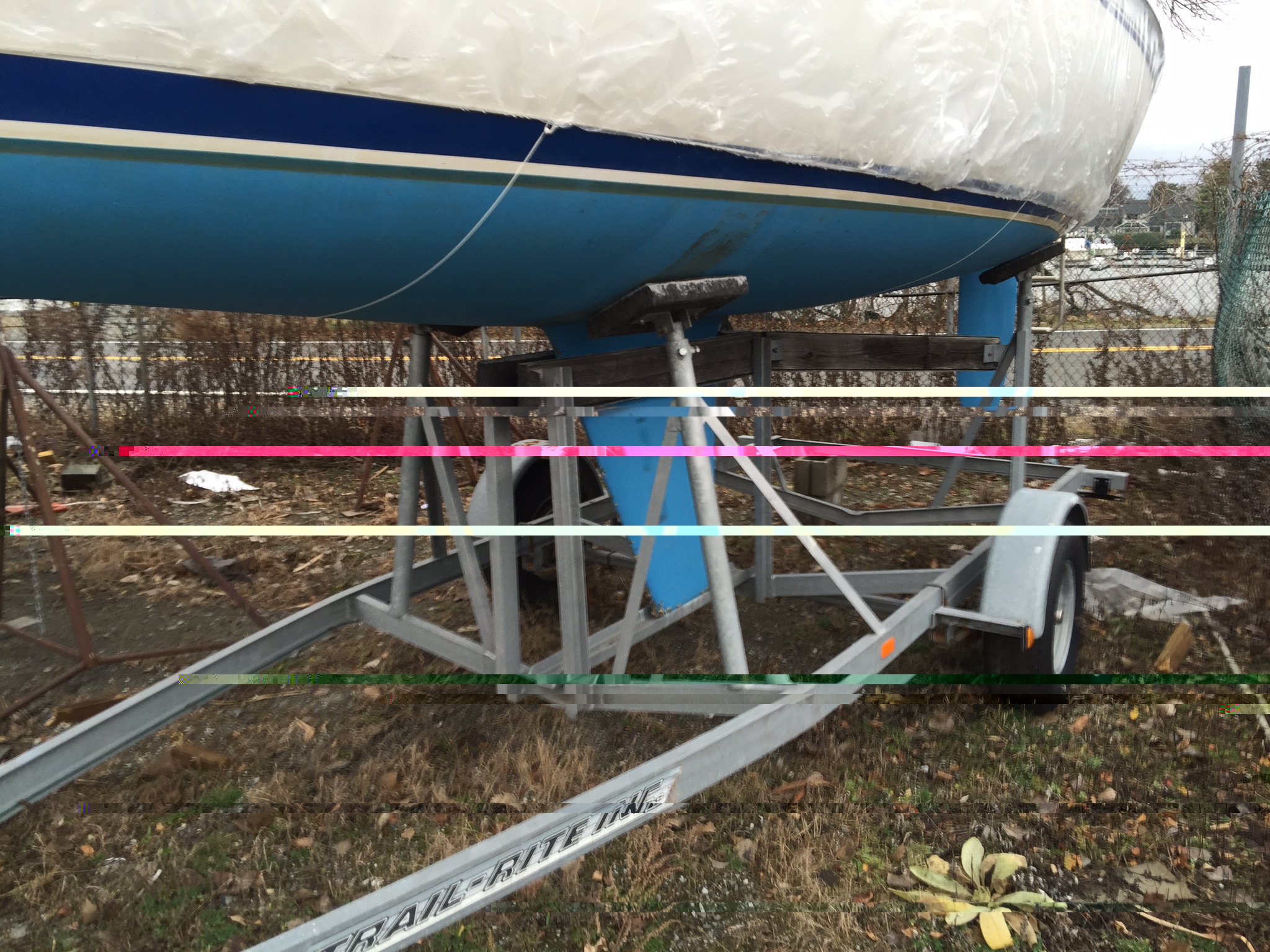

I have a wing keel standard rig which I tow to my club ( 12 miles) in the spring, then take her home in mid October.
I am seriously considering cutting sections of the bunks out, to make it more like a pad. Because of the bunks, painting a large section of my my bottom is difficult. To be honest, not painted in a long long time.
What do you guys think? There are many boats around 22 ft. which are only held up with 4 stands
If, someday I sell her, the next owner could always convert back to bunks.

Depends on the size of the pad and where it sits on the boat... having the elongated bunks as you know spreads the load... But if you did it with say a 24 inch long pad that would work... As to ensuring you could paint underneath, it would be great if the trailer had the threaded pads that you find on jack stands... that would allow you to trailer it all the way down and when working on it raise all but one up at a time and put a stand under that spot... Just a thought

I have a fin keel and have pads on my trailer.
Most to the weight should rest on the keel.
Main thing to watch for is making sure hull does not deflect in when on trailer.
If It is does your pads need adjustment or you need to raise keel support just a little.
My pads are approx. 10 x 6 inches and can rotate to fit curve shape of hull.
488
Catalina Capri 22 281 Winthrop MA
I use four Brownell SB-4 tops inserted into 16" x 2" galvanized pipe bolted onto the cross members. This allows my to easily adjust the supports to let me paint the entire area. The trailer was modified from a trailer with rollers (came with my O'Day 19) but modified to have the Capri 22 on it. It is a little "short" since the back of the trailer is about where the genoa winches are mounted. Officially I should mount a temporary set of lights on the transom while trailering.
To better distribute the weight, I use a 6" x 1" pressure treated board (real wood porch flooring). This board flexes and distributes the pressure on the hull reducing the concentrated pressure points.
To get to the bottom of the wing keel, I raise the side supports (yes, I do cheat and use my tractor loader bucket to lift the stern) and suspend the boat while I remove the primary keel resting area. Since this is a short period of time and in a controlled area, it is safe for both the boat and me. I do add additional supports when the keel is not resting on its landing area.
