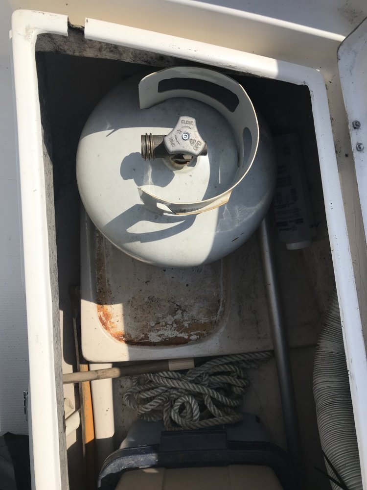

I have my tank in the port lazzerette and it just fit , even sitting in a milk crate.

I love mine ! I was hesitant to spend the xtra $ but with gas issues I'm glad I did . Initial starting takes a few more pulls than a gas model which I imagine is purging air and filling the line since I turn off the tank and run it out at the end of a sail . Once it has run though it is one pull from then on. The motor is mostly the same with the exception of a regulator , throttle body , and head . The parts are Walbro and I figure they should be trouble free unlike fuel pump and carb immersed in gasoline additives all the time.

It has the cowl vents only inches away from the tank . I also have checked for leaks with soapy water once in awhile just for afety sake . I used to get gasoline fumes all through the boat with the old tank in there so I no longer have that to deal with as well.

Cowl vents won't help, propane is heavier than air, goes down.

You need to take care whether it's propane gas, or the fumes (gas) from a gasoline engine. Both flow and sink, both explode!
My propane tank sits on the cockpit floor next to the transom. If there were a leak, it should vent to the atmosphere and or flow out of the rear scuppers. When I shut down my motor, I do it by closing the tank valve till the engine starves itself and quits running. No fuel left in the motor or the supply lines. When not sailing, I store the propane tank(s) at home, just like a spare gas grill tank. If and when I run out of fuel while motoring in the boat, I don't have to lean over a hot, bouncing engine, trying to fill an integral fuel tank, spilling liquid gas over a hot engine in the process. It's all a matter of identifying, mitigating and managing the risks inherent in any fuel. Then deciding whether you wish to accept those risks. A diesel powered outboard would probably be safer overall, but diesels have their own issues. I fly (and work on) airplanes for a living. Most of the job involves managing risk, so I tend to think that way. I like some of the advantages of propane, and I think I am managing the propane risks fairly well, but am always open to further suggestions.... :)

Well, don’t puff your chest up about managing risk on airplanes. I spent 37yrs designing BIG airplanes. We did not “manage risks”. We had regulations defined in the Code of Federal Regulations (CFR) that had to be met. It was not managing risks. If we did not meet the CFRs, and had an incident, lawsuits would occur and be lost. ABYC has “requirements” concerning propane. Not sure if they could be called regulations, but, if you had an incident with people aboard, you could be open to liability and your insurance could say Hasta la Vista!! BTW, your “plan” of propane in the cockpit doesnt take into account wind direction... My recommendation is meet the ABYC requirement that insurance requires..If you don’t have insurance and have passengers (friends), you are wide open...Then again, if you are dead, I guess it doesn’t matter..
