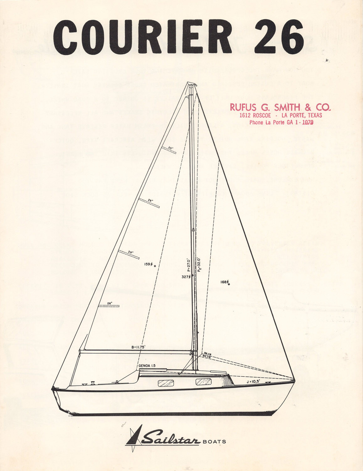

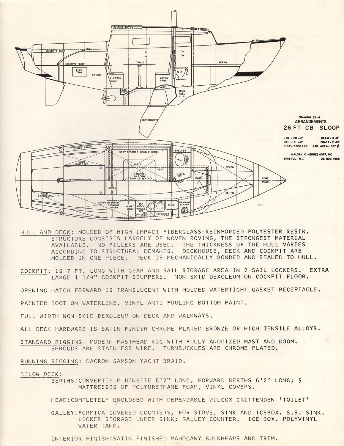

Many hearty thanks Jack'
The vessel pictured is a centerboard version ( whilst mine is a fixed keel ) but otherwise I believe it is damn near the same.!
I really value someone going to the effort to look that up from my description and I reckon you've hit the bugger on the very nose here Jack! Thanks so much.
