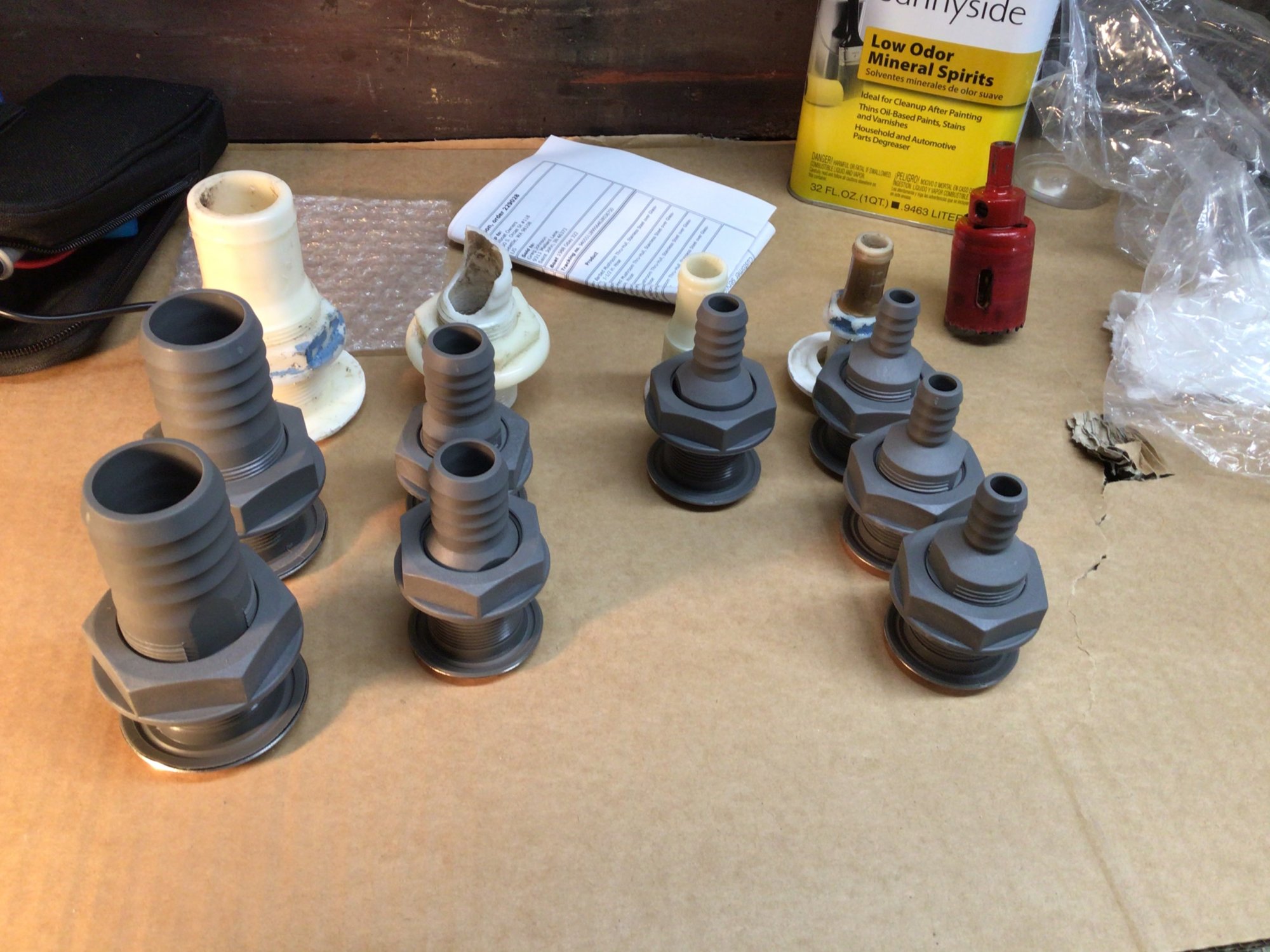

I replaced 8 thru-hulls on my 1988 O’Day 322 over the winter. I had 4 different sizes of thru hulls for cockpit scupper drains, propane locker drains, lavatory sink drain, and bilge pump drains.
Unfortunately, it seems that the manufacturers have changed some of the dimensions over the years, so a thru hull for a 1” ID hose has a different size “body” and required that I drill out the hole a big bigger. In fact, I think the 3 smallest sizes all had the same “body size”. And the largest thru-hull had a body that was smaller diameter than the one I was replacing…
So, my recommendation is to remove the hose and measure the hose connection (hose ID) and the body OD (which indicates the size of the hole in the boat) and see if you can find an approximate match.
I bought mine here on SBO. But be aware that the body OD dimension is not given in the specs…I called to try and verify….unfortunately I was not given the correct info and had to enlarge the holes in the boat for 2 of the 3 sizes I was trying to match. Turned out not to be too difficult, but an extra step I was trying to avoid by buying the right size.

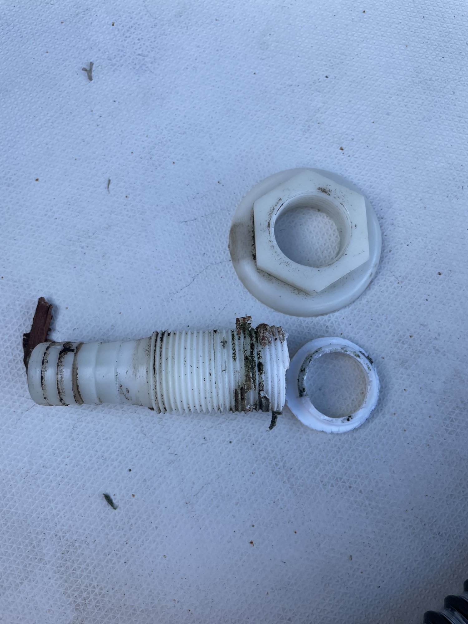

It was a 3/4 hose barb thru hull. There’s only one size WM sells in the marelon and it fit perfect. The threads OD were 1”. I used 4200 to bed seal the new one.
this is the drain for the steering quadrant. The old thru hull was nylon and cracked. It was also pretty loose when we removed it. It cracked off pretty easily too.

It is a good idea to check all of the other similar thru hulls. They get brittle with age and are prone to crack as you noted.
