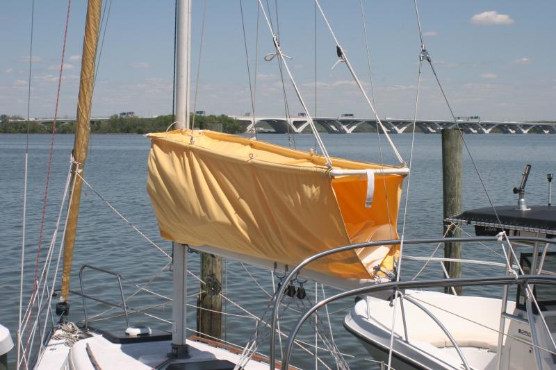

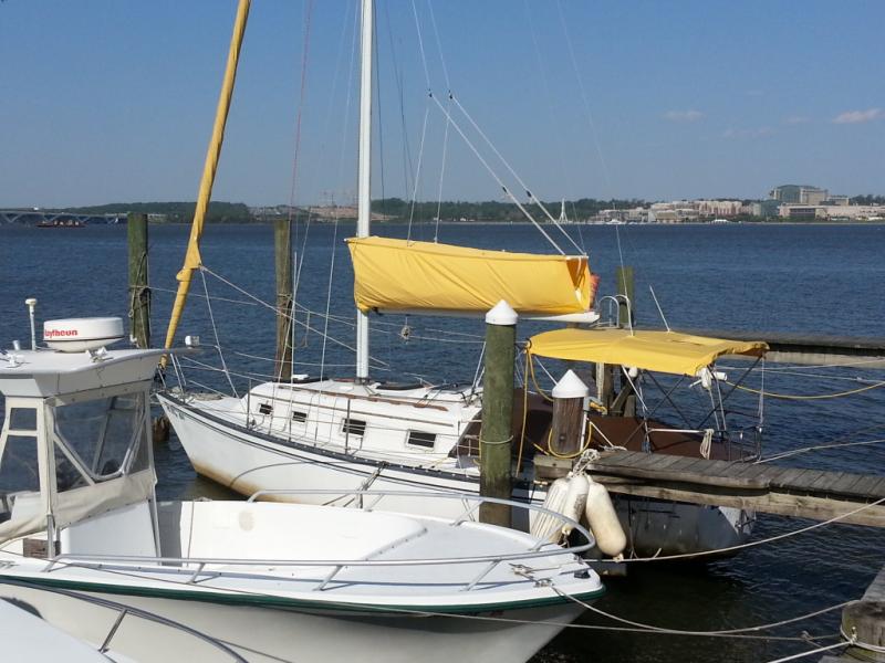

I have a Salirite LZ-1 and built my sailpack, bimini and some other smaller projects. Went to a loose-footed main from Bacon Sails this spring.
I like the convenience of not having all the sail cloth crowding the deck when you lower the main. The lazyjacks take a little to get used to get the battens up past them, but they hold the sail nicely when you take it down.
Gary at Bacon Sails said the shock cords that are suggested to hold the lazyjacks open are a trade-off. I got crazy and built a frame from PVC pipe, this is the first season for it, so I can't say if it was a good idea or not, but it does hold it open.

... The lazyjacks take a little to get used to get the battens up past them, ... but it does hold it open.... Dan
Maybe move the upper end of the lazy jacks farther out to clear the battens?
Feb 8, 2014
1,300
Columbia 36 Muskegon
Right. First year I had the top blocks on the mast and the battens would get stuck. Moved them to about six inches out the spreaders and it was much better.
