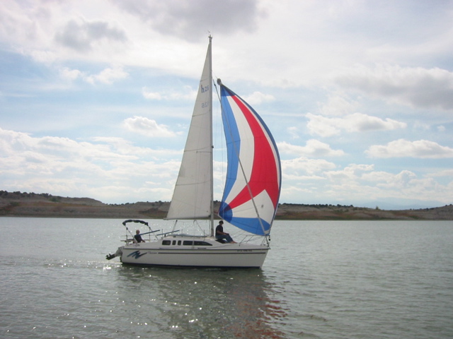

I found a photo that might help. If I understand you correctly you were/are thinking you could have your headsail unfurled AND fly the asym at the same time. I’ve seen that done but it’s asking a lot when you are trying to sort things out. Most everyone that I know rolls up the headsail so it’s out of the equation. I’ve been where you are, thinking it’s going to be fun and then wrestling with a flapping monster that has a mind of its own. If you have a halyard that’s above the forestay don’t give up flying as it’s truly rewarding and a lot of fun. Even if your mast doesn’t have the correct halyard in place you could drop the main and use it’s halyard. Just pick a day with a light steady breeze and experiment.
Here’s the photo, notice the asym and all of its controls are OUT?SIDE of anything else
