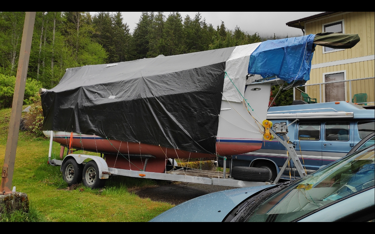

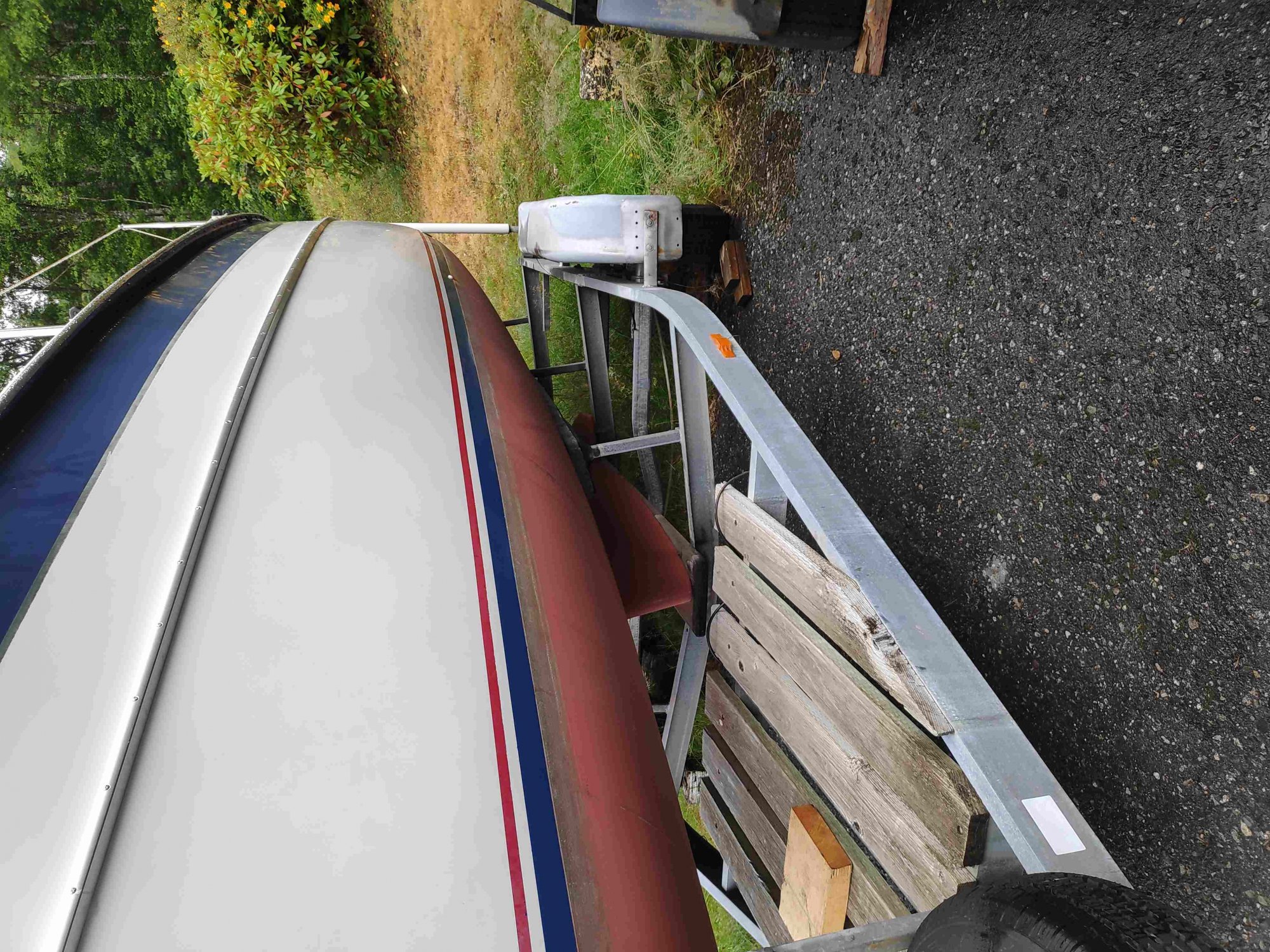

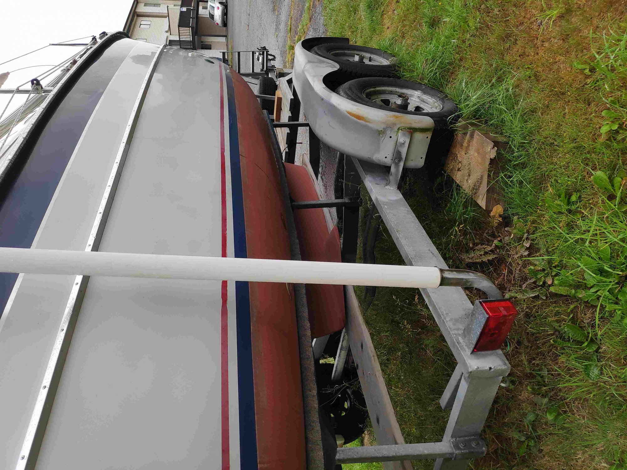

Any Seaward owner with an original trailer? Although the 2000 boat I am buying seems in good shape, the trailer looks as if it will need work. It also looks very minimalist for launching and especially for retrieving. Anyone with an opinion on this? I don't know why the pictures have come out sideways.

Seaward 25 looks a really nice trailerable sailboat. Cannot tell from the photos (even after rotating them sideways) what work the trailer will need. Any work could be done by yourself and/or a trailer shop. Some items to look at:
Does the trailer have adequate hull supports like the ones in the photos in the link below from Triad Trailers, who manufacture Seaward 25 trailers? That would be the first thing I would look at.
Does the trailer frame have excessive corrosion that needs repair?
Do the surge or electric brakes work?
Do the fenders need body work?
Does the frame require regalvanizing?
Are there adequate hold down strap attachments?
Is the hitch functioning and are does it have safety chains?
Are the running lights working?

From your photos looks like you have wheel "buddy" bearings that make bearing lubrication fast and easy. They were good to have!!
Recommend topping off wheel bearing lubrication with waterproof grease before your long trip or removing / repacking wheel bearing if you are unsure about the grease and bearing condition before your big trip.

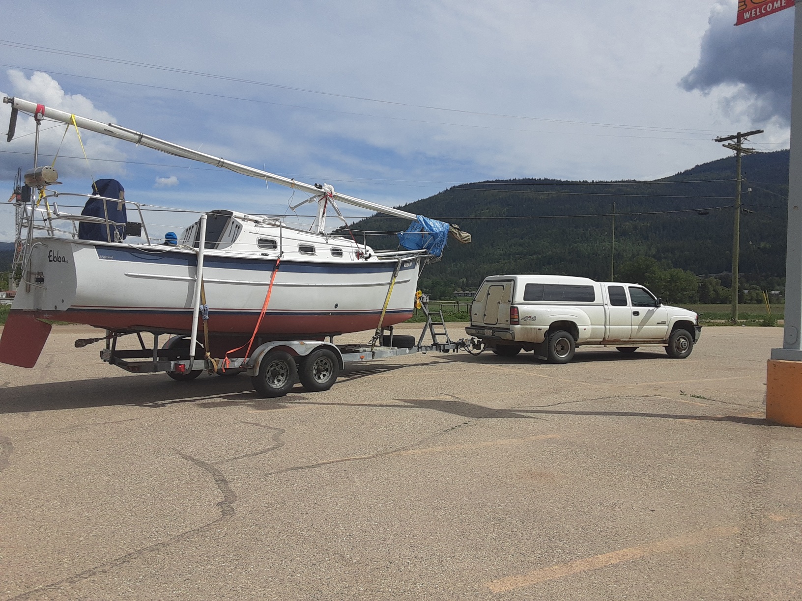

Yes, it has both. I just got an updated picture, just 3 hours old.

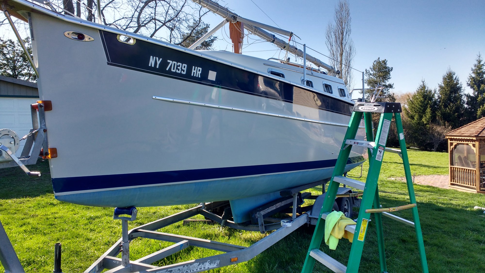

It looks they changed manufacturers of the trailer since my Performance trailer was used on our 1996 Seaward 25 was made. The only thing I don't see on yours is the side bunks for the keel that are on ours. Their purpose was to help center the keel on the single bunk it rests on and keep it from sliding sideways on it. In reality, they could be a pain when retrieving the boat as it is possible to float the boat over them and have it come down on top of them when you pull it out, if not careful. I'll attach a pic of our Performance trailer below. You can see them if you in this pic.
The wood pieces on the front of your trailer are likely something added by a previous owner, maybe to transport a dinghy or kayak?
On our trailer, I added Surfix bunk slides. They made launching and retrieval much easier. Make sure you add a heavy ratchet strap over the back of the boat and onto the trailer before towing it. It is also a good idea to do the same thing on the bow. You can run it through the chocks.

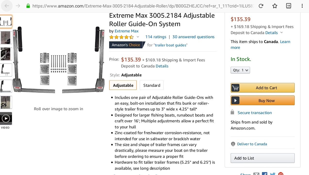

Wide straps I have, bunk slides are on the shopping list. I shall probably get a set of these.
They are very heavy duty and made a world of difference to recovering our O'Day. They are on their smallest setting on the O'Day, so should be fine for the Seaward. Properly adjusted, the boat keel has nowhere to go but right down the midline. Notice what we poor Canadians have to pay in shipping!
