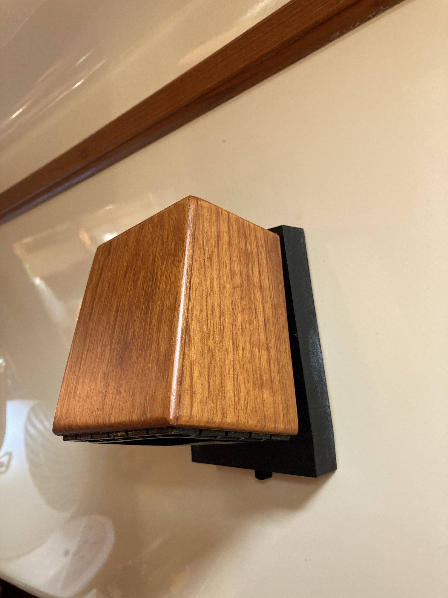

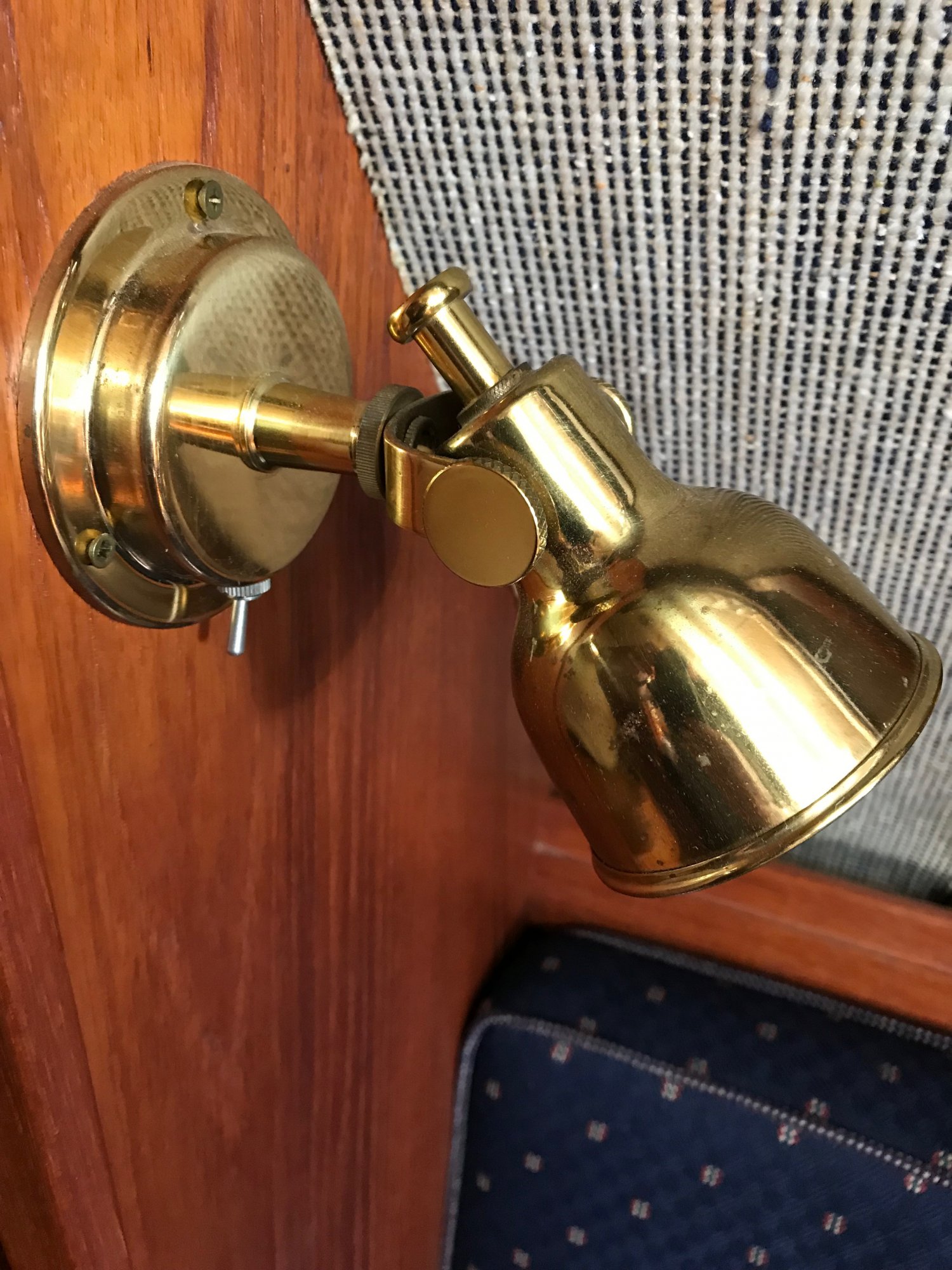

On my new-to-me 11.0A I have 8 of the lights pictured below and then just 1 of the "plastic woodgrain" lights I see on other 11.0s on Yachtworld. I am wondering if a previous owner replaced the plastic lights (see second pic) with the brass ones.

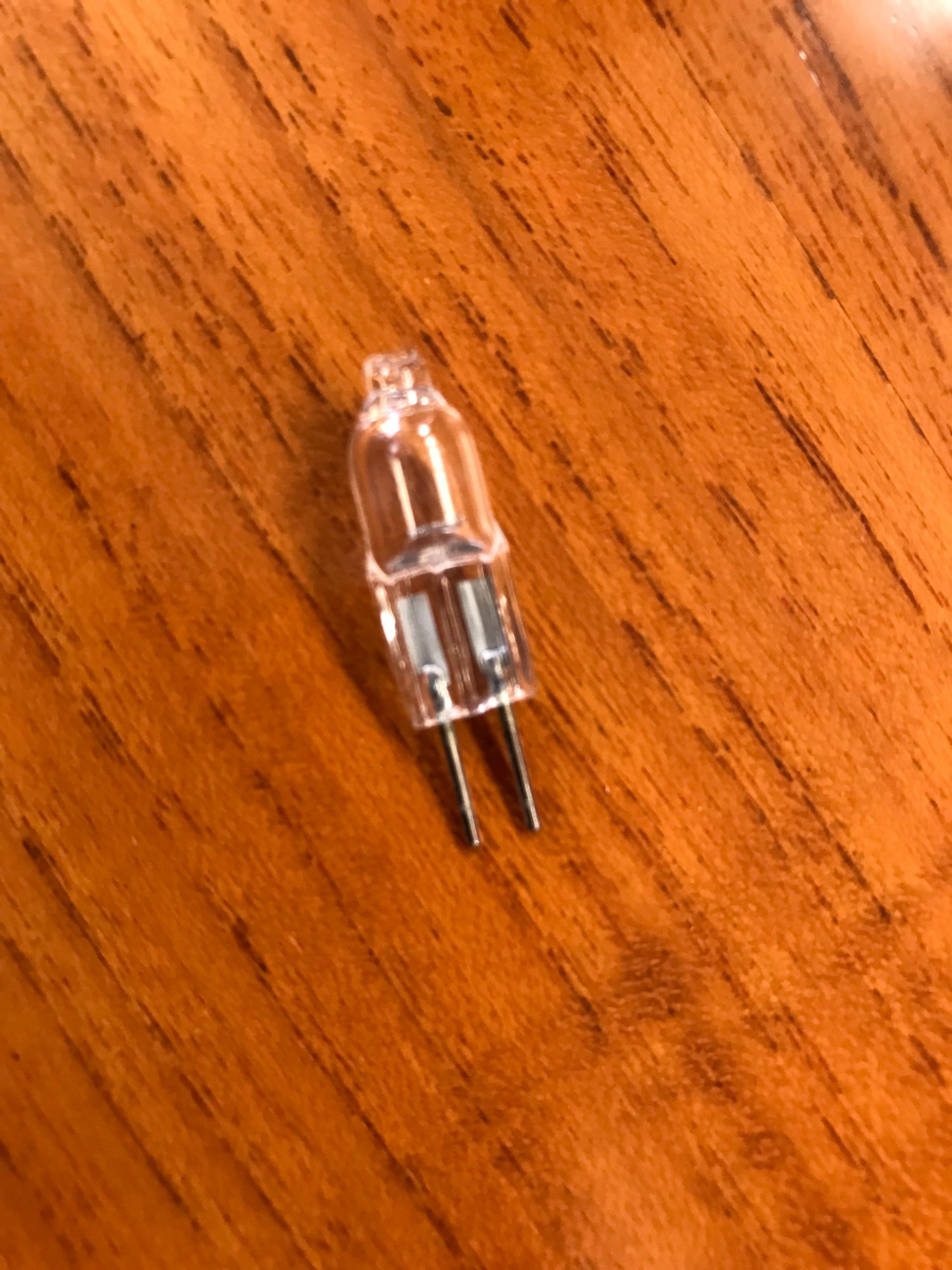

My real goal is to find LED bulbs for the 8 brass fixtures but it is difficult to determine the proper bulb to use to replace them.

My lights (x8):

The bulb in the brass fixtures that I want to change to LED:

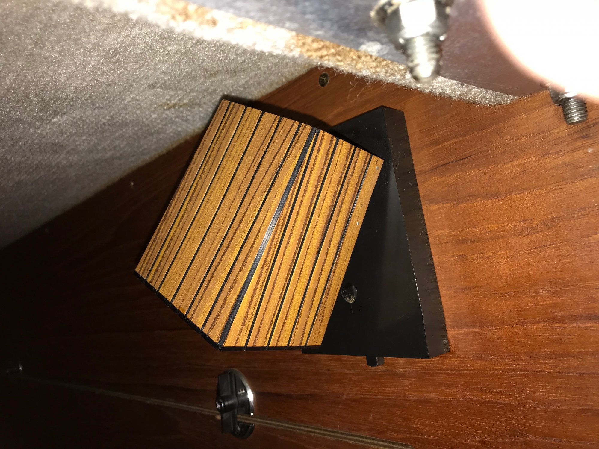

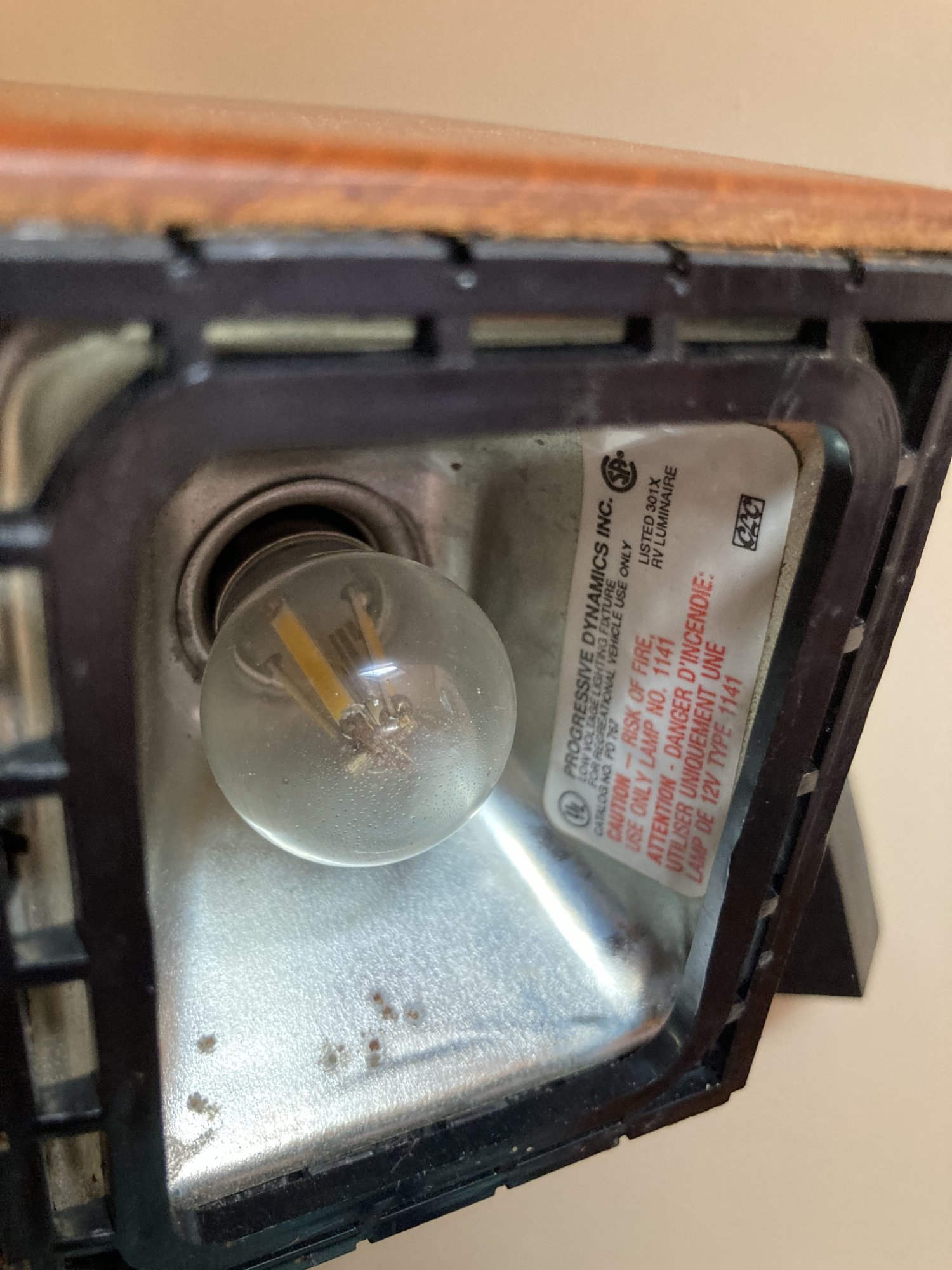

The plastic fixture is from the factory, I have 3 of the same on my S2 7.3. For those I cross referenced the LED replacement for the bulb that was in the fixtures.

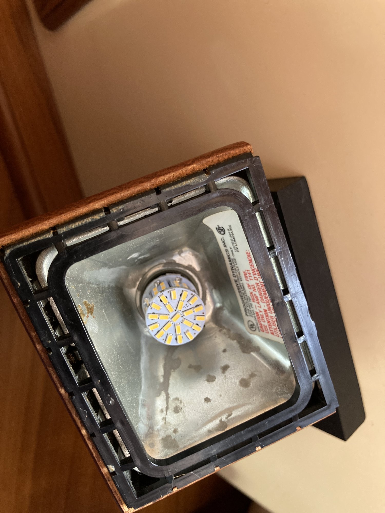

The first bulb had failures in lest than one year they second has not failed in the first sailing season. I am not selling bulbs. Check online sellers. The price is very low compared to retail prices. Compare color 6000k white to 2700k warm white similar to older auto bulbs. Have 18 light fixtures and reduced current from 27 amps to 3 amps. To make cheap plastic look expensive Island Packet covered the lights is thin teak.
