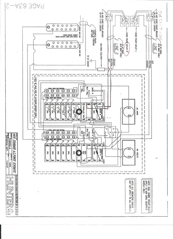

I tried to run my air conditioner off my portable inverter generator the other day. The bus breaker tripped even with the air conditioner off, which doesn't make sense as it is bigger than the air conditioner breaker and way more capacity than the generator itself.
Now the reverse polarity light is on when I use the generator, and I understand this to be normal. But maybe it is part of the problem even though I've used the generator on the other bus with no problem.

kloudie1;1233748 Don said:
Yes, and I have run the generator on that Bus to power the battery charger, the hot water heater, and an electric heater in the past (not all at once) and the Bus A breaker didn't trip.

Don
If I understand you, if all breakers on the 120v side are off and you plug the Honda into the outside connection everything is alright. You then turn on the main 120v bus breaker, leaving all other breakers on that side off, and it trips? If thats the case I would look at the bus breaker as the culprit.
No that's not right. I can shut the main 120V Bus B breaker and it fine. But if I shut the Air Conditioner breaker (the unit is off and I've done is provide power to it) the Bus B breaker trips. The Air conditioner breaker doesn't trip and the generator doesn't trip on high amps.
I don't understand why the main Bus B breaker cares that I shut a smaller branch breaker.

I've looked at the Bus B breaker (I took it out) and the electrical diagram for hours now to understand it. Near as I can tell the trip part of the trip breaker trips at 65VAC.
What I don't see is what difference it should make shutting the Air Conditioning breaker. Other than current (the air conditioning or the internal generator breakers are smaller) I don't see how it would have any effect on the Bus B main breaker.

Ya might have a ground fault in the AC or its controls. You can sorta check with a good ohmmeter.. measure hot side to neutral No power and breakers open..and you should see the resistance of the transformers coils etc.. might be very low, like 8-10..so use a low scale on the meter.. Then measure between the black (hot side) and the green wire.. with the breakers all open.. that should be an open on a high scale on the meter.. Make sure the boat charger/inverter is off and isolated.
I am not nearly an expert on that stuff, but I'd look there to start.
