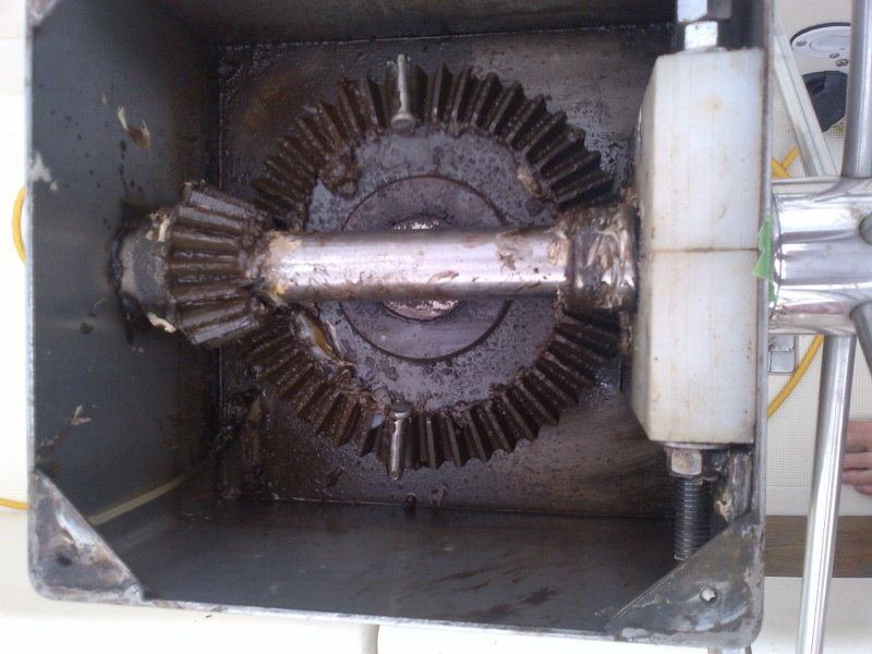

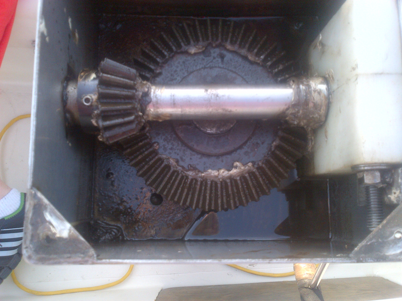

Thanks Woody, my boat does not appear to have any stoppers. The rudder according to my survey is aided by a rack and pignion gear system and the rod to the rudder runs through a fiberglass tube with no access close to the rudder. when I indicated that the rudder swings 360 it was a bit of an exaggeration but it can swing back 90 degrees on its own and with the wheel I can turn it a complete 360 which does not appear right. here are a couple of pictures , one of the gear mechanism and one top view of the gears from the wheel if this helps anyone to point me in the right direction.

are you saying that the wheel turns 360 or the rudder if... its the wheel that is probably ok and it may even turn more than that ...is the boat out of the water if so have some one turn the wheel while you watch the rudder and see what the rudder is doing it should go about 35 degrees of center each side of straight forward or maybe a little more and stop check that first and see what you find out .....

Figure out where the stops need to go then perhaps drill a couple of holes on the large gear for stops, which could be pins, bolts, etc...but perhaps with a sacrificial cover like rubber hose to save the other gear from harm. You could also. Try cleaning the areas and gluing stops with JB Weld. Maybe just make them entirely from JB Weld?

Correction. Looking at the photos there is a ton of flat area to mount a stop. Just JB Welda couple of hardwood blocks so they hit the side of the horizontal shaft or drill a couple of holes as I said. Depends how tough it is the drill...probably very tough I would guess.

Thanks Woody, both the wheel and rudder can turn 360 which leads me to think I really need to install some stoppers which looks doable.
Thanks Bob, good advice. I will give it a try. Glueing looks like a good option.

don't know if yours is Edson system or not but go here http://www.edsonmarine.com/support/PDFs/installation/EB405CDiManual.PDF
and on page 8 there is a part in the diagram # 11 i think it is called a rudder stop ring ...you may want to see if you have one or not and go from there ...not sure that gluing some thing will hold up as the ring gear and pinion are very strong mechanically and could just disappoint you at the worst possible time ......

Hello, I was unable to determine the model of the wheel. I discussed with my local sailing store who suggested, I try the following as stoppers. I inserted two stainless steel clevis pins and glued with exposure glue as stoppers. I tried over the week-end in some pretty strong winds and it held up quite well. when I take out of the water at the end of the season, I will look at having some blocks welded.
See attached picture.
