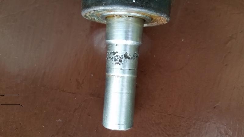

Engine is a Yanmar 2gm20f, marinized in Japan. I believe the pump is an Oberdorfer, but can't find any markings except C-388. The cover plate for the pump is stainless steel and the bolts take a socket instead of screwdriver. The water drips from the weep holes. I took the pump apart and found crevice corrosion on the ss shaft where the water seal was located. The rebuild kit does not include the pump shaft. So I'm thinking: New pump.
