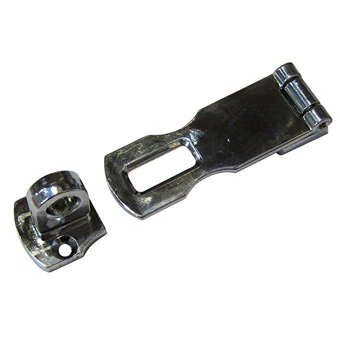

Has anyone replaced the Perko swivel hasps on their cockpit / anchor lockers? The standard Perko chrome plated zinc replacement are flat, and those on most lockers have been bent or curved to fit. It is easy to see the fractures in the chrome plating due to the bending, thus the premature corrosion.
I can replace with same (Perko1194DP0CHR), bend, and expect same life. OR Is their a better form fit function choice that anyone has found to fit? Same screw holes?
Ours don’t have any corrosion issues 18 years later, but I’ve whacked my shins on those plenty of times. Wouldn’t mind a better solution.
I went through this last year and just did some trial and error with bending them...worked so far.
