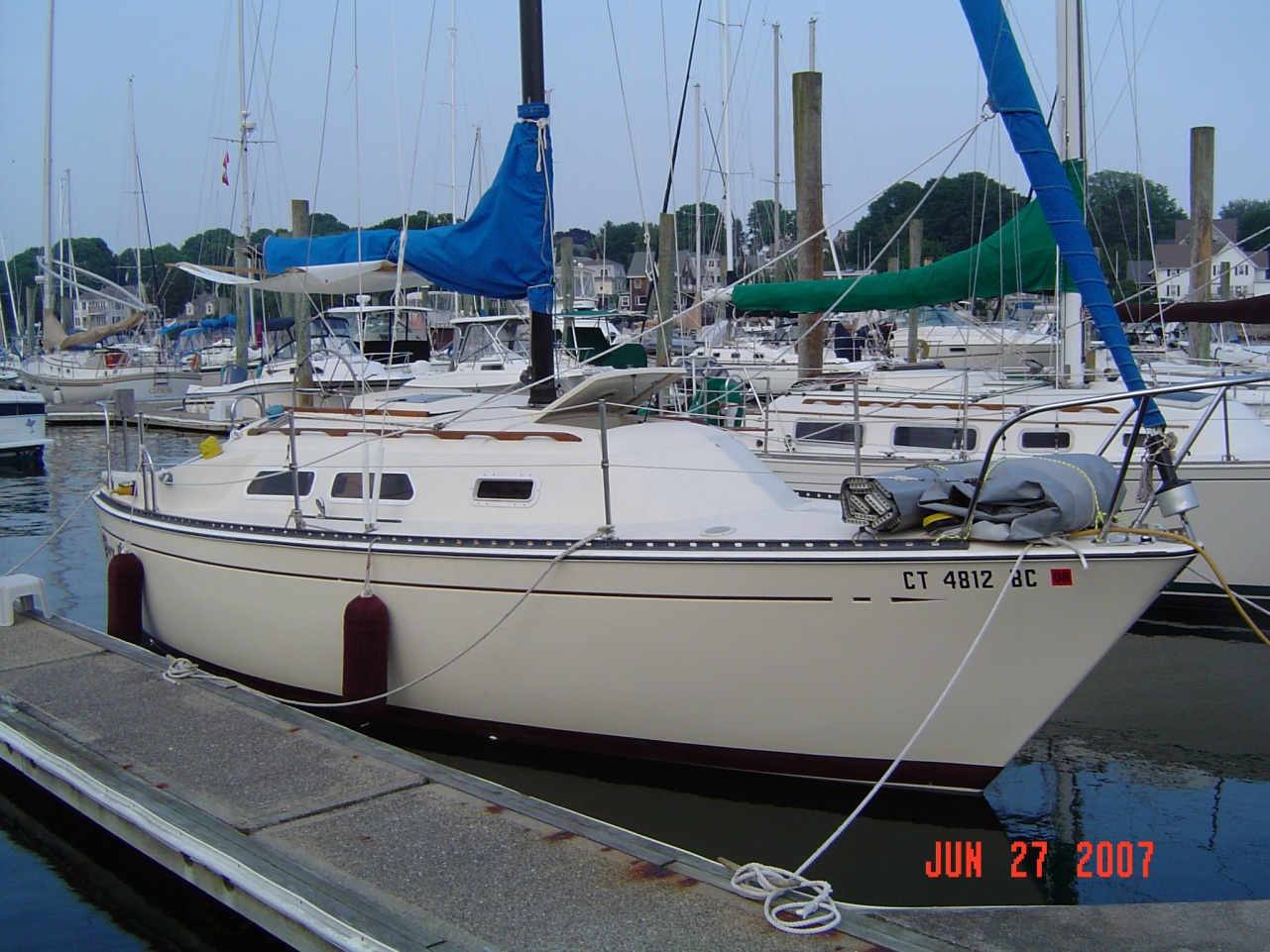

What anchor and weight do you have and do you have a rail anchor mount, anchor locker, anchor bow roller and any budget constraints? Would you consider stowing an anchor with chain and rode in a small bag at the bow like in the photo below?

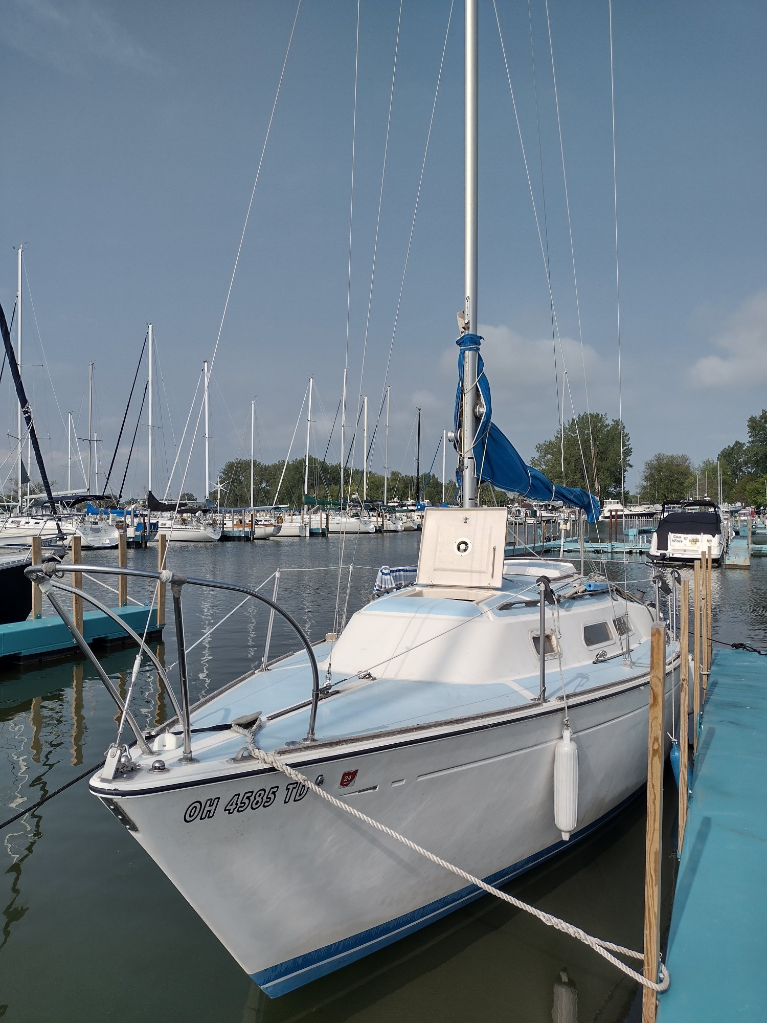

"... you'll have to offer up a complete pictorial tour of your anchor locker and bow."
This is the best shot I have of the bow ... the PY26 as built was devoid of all of the above. ;) I'm starting from scratch. Thanks!

The PY26 was produced w/o any anchor-related accoutrements, as this photo of my bow shows. I'm willing to try *anything*, but I am hoping to find a way to mount the anchor & related hardware such that the only labor involved in dropping or stowing the anchor is operating a manual or mechanical crank. ;)

Looking at your bow, you will have an issue locating the bow roller due to the nav lights located on the bow.
You can move the bow Nav lights and create some space. You need about a 4Inch wide space to the side of your bow fore stay. But I would lean towards a manual system and store the anchor on the pulpit.
It looks like you could locate a small electric windlass. Or a small manual windlass on the bow.
Living in Ohio with the boat sailed on the lake following good weather seamanship, I would think you could use a properly sized fortress anchor, 20 ft of chain with 7/16's 3 ply as an anchoring system under most conditions. I would stay in harbor when the storms of November come blowing down from the North.
