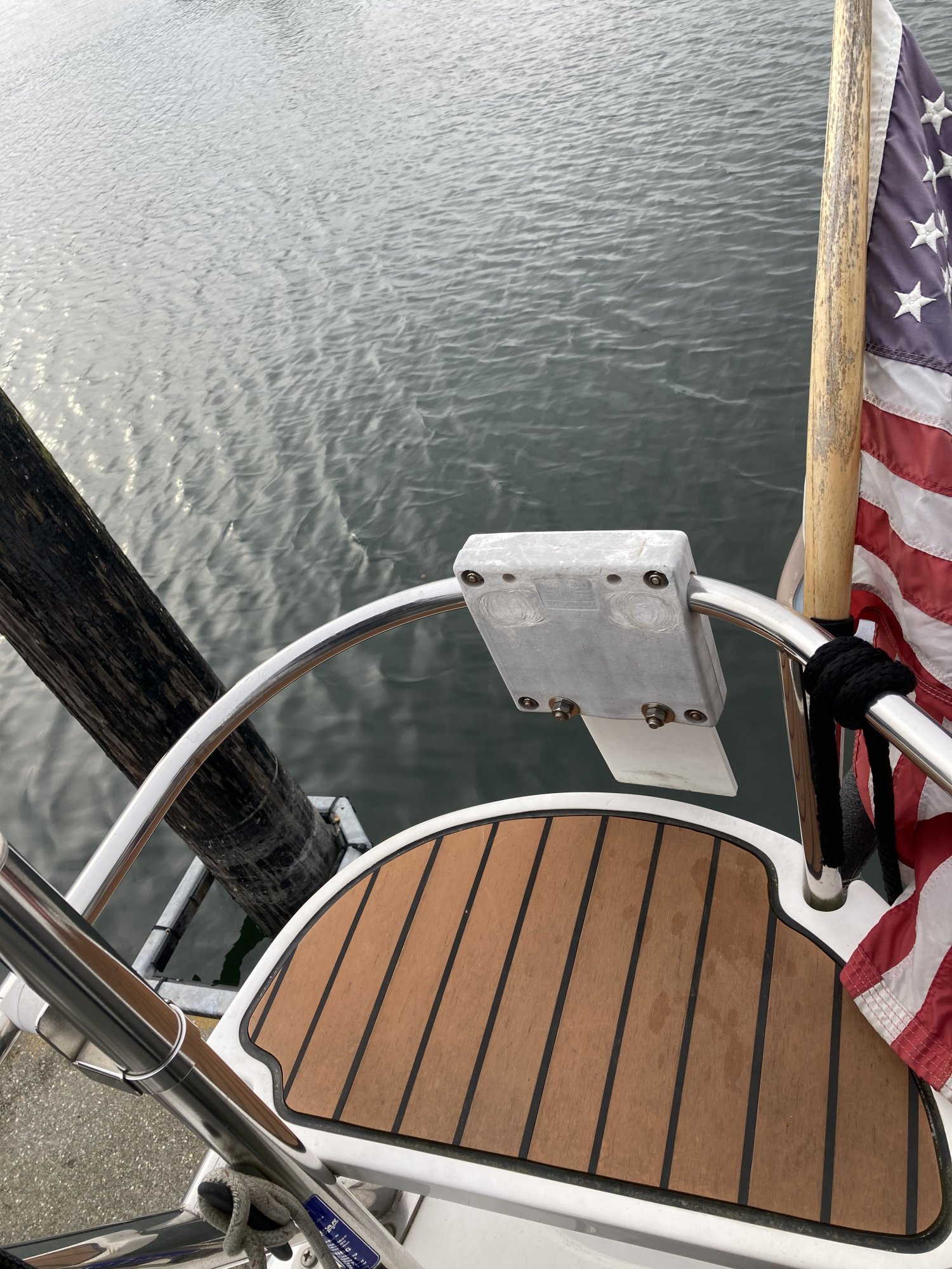

I've got the same mount - but mounted next to the T and it works fine - I've used it with engines from 2.5 to 5 hp
Mar 20, 2004
1,662
doesn't it swing freely due to no T to stabilize it?
no - it's tight on the horizontal rail and the weight of the engine stabilizes it; it's been fine in 10ft seas....
Sep 22, 2009
134
Hunter 36 Seattle, WA
Whats the vertical piece for? To prevent the bottom of the mount from swinging inwards?
Correct. The motor stem would prevent that as well, but the piece of marine board does it better. It rests against the seat when in use.

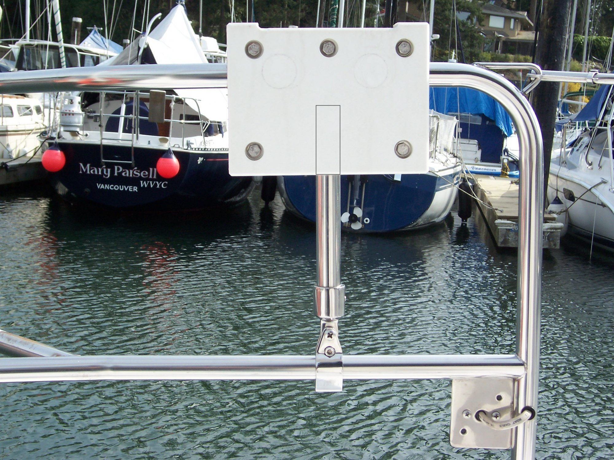

Seeing as you do not (if I understand you rightly) have a "T" in you upper railing, you might get something like this cut from Starboard.
I have a woodworking shop and cut out the internal bores with a 1" bull nose router bit. The plates are 3/4" Starboard. The bottom bore is only partial but allows you to attach a 1" SS tube to a lower rail with a clamp on fitting. No worry about it ever rotating about the upper rail.

thats a good idea. thanks. where would i but the s/s tube and clamp on fitting?
1" SS tubing can be found in short lengths at most marine shops. The SS fitting is commonly used in dodgers and other canvas fittings. As a last desperate measure, check online for these.

Did you clamp it on both ends to the horizontal tubing? Or is it 'floating' within the motor mount?

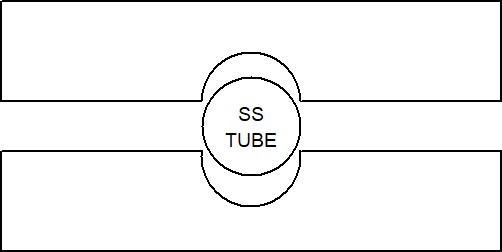

The horizontal tube is the original solid SS tube. Remember, what you're looking at is two 3/4" Star plates with half holes in them slapped together on either side of the tube.
The 3/8" bolts clamp the whole thing together. Top, bottom, sides, it's all tightly clamped together with the bolts.
Don't know why someone is not manufacturing these things yet. Easy to fab and neatly fits just about any railing arrangement.

Thanks Ralph. that looks like a good approach. I think I can just take my victory mount and add a vertical SS tube.
Jan 4, 2006
3,914
Yes, looking back at the Victory mount, if it's made from a solid material, just get a tube of the right length, hang a "T" fitting on it, attach to a lower horizontal tube, and you're off to the races. Please post a picture of the finished job when complete as I' like to see it.
