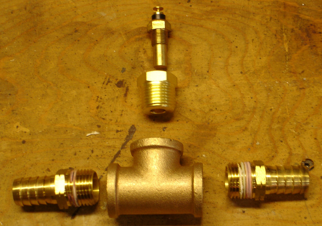

Tee
Well if you eliminate the light and buzzer and put the oil pressure
sender in it's place and will also need a gauge but than you are depending
on the pressure gauge for you to know if oil pressure and will not have the warning buzzer to alert you.
Or some one will tell you to use a tee to use both but let me tell you
what happen to me when I did the tee system which was great the first year
but one day I did notice the oil pressure gauge was on 0 as I was motoring
and good thing was right in front of me to see and for some reason the warning
buzz did not work and no alert.
What happen was the brass Tee cracked off and all the oil was all over the place and if not for the gauge right in front could have blown the engine.
I don't have a oil pressure gauge on my 07 H-36 and pretty sure most don't seem to have oil pressure or temp gauge but do have warning buzzers for both.
I check my oil every time each day I plan to motor and also check the ante freez every time also and change the oil often also.
But I did add a temp gauge and did it safer with heavy brass tee into the hose going into thermostat and been working good.

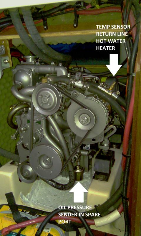

I have a 3gm30f and added an oil gauge. See attached picture.
You don't have to remove the existing sender. The thread is BSF, so you will need an adaptor to allow a NSF threaded sender.
Good luck.

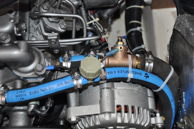

In the photo above, is that a temperature sensor in the t fitting in the hot water heater line? This looks like a great place to mount a temperature sensor. I don't think 2gm has the spare oil port... need to look again.
Thanks
Dan.
CORRECTION: In the shop manual it looks like the hot water line attaches below the thermostat, meaning the water is constantly circulated through the water heater and is at the temperature of the cooling jacket water. No wonder the water gets so stinkin' hot... d'oh. I deleted the incorrect stuff out of my post... no reason to post incorrect info.:redface:

get you a Faira gauge that will read 80psi and sending unite to match the gauge 12vdc and get an adapter from summit racing auto parts the size adapter you need is a 1/8 BPS male to 1/8 NSF female

My set up is is a little unusal as I have the sender connected to a nmea2000 converter so that the pressure/temp info is diplayed on my chart plotter.
Woodster gave a good suggestion. I just wanted to point out that you don't need to remove the exisitng yanmar sender.

What do folks use the capped "T" for on the hot water line (output to the heater)?
Apr 27, 2010
968
Beneteau 352 Hull #276 Ontario
It is a temp sender in the 'T' so that the engine cooling temp is displayed on a gauge or chartplotter.
