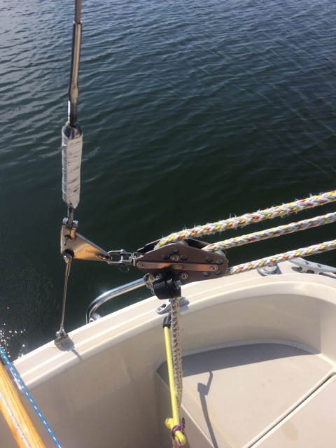

Maybe it looks like this:
It is a 4:1 fiddle block with a cam cleat attached to the bottom. It is shackled to a plate inserted in the backstay. The line is reeved through another fiddle block with a beckett, shackled to the end of the boom.
Understand that your boom is designed for either midboom or endboom mainsheet. That means that where you attach the mainsheet blocks is important, as the boom is not designed for a different kind of load.

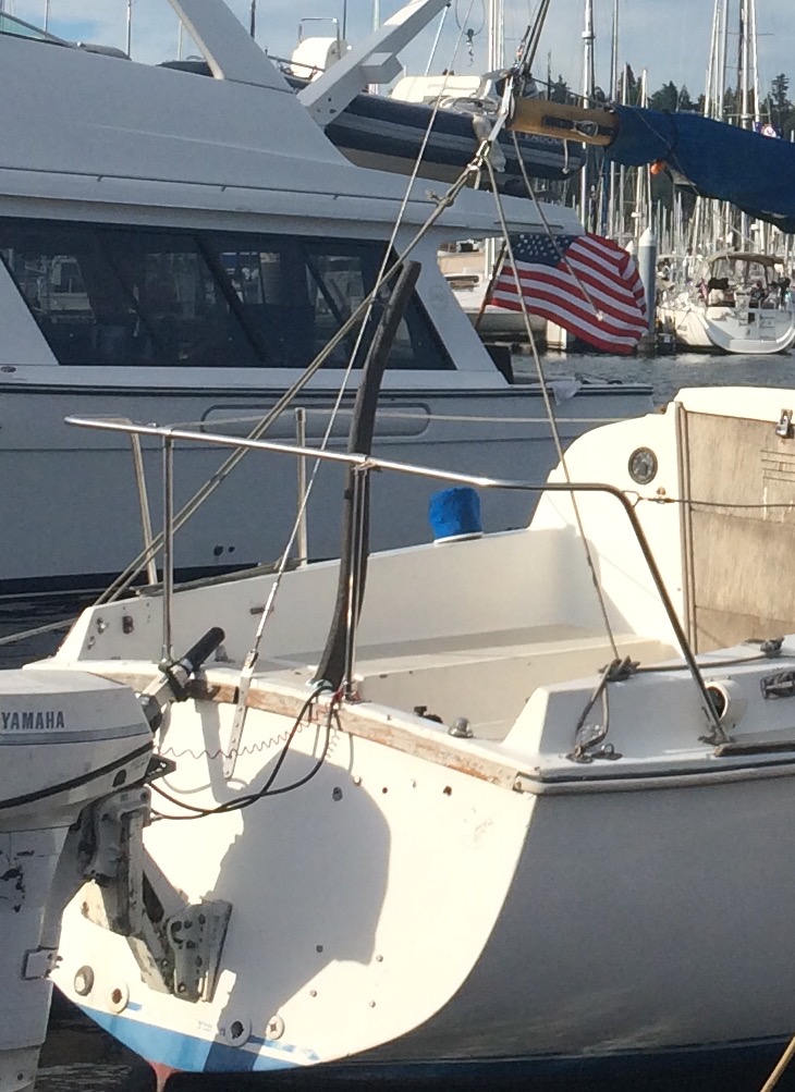

Thanks for the picture agprice22. I don't have the plate on my boat, but it looks like it is rigged from the back of the boom.
Here is a picture:
I could put a plate on the backstay I suppose. I found one online: http://www.drmarine.com/proddetail.asp?prod=O192-64

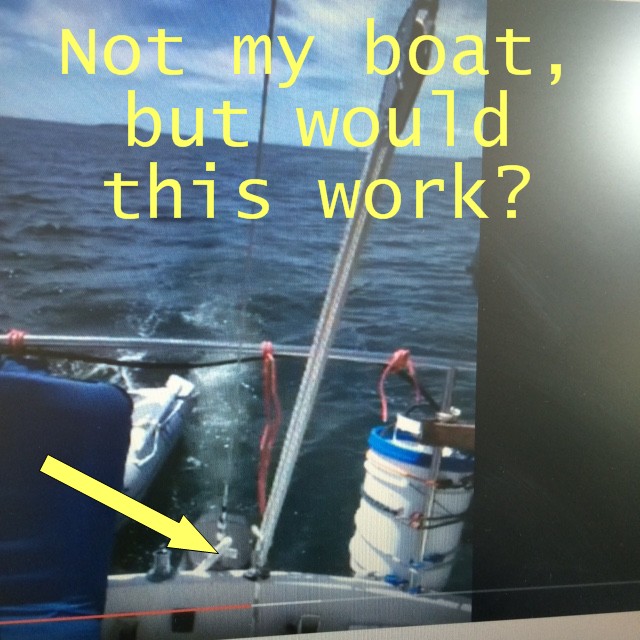

That would be great nightowle if you could post a picture. I think I prefer attaching to the stern instead of the backstay. Is there a reason why I would want a traveler instead of just a fixed anchor point on the stern? Again I'm new to this, but I have found a picture of an oday 27 online (I'll attach pictures below) where it looks like there is just a fixed anchor on the stern. Seems like that would be the simplest just to get me out on the water. (Edit: I've been doing some reading and I do get the benefits of a traveler. Just wondering if a fixed point would be an acceptable option for starters. I can always upgrade later.) I'm just not sure the best way to attach something so it's strong enough.

I would not go rearranging your backstay. I would follow the last picture posted. You would still need to arrange a traveler. It looks like the PO was hauling the boom to windward with that line run between the gunwales.
