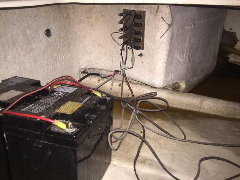

I recently inspected my boats wiring. Wow. I'm gonna be redoing that snarled rats nest. Anyway, I found that my boat is wired as a switched ground system, meaning there's no power to the panel. The positive wires go straight to the accessories and the ground is switched. If you start looking at your panel with a multimeter and nothing makes sense, keep that in mind.
Eek - that's a mess! Be sure to strap your batteries down as part of your "redo" (and/or put them in proper battery boxes!)

Eek - that's a mess! Be sure to strap your batteries down as part of your "redo" (and/or put them in proper battery boxes!) druid
Yes sir. I have no idea how they're supposed to be in there but it's getting a tray with straps at the very least. And those wires at least need to be tied up so they're not laying in the bilge... Not sure why you'd redo a system and leave it like that... Just as easy to do it right the first time
