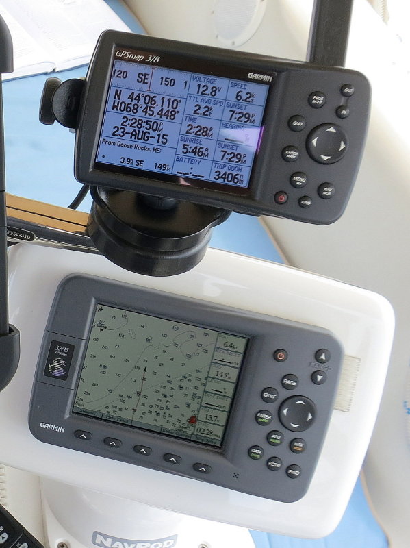

My Garmin GPS chart plotter has a setting that reports battery voltage. It is easy to monitor. Look for 14.4 volts when charging AGM or lead acid. Consider recharging when voltage falls below 12.45
Just be aware that the voltage the Garmin reports is measured at the plotter itself and is generally horribly inaccurate when compared to battery terminal voltage. If the Garmin plotter has an internal battery forget about any level of voltage accuracy.... The voltage on a Garmin should only be used as a heart-beat to see if the charging system is working or not. Please don't depend on it for any level of accuracy..
Here are two Garmin plotters both connected to the same DC circuit / bus. One is showing 12.8V and the other 13.7V actually battery terminal voltage was 13.94V....
