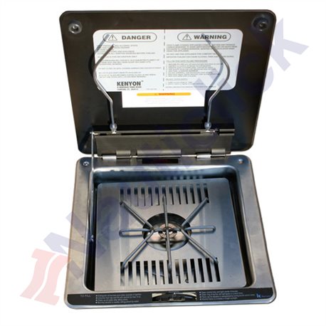

My boat came with a Kenyon single burner metho stove - see attached. Its OK but a bit messy and slow to boil. Doesn't gimbal so has a pot holder. The lid is glass so not an entirely practical surface closed and takes up precious bench space. Arguably better off with a removable cutting board in place of the lid.
Its useful enough to keep, but if setting up afresh I'd probably stow a single burner butane camp stove to use in the cockpit and have a recessed bin in the galley top not unlike Codybears suggestion ie a close and secure place to thrown stuff down into (other than the sink) from the cockpit under sail.

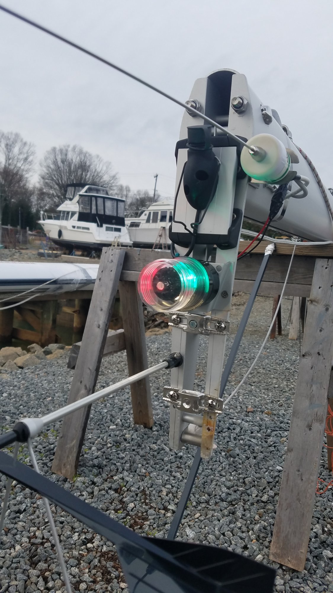

I installed the correct brackets for the flicker and replaced the anchor light with a combination tricolor/anchor light from marinebeam.com that only requires two wires. You can see on the photo the extra holes that were drilled for the original jury rigged install and the rust stains from the steel screws they used!

What is the black object on the plate that I have my anchor light mounted?
Like the new marinebeam light. Too bad I have already replaced my stock anchor bulb with a marinebeam led bulb.
Nov 27, 2019
32
C&C 30. MK1 715 Lake Norman
The black object is the mount for the Raymarine wind transducer, my boat has an I60 wind display.
I'll be replacing the rest of the bulbs for the running lights with LED's from marinebeam in the future.
