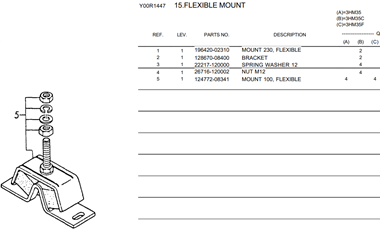

Does anyone know if the front and rear motor mounts are the same on a 3 HM 35 F. I am trying to order them to take back to my boat. I know what the front look like, but not the rear? Anyone know? How about the part number? They are the unusual upside down looking u bracket mounted on the rubber block. it's on a 1986 legend 37.5. Thanks

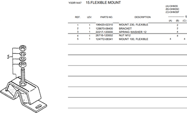

The parts catalog shows the same mounts front and back. Part # 124772-08341.. it has the number "100"
You can call the guys at Toad Marine to verify.. Be ready for a shock if ya want the Yanmar mounts.. $195 each! PIRACY!
