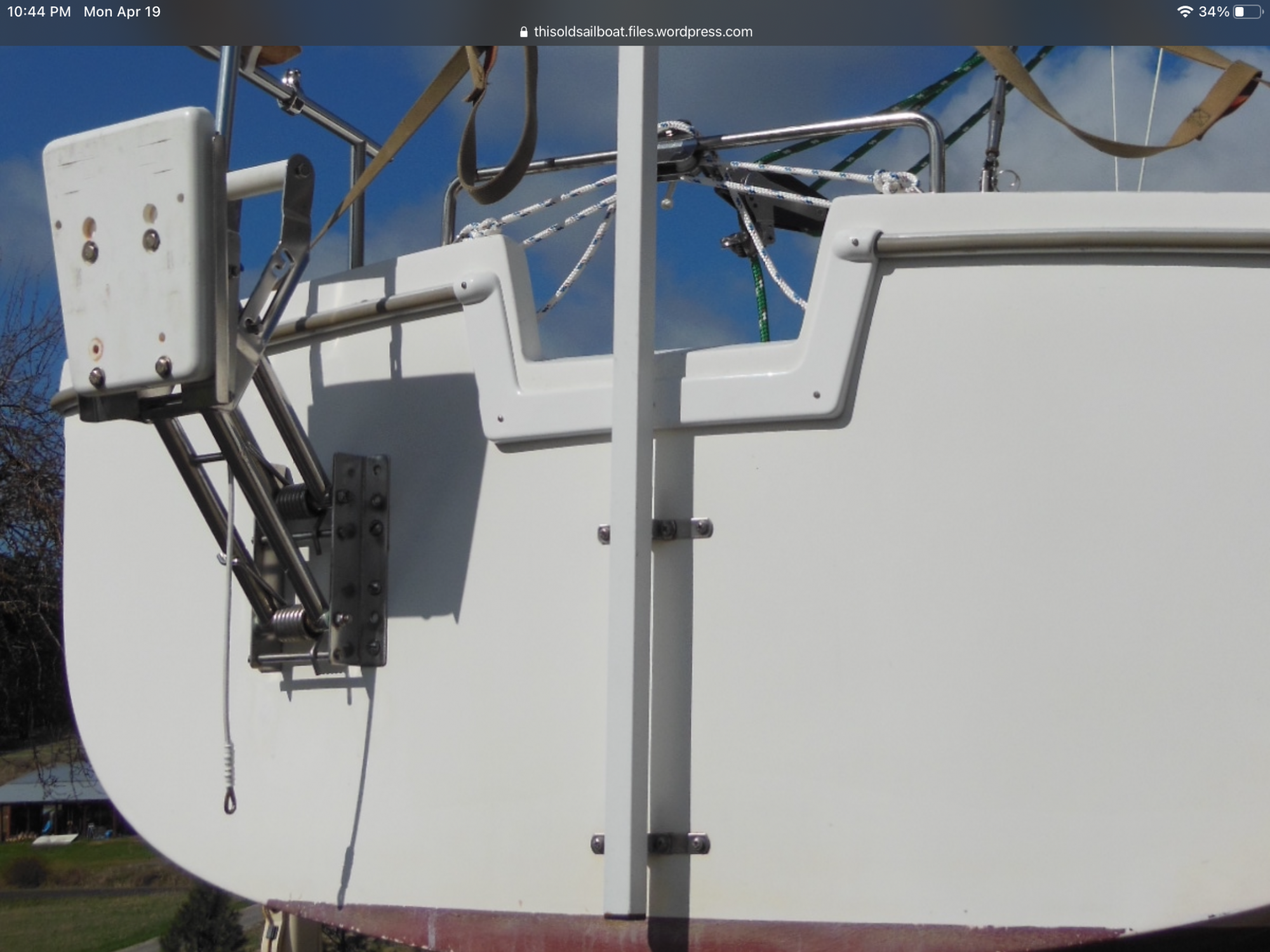

high on my best mod list was throwing away that da#$ lift "adjustment" mechanism and installing this. no more crawling under the railing, and now it's a 3 second task to raise or lower.

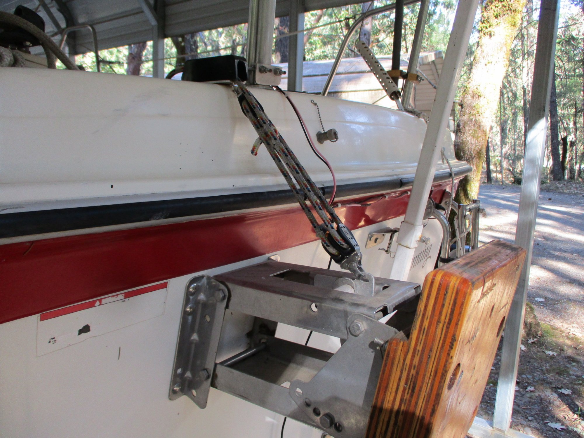

Catalina 22 #2552 2252 Kennewick, WA
super old pic from the day she came home-- but do you have this version of mount or different? Just curious-- Mine is essentially a PITA as well.
Jul 13, 2015
768
I was looking at @RussC's set up -- but mine, like yours requires the downward and slightly outward push before the notch disengages and the spring takes over.
RussC
Sep 11, 2015
1,530
Merit 22- Oregon lakes
I eliminated the notch and the spring altogether as both are no longer needed. I did make a replacement plate without the notches on mine, but just to limit the up and the down travel range.

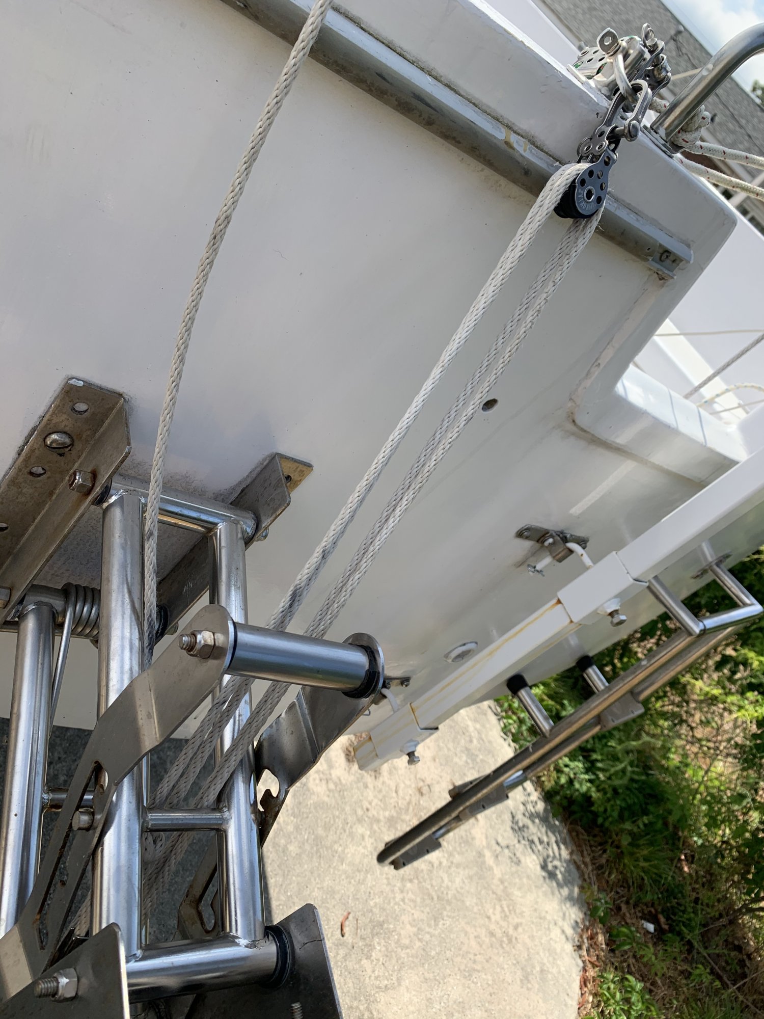

I can get the push, it is the lift, if I had a line to pull once released good to go and more important once cleated, I have some security if the notch gets knocked loose, the engine will not plummet to the bottom of the mounts travel.my spring is weak, so I still have to lift what feels like the full weight of the motor with no leverage and a poor mechanical position.

I think I am going to try a variation of your set up some 25mm blocks one with becket and v cleat, an eyestrap, a stainless hose clamp and some 1/4” line and It should be better for under $50

so testing is going well with this, just need to put in the pad eye and get less slippery rope. Wife can manage to haul engine up and I can cleat off or put in a stopper knot for max drop. Ocean trials to come
