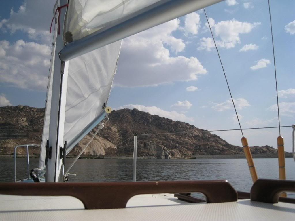

I have slugs on the luff and my main halyard led back to the cockpit. I can raise the mainsail without a winch but on windy days when I want it tight I use the jib winch
Halyard is the white/blue line
