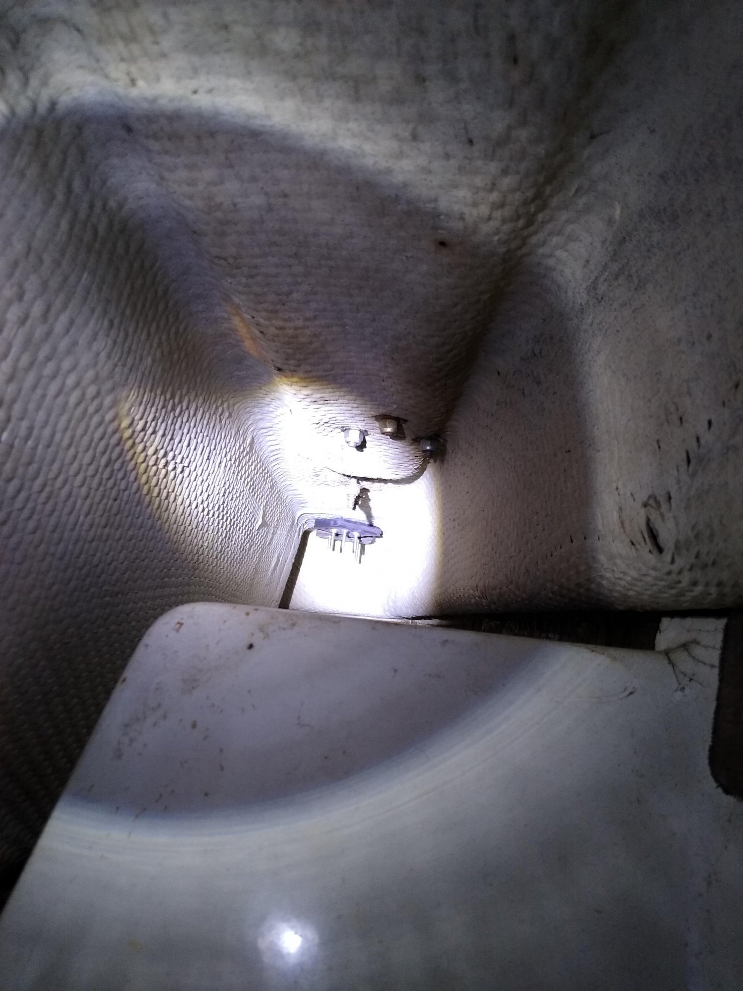

I was cleaning and noticed that there was mess at the bottom of the support. I started cleaning it up and found the mast support had been damaged by water collection.
It feels like a pine 2x4 but would like to know for sure.
Does anyone know for sure. I am pulling it out right now.

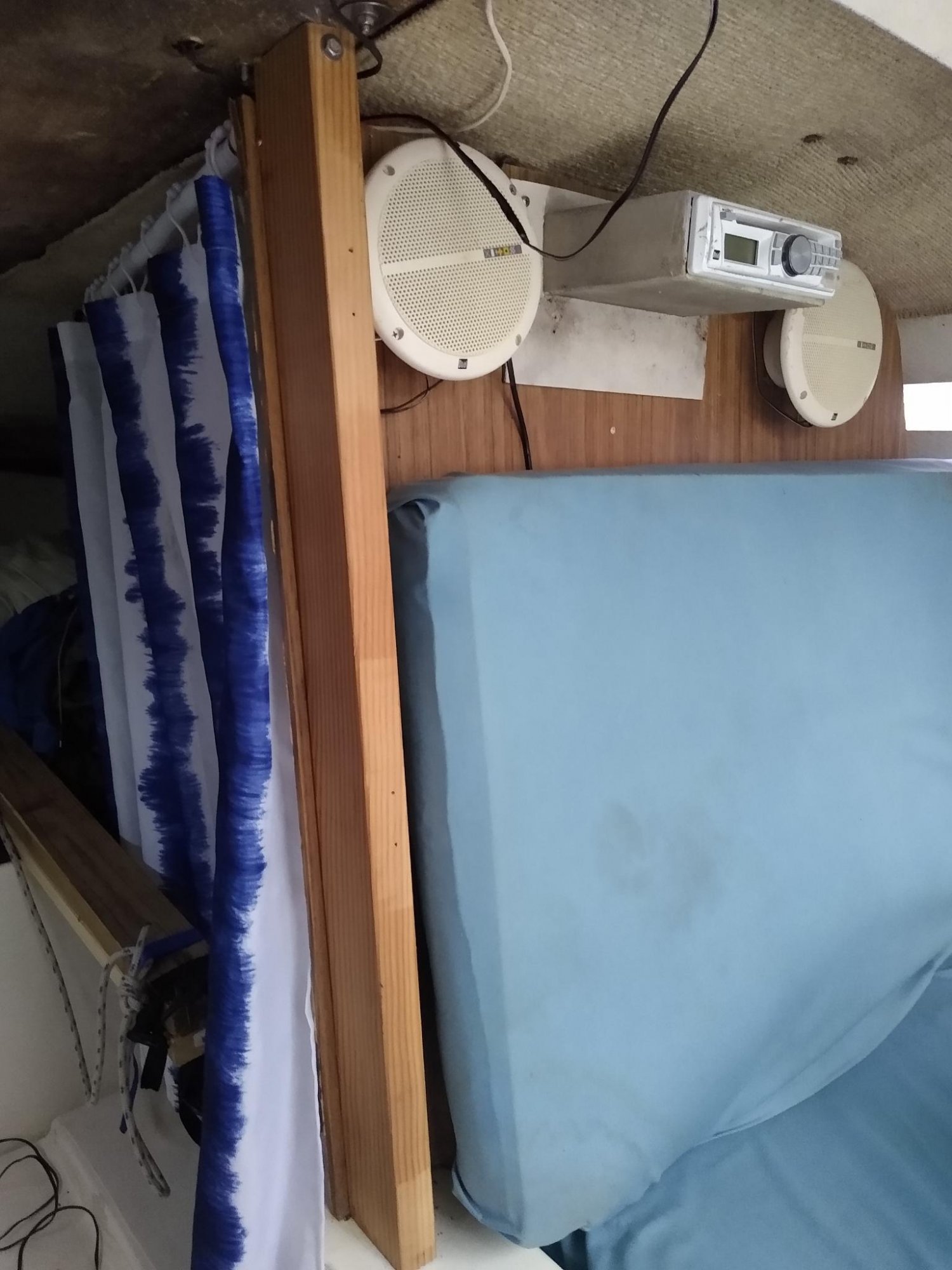

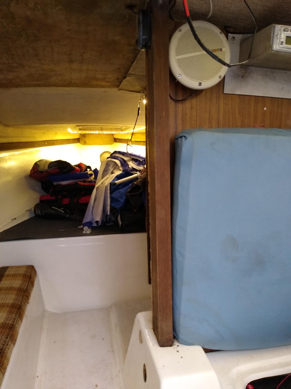

I replaced it with a knot free 2 x 4.
I was able to match the curves in the fiberglass and make it fit close to perfect. I think it is much stronger than the old support.

Ok. Here is the problem.
The boat was built in 1981. Now with the support in place the Shrouds(side stays) are too tight. The backstay is too loose and the forstay if very tight.
I think I need to loosen the shrouds to allow the mast to lean forward.
I will be reading everything I can find.
I would appreciate any help.
