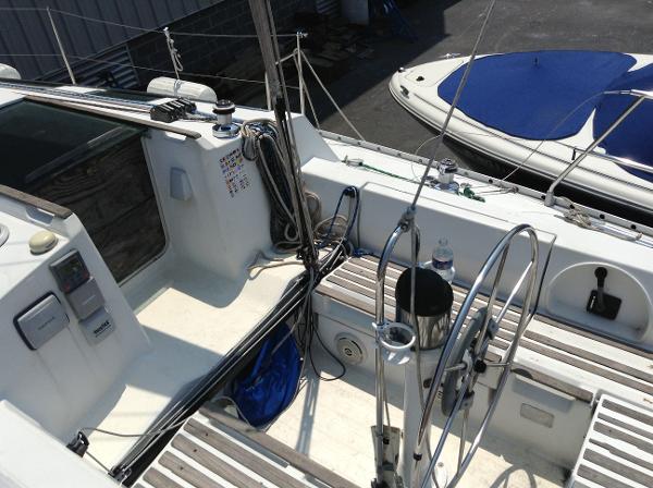

From pictures, I can assume your only viable option for cockpit traveler is right behind the companionway. The deck shape there looks like it might already have a location available for such a configuration?
I really like the configuration in this picture this allows a mainsheet trimmer (assuming its not solo sailed) the ability to sit on the high side and dump the traveler easily, and work it back up again. 2:1 isn't going to cut it, you'll likely want 4:1, picture looks like it shows 3:1

Thank you all for great information. Yes, the configuraiton will be the same as shown in the photo. I am concerned about the 26 3/4" span the traveller has from side to side (where the bag is situated in the photo)....? Do you think I should add a "bridge" of some sort?

Two options:
Mount the traveler bar on a support; a 1x1 SS tube with 1/8th walls. See the link in my first post. My bat has the same span distance.
Use a high-aspect traveler bar designed to span widths.
