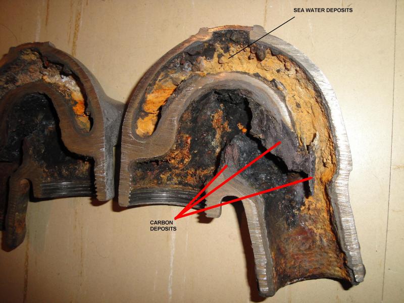

I'd Still Lean Towards ..................
I have been told that it could be an exhaust problem, but I don't understand why it could rev up when out of gear, and not rev up in gear if it were an exhaust problem.
........................ the mixing elbow as the cause of the problem. It's worth a look at this point in the game
The reason you can reach 34K in neutral is that it takes very little fuel to turn over the engine without a load. Once you add load to the engine, you have lots of additional burned fuel (carbon dioxide) to pass through that constricted mixing elbow. It's this backup which is reducing the loaded RPM.

It's defiantly your mixing elbow close water intake remove elbow and inspect I remove mine and clean every other year and get 6 years out of the Oem part gonna try the aftermarket stainless next time

Chisel with curve tip and heavy hammer. Replace gasket (p/n 128370-13201) as required. Do note that one end of Joint (p/n 104214-13580) has RH thread to Exhaust Elbow (p/n 128370-13610) and the other LH thread to Mixing Elbow (p/n 124070-13520).

Yea chisel scraper and I use a wire brush in a drill to really clean inside then boiler brush (they sell at HD ). I then paint with high temp paint to try to keep corrosion down for the possible month till paint wears off

I bought a set of these picks: http://www.globalindustrial.com/p/t...mpaignId=T9A&gclid=CKT99JP54boCFUwV7AodwCEAHw at Home Depot. The one with the right angle bend seemed to work the best. I removed the elbow from the engine and the exhaust hose for easier access. I found the worst blockage where the raw water enters the top of the riser. Take your time and keep digging away with the pick. It's hard to tell where the crud stops and the metal starts. I then filled the cavity with phosphoric acid but it didn't seem to make much difference. The gasket is part# 128370-13201. You might want to just buy a new riser while you are at the dealer and cleanup the old one as a spare.

Keith you got to take them out and apart to chisel the rust out. I do annual removal and clean out. With this annual service, the Mixing Elbow will last couple years and the Exhaust Elbow and Joint seems to last almost forever.
