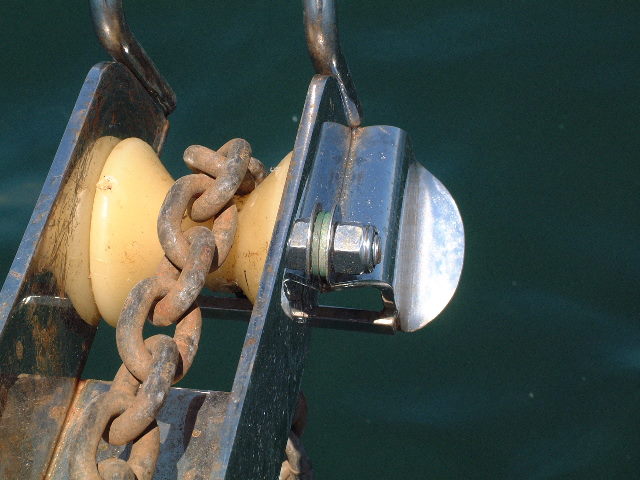

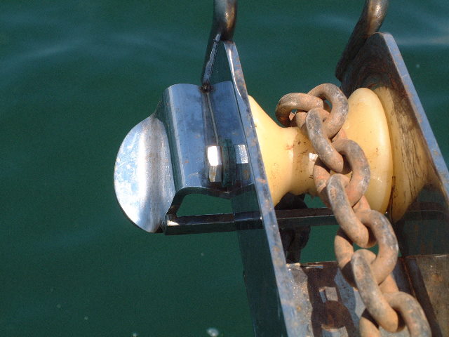

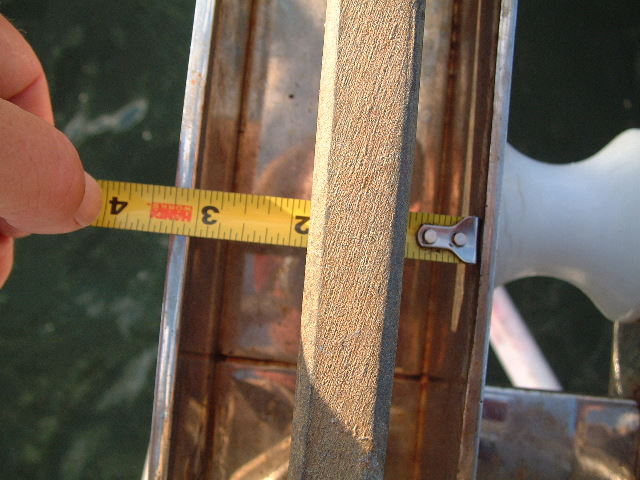

The width of the bow roller channel is 3 1/16" and I have used a roller that is 2 7/8" with success see the picture below. The diameter of the forward pin is 3/4" for sure. I am pretty sure that the pin that holds the aft roller is 3/8". I know that the common rollers for trailers that can be bought economically have a 1/2" hole and when used in the aft position with the original pin there is a lot of slop.
The forward pin is definitely 3/4". Last year I machined two shouldered bushings that fit into the hole from the outside with a 1/2" thru-hole. Using these two bushings I used a standard roller that I could readily buy and pinned the roller with a 1/2" bolt. The pictures below show the bronze bushings that I machined with a common roller with a 1/2" hole and a stainless blot that held the assembly in place.
For the aft roller I simply used a standard bronze bushing that was 1/2" OD and 3/8" ID. Using that bushing the standard rollers had the proper clearance while still using the 3/8" aft pin.
I do think I remember running the sides of the rollers on a belt sander to reduce the width to about 2 7/8". But that was the only modification that I needed to make to the roller itself.
