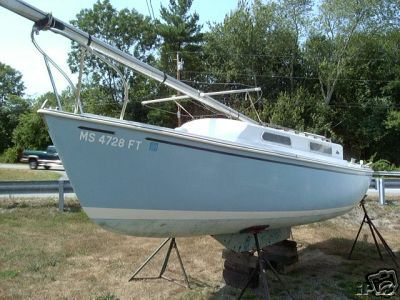

Sounds like you have an O'DAY 23-1 full pop-top (1971-73), most likely there is no 12-digit Hull ID Number on the Transom due to the boat being older than November 1972, when the HIN Requirement started, I think that 6 persons may be "doable", if they aren't moving around a lot. Does this boat have the standard Keel/Centerboard as shown in this pic? Or is she a "Rare" deep-Fin-Keel O'DAY 23s? Few were made that way, but they might be a bit more stable than the shallower, standard K/CB.
