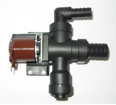

You need a vented loop in the head intake line...It needs to be at least 6-8" above waterline AT ANY ANGLE OF HEEL (including MAX heel), not just when the boat is at rest. On most sailboats, that would put it 2-3 FEET above the bowl.
And for an electric toilet it will require a electric solenoid valve wired to the flush button to operate it (this should be spelled out in the owners manual for your toilets). If you need more "hands on" help to install it, Paul Campagna is Jabsco's toilet guru...
Paul.campagna@xyleminc.com
Direct line: 978.282.5246
JABSCO 37038-1012 Solenoid Valve & Siphon Breaker
jabsco 37038-12 solenoid valve.jpg.
(That link will take you to it on the WM site...you can find it elsewhere for a LOT less!)
--Peggie
