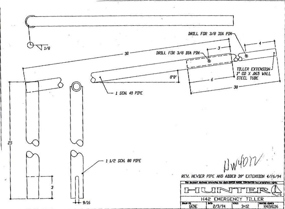

Hi Eian, do you mean the tiller itself, or the deck slot the tiller slides into? Our boat came with an emergency tiller, but have never used it. Not sure what you mean by bracket.Would anyone have the drawings for the emergency tiller bracket for the 1991 H42 please? My boat didn't have one when I bought it, and i feel irresponsible passaging off shore without one.
Double check your rudder stock against the drawing. My 1990 P42 has a considerably larger stock than the 1.5” tube shown in the drawing. If I had built my replacement tiller from that drawing alone there would have been unacceptable slop in the fit. I had to use 2.75” tubing to match the I.D. of my rudder stock.Eian - is the attached what you're looking for?
