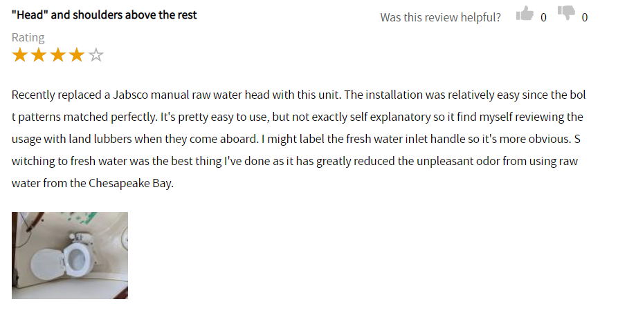

Will the Raritan Fresh Head mounting bolts fit into the same bolt holes as a Jabsco manual marine small bowl toilet?
Apr 8, 2011
461
Hunter 36 Deale, MD
Peggie:
NVM, was able to find a review on Hodges Marine that confirmed the mounting holes are the same:
