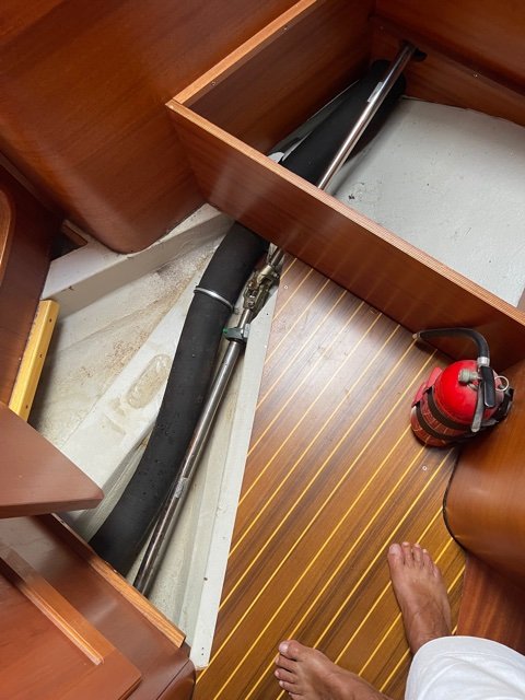

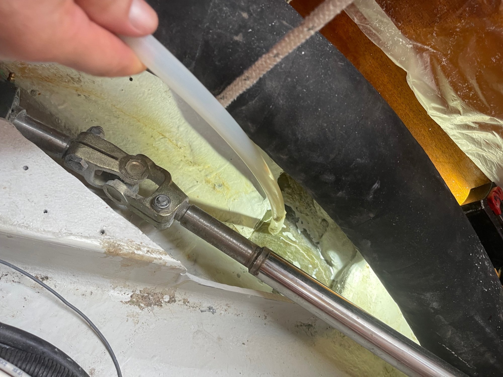

Hi,

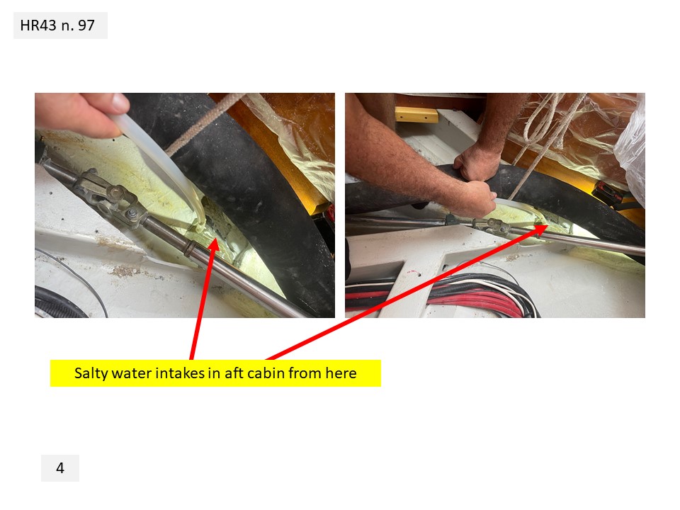

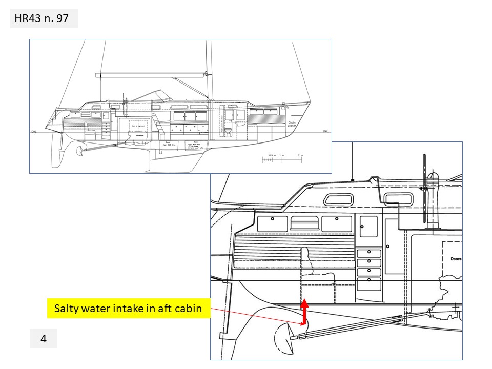

Reduced size of video, Here it is clear the water coming in,
Any ideas?
many thanks

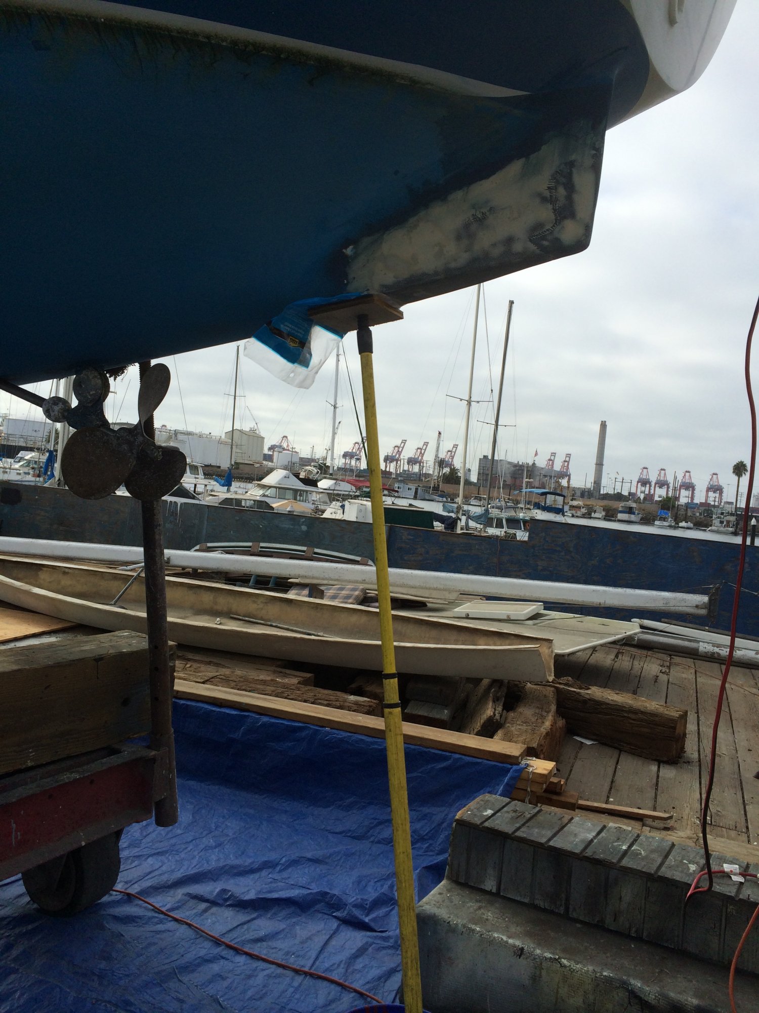

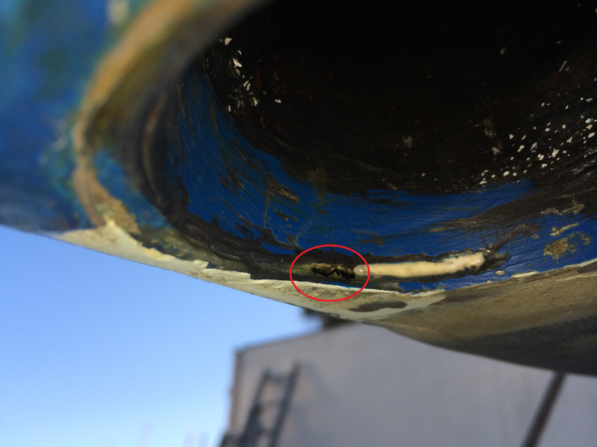

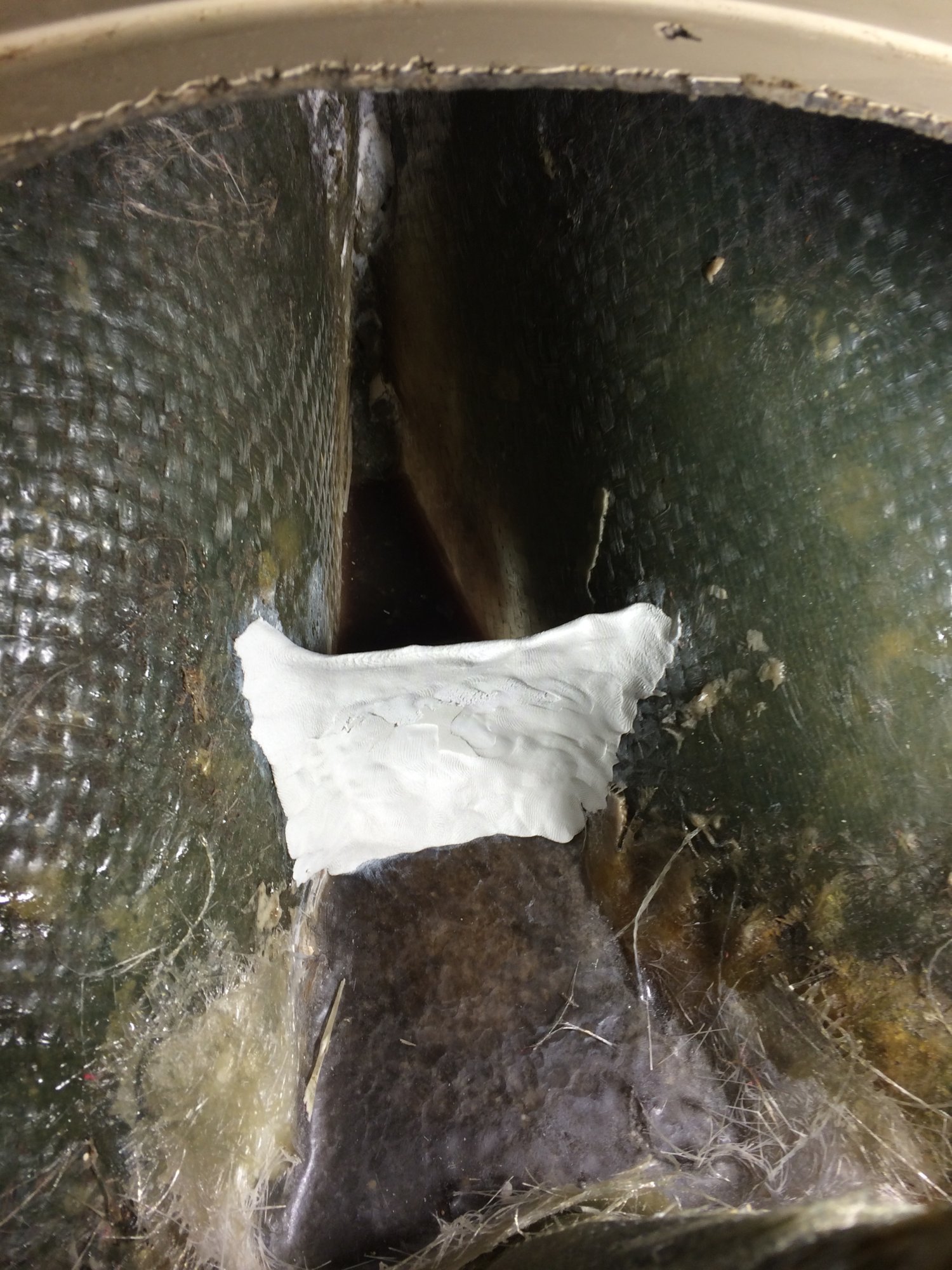

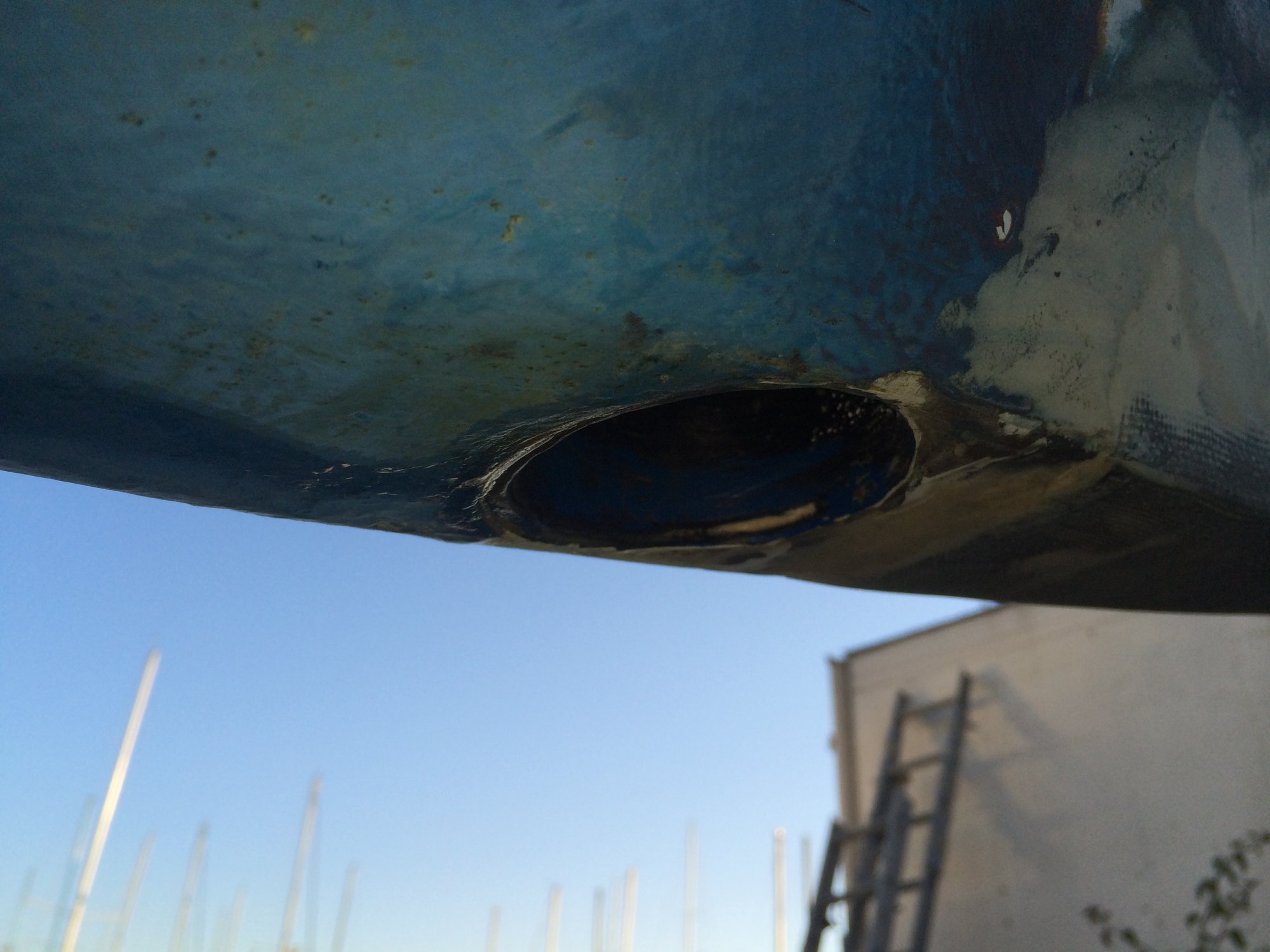

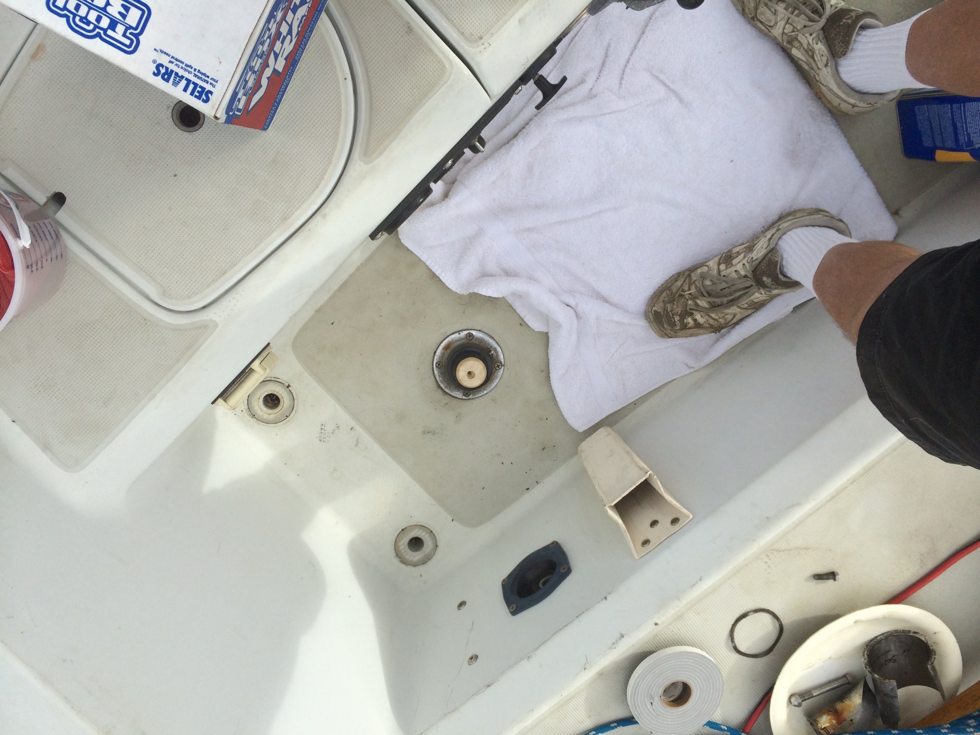

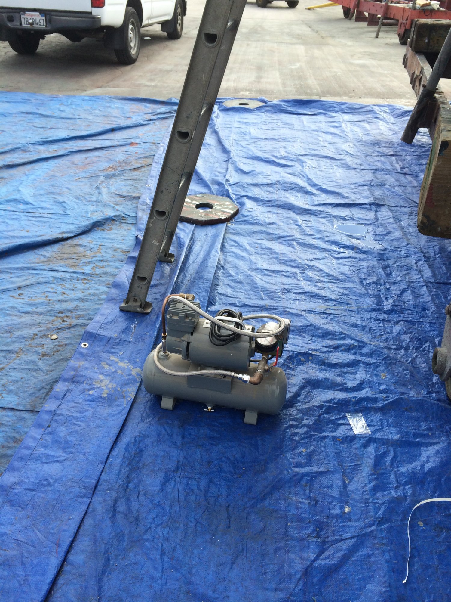

I've attached some pictures showing what we did. I added a red circle around the void, which you can see if you look closely. I have a short video of the pump running in the cockpit, with the hose connected through the bung, but I can't upload that video here. I did provide a picture of the pump itself, before we hooked it up.

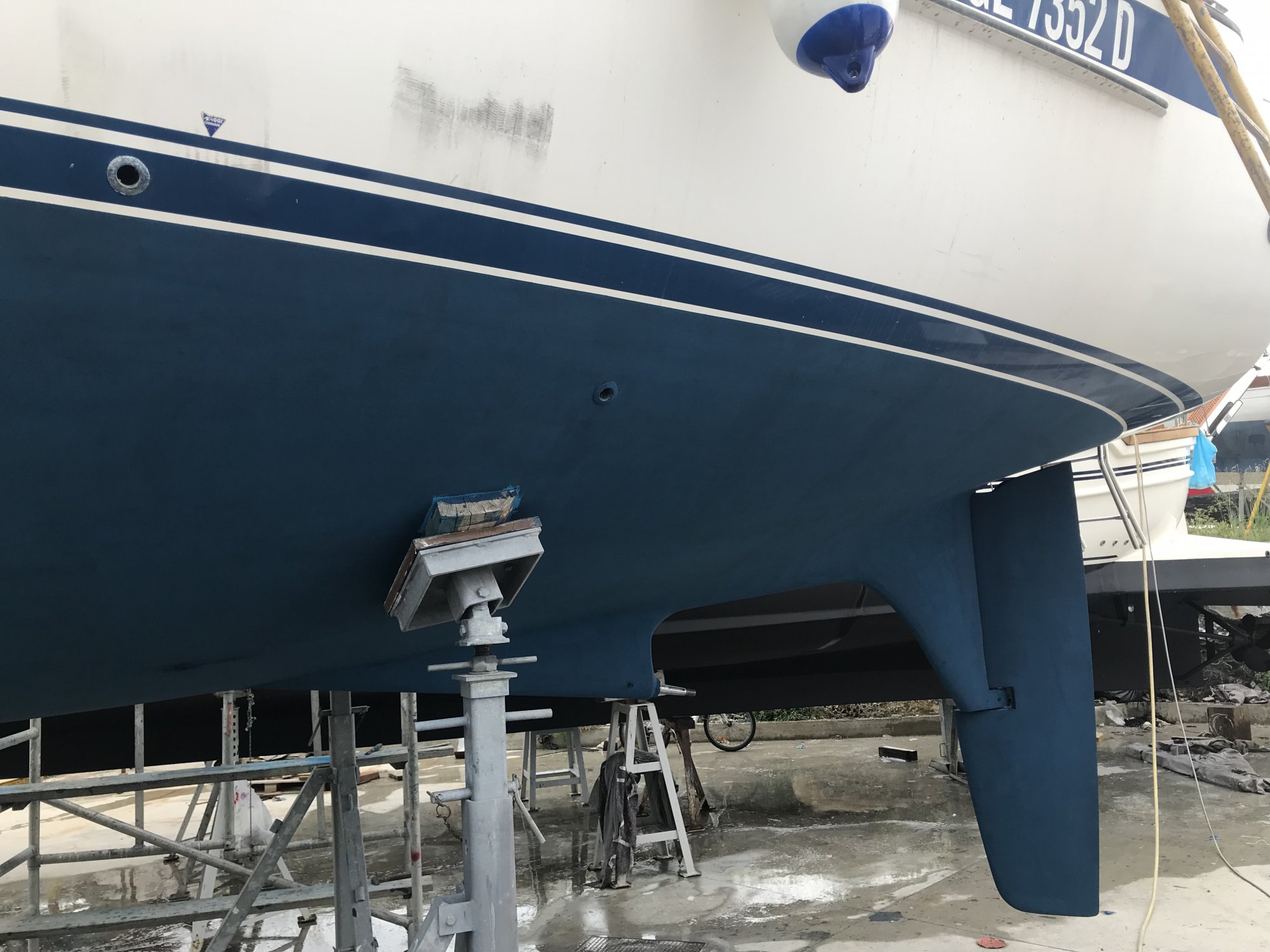

Thanks for the description, surely the solution you adopted could be fine in my case too.
My problem however is that I see where the water enters the cabin from but I don't know where it enters the hull from.
Alan, Rlaph, do you have any suggestions on what to do to find where to seal by vacuuming the resin outside?

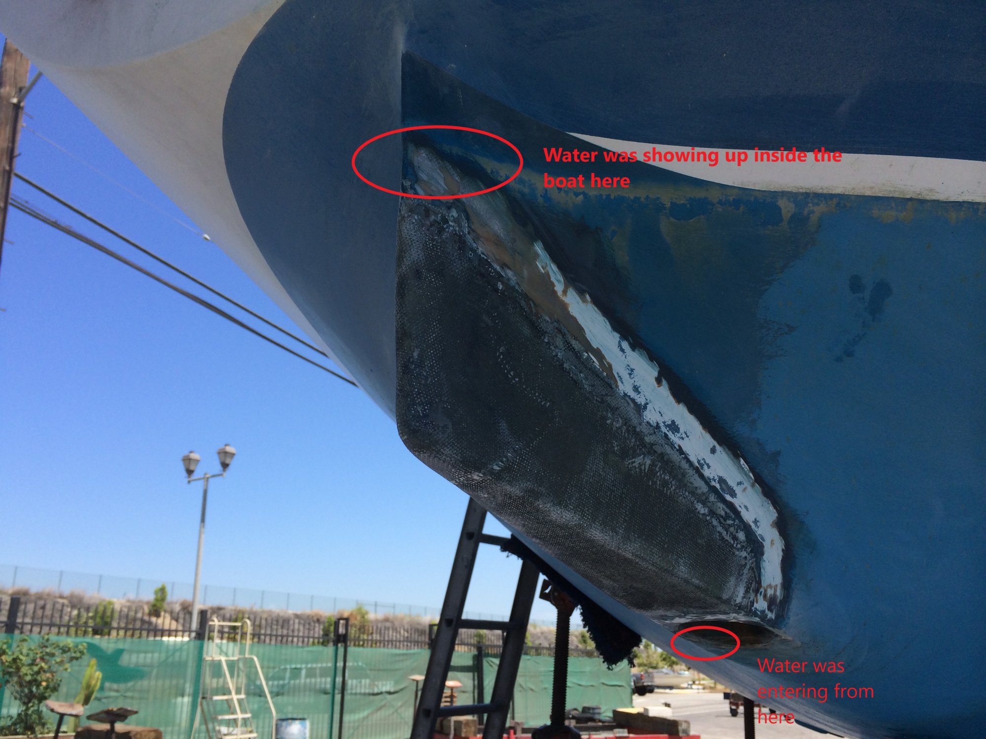

Take a look at this photo. I've marked where the water entered vs. where it showed up inside the boat. The way it presented itself on my own boat was that water would just well up in the very aft end of the skeg and then run downhill into the bilge. So Neil and I naturally assumed that the water was entering from the aft end of the skeg, more or less directly below where the water was entering the boat. So that's what we set out to repair initially.
In tearing into the skeg, we did see a number of voids in it and figured we had identified the issue. You can see from the photo the initial glass work that we did on the skeg to repair the leak--or so we thought. Well, after splashing the boat with this nice newly reinforced and glassed-over skeg, water was still entering the boat and showing up in exactly the same place! What the heck!
It was only on the second haul out that we were able to discover the true source of the water ingress. And then we put Neil's genius idea for rectifying it into play.
