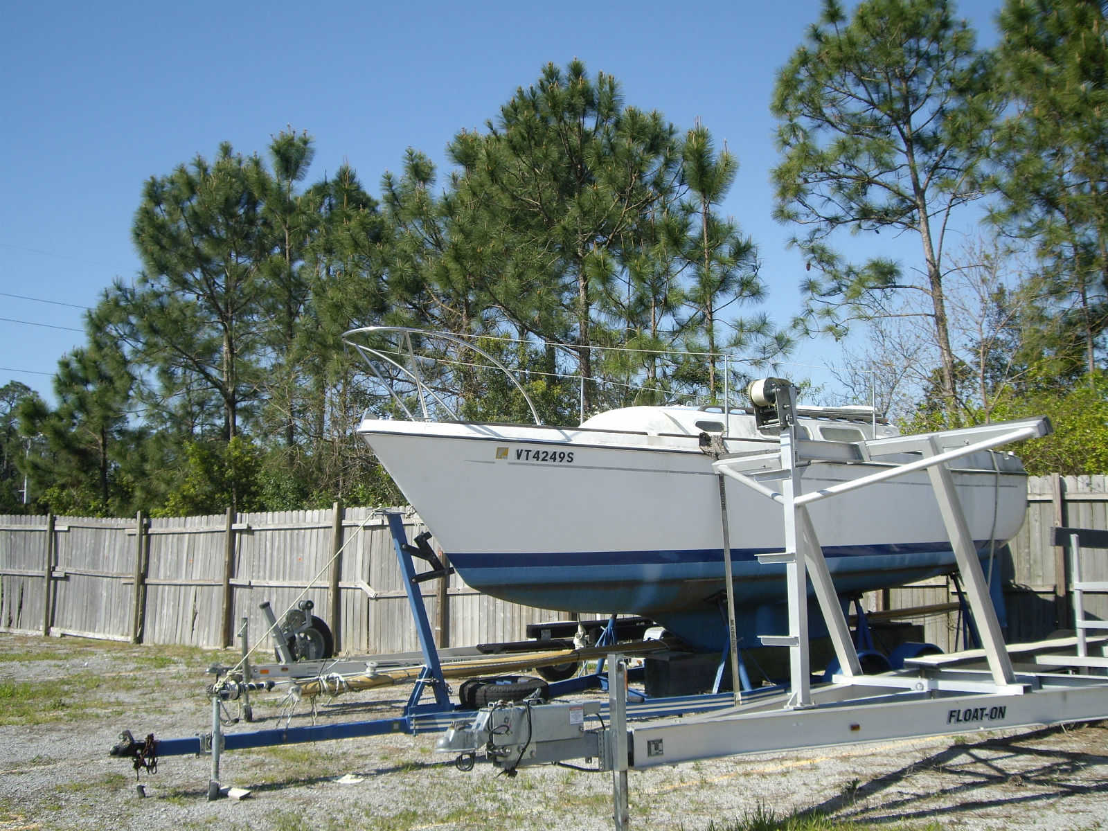

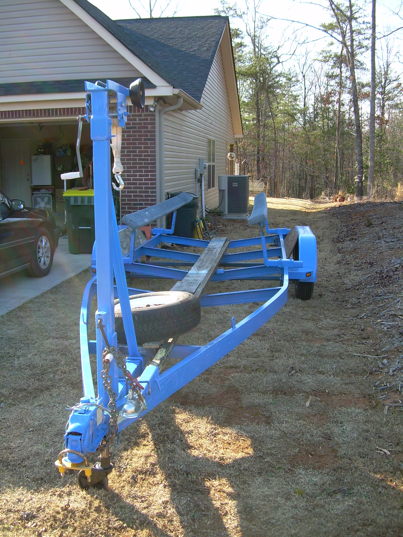

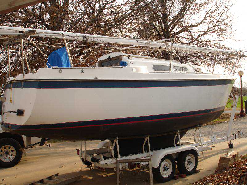

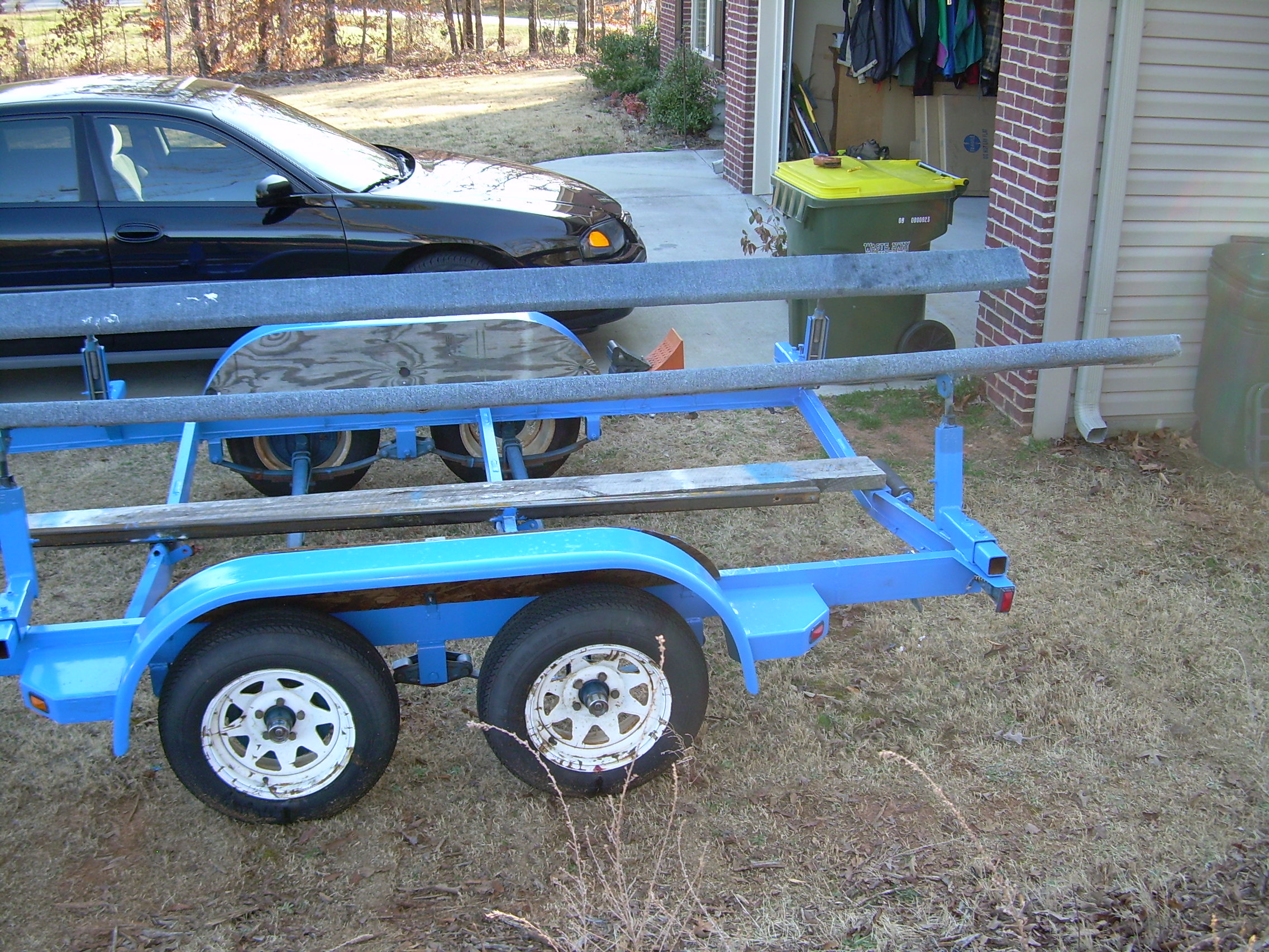

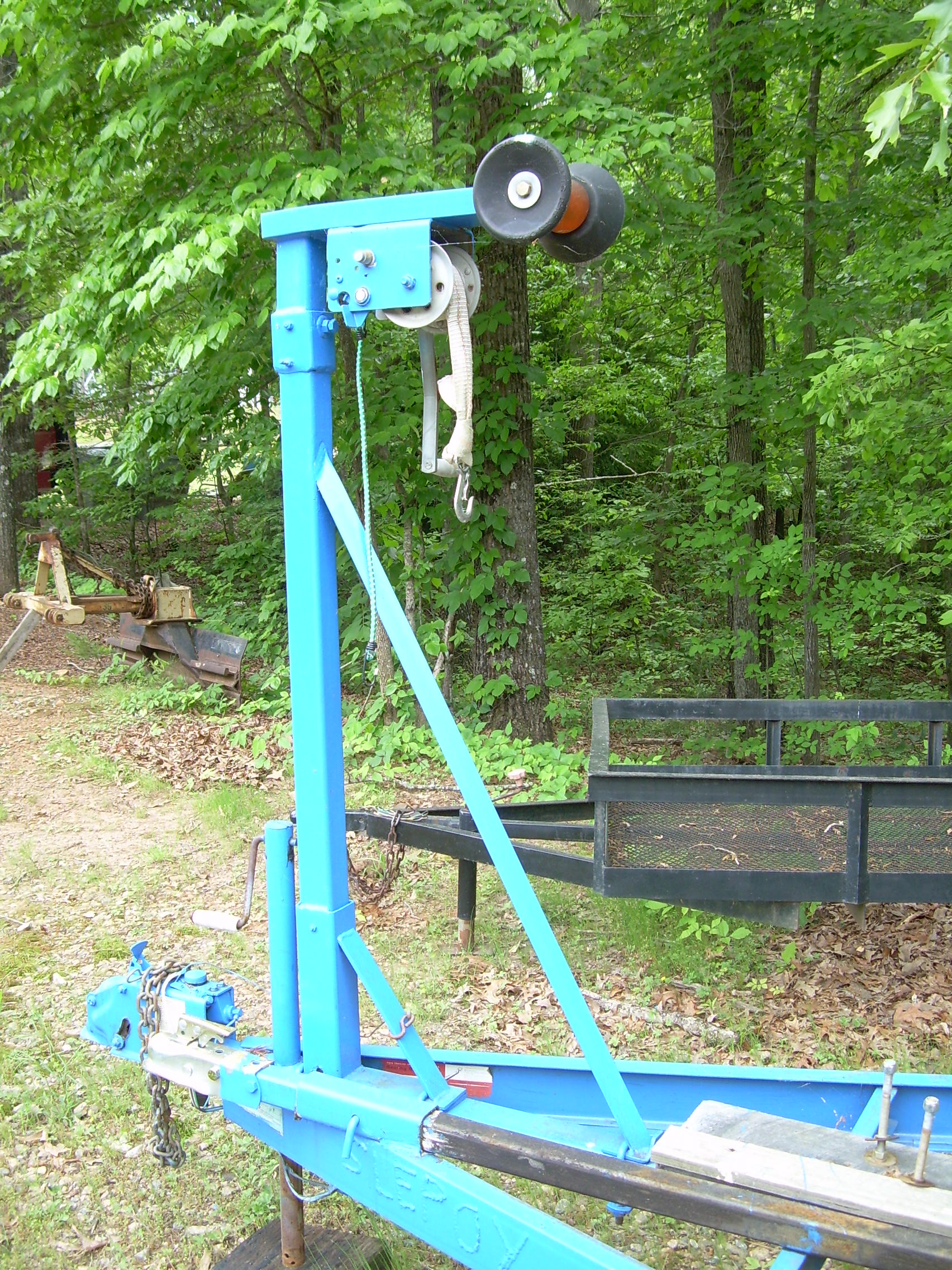

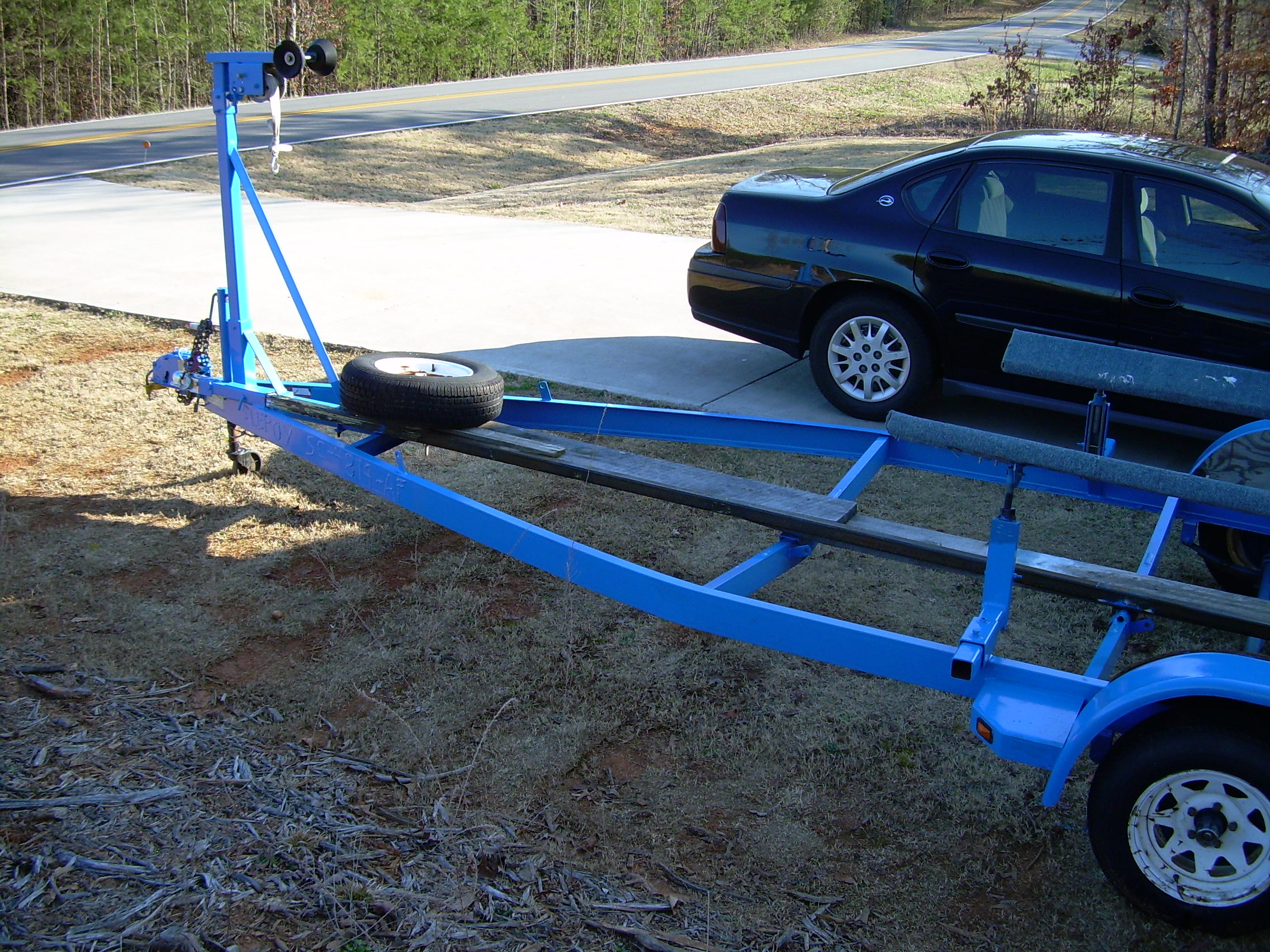

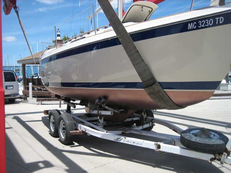

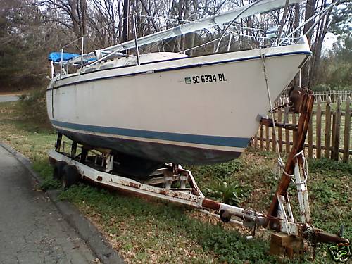

$(KGrHqJHJCYFIZ-WLfTCBSLjGEzr,!~~60_3.jpg Well, I don't have an O'DAY 25..... but I do have a collection of pictures that should show various 25s on their trailers and I might have a pic or 2 of a couple of trailers for the 25 without a boat on them (might not be the "standard" setup, but used for a 25 anyway.).

That's fantastic, Sunbird! It gives me a great start. Much appreciated!

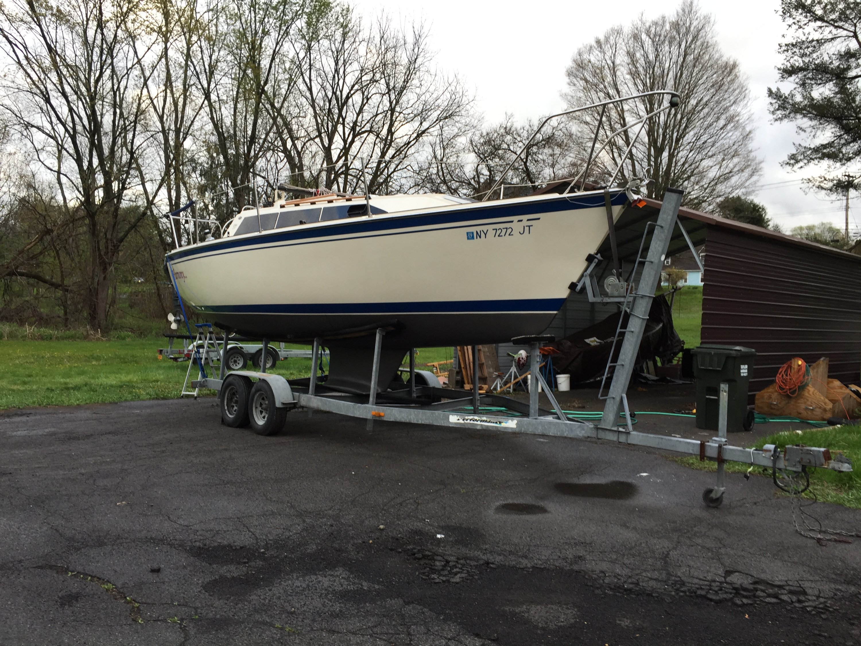

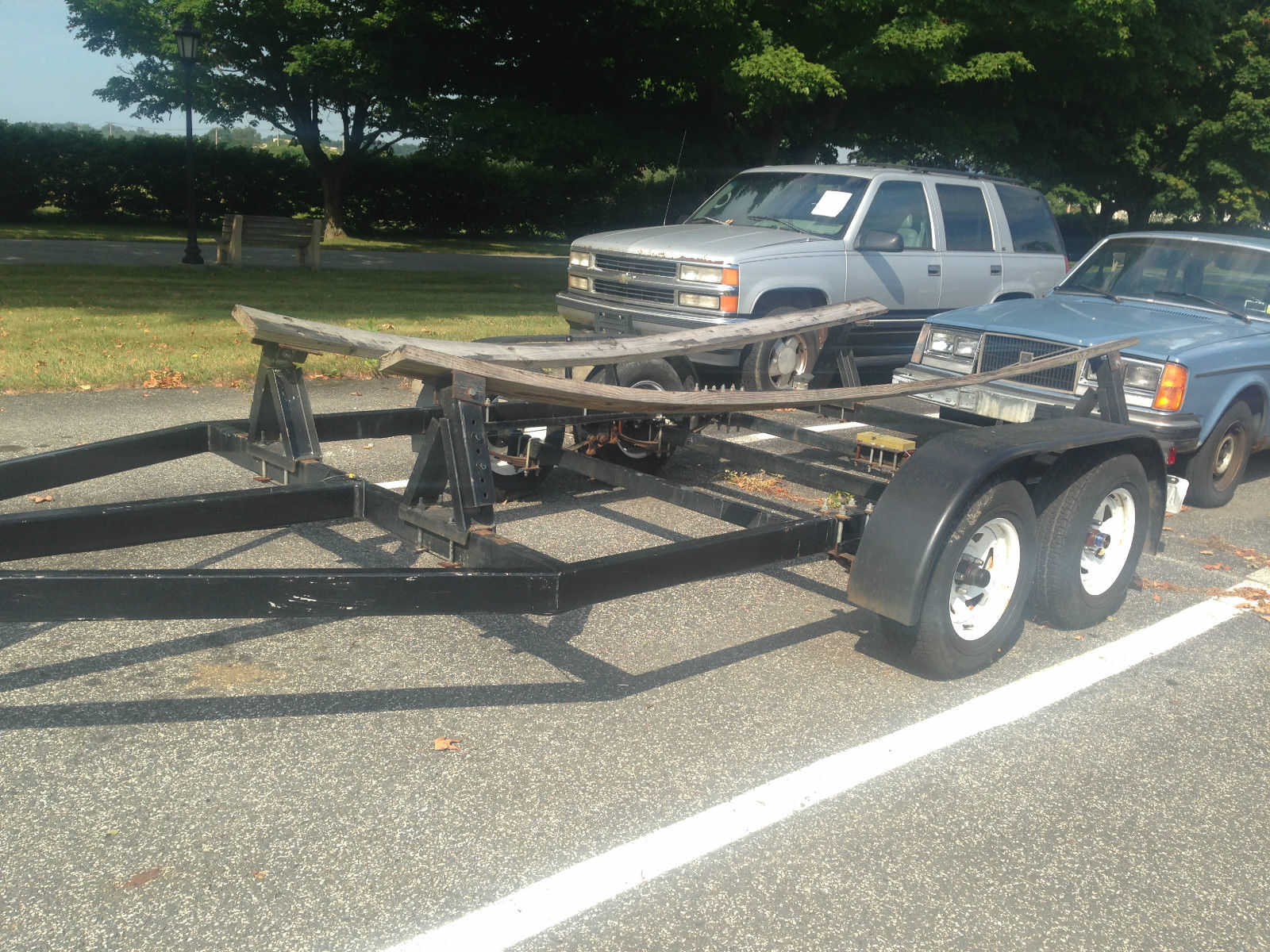

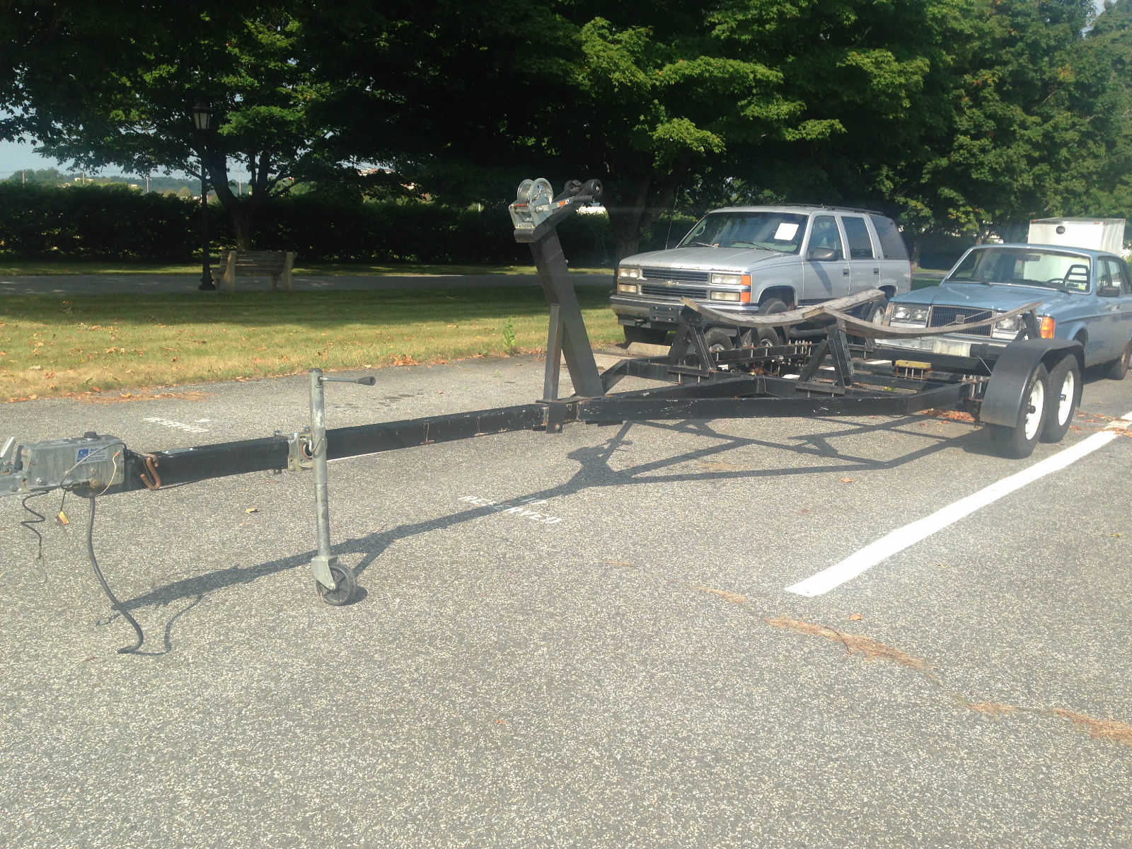

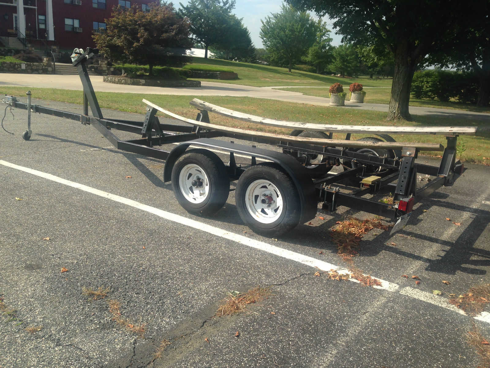

But it looks like you got plenty of info on the 25 trailer!

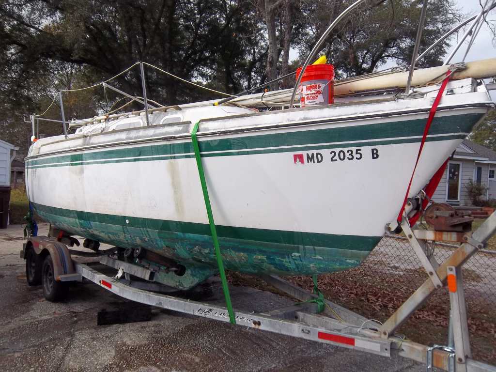

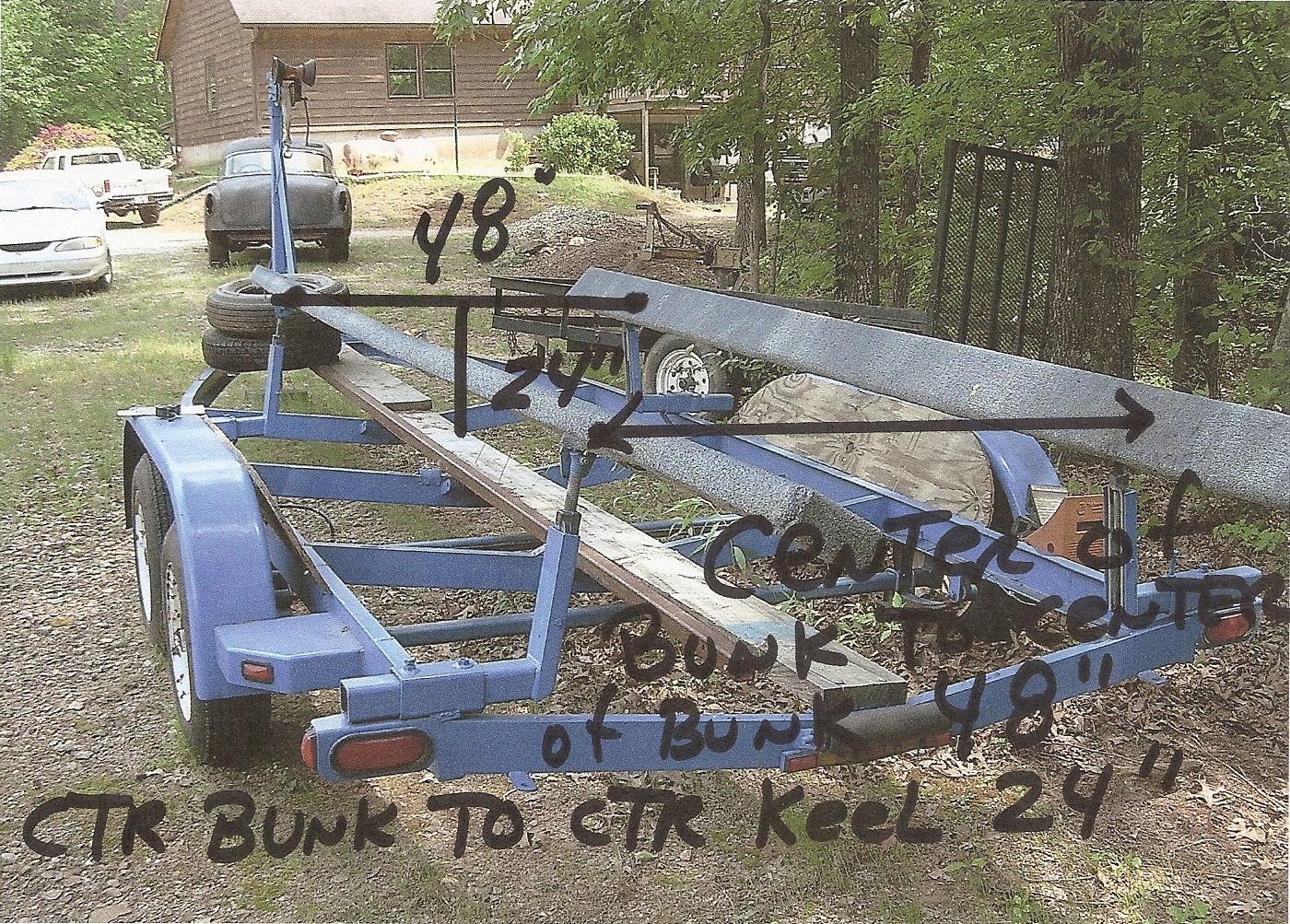

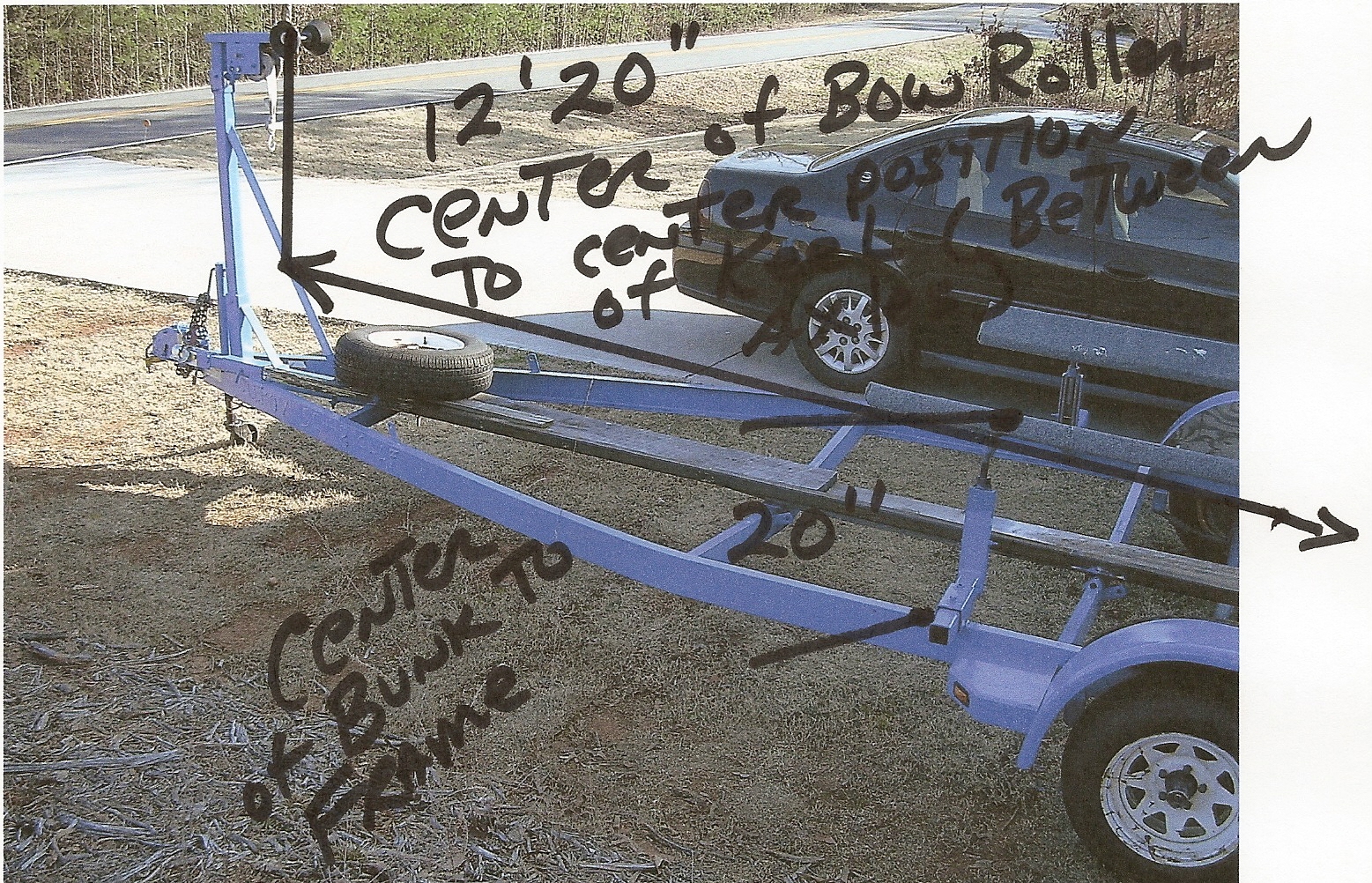

I stumbled across this post, and picture 102_0370 is actually my boat. That pictures is from 4 years ago, and I will soon be modifying the trailer to launch from. Any trailer can be easily modified, mine has a few strategically placed 4x4 and 6x6. This was supposed to be temporary, but it works and other projects have taken priority. My particular trailer is an EZ Loader, and seems like it would work fine. I would recommend a dual axle trailer. My plan is to jack up all the rollers, and replace the bunks on the back with more adjustable rollers. This way I can bottom paint on the trailer and slide the boat back if needed. Also considering adding something to help support the keel better.

Thanks kdssail! I appreciate seeing some dimensions. How far would you estimate the stern overhangs the rear of the trailer frame?

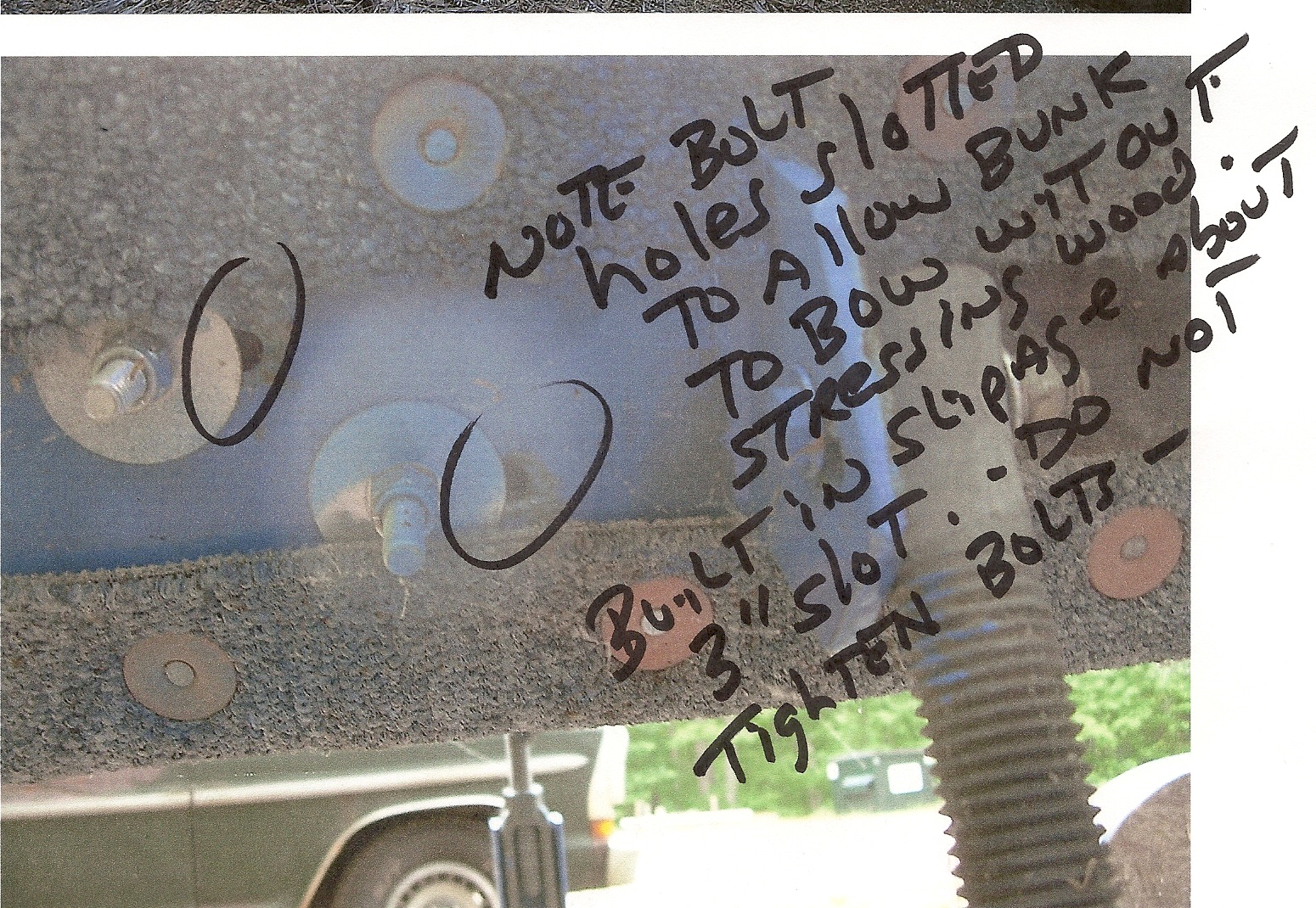

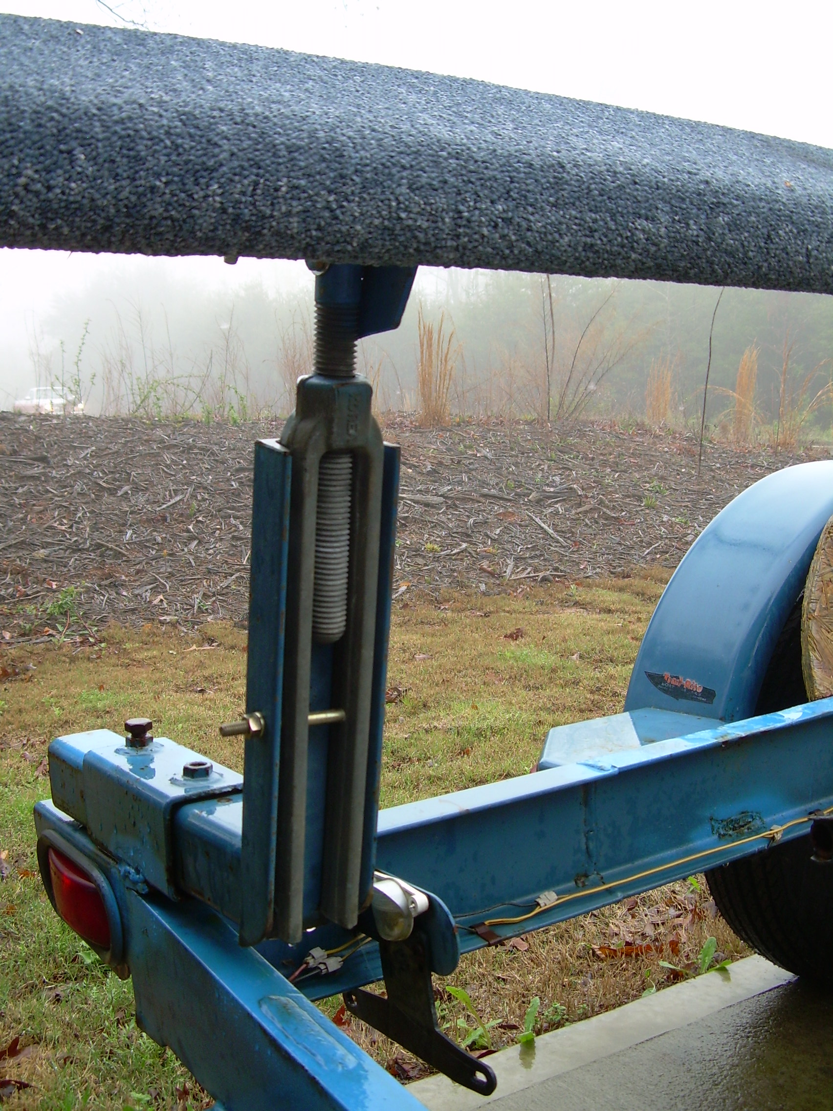

Not trying to dig up an old thread but the info posted here is gold for me as I am currently building a power boat trailer into a trailer for my O'Day 25. Curious about your adjustable bunk setup, is that just C channel with an adjustable steel bracket bolted in it? What is the name of that bracket or where abouts in the hardware store/online can I find one?

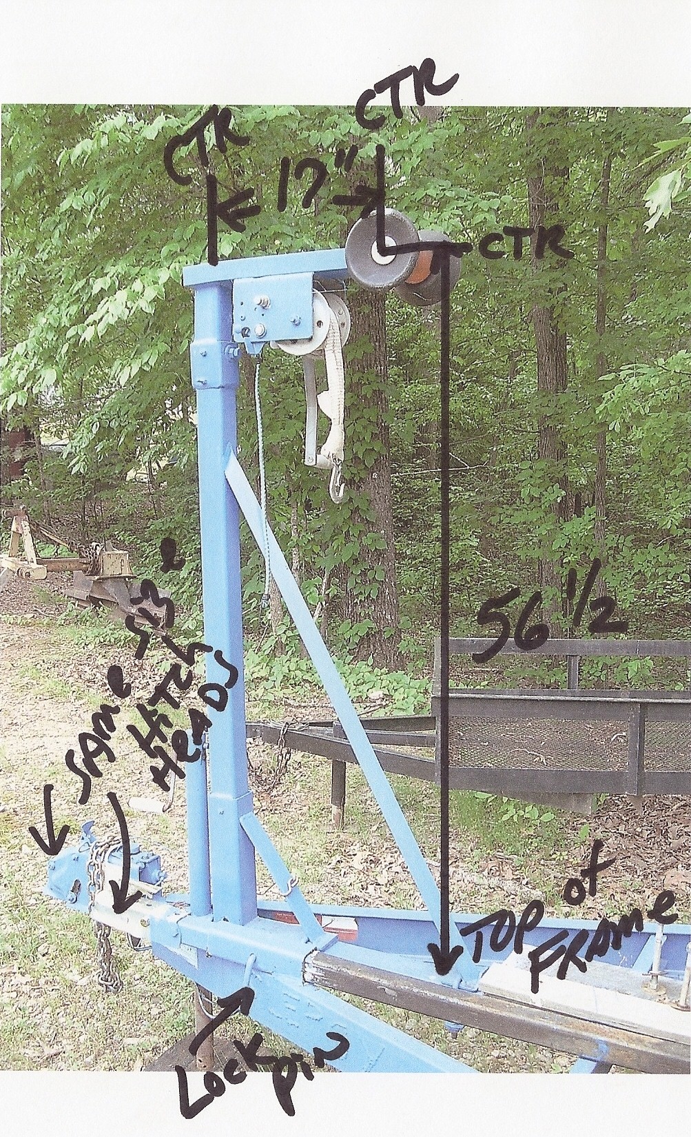

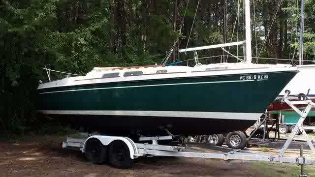

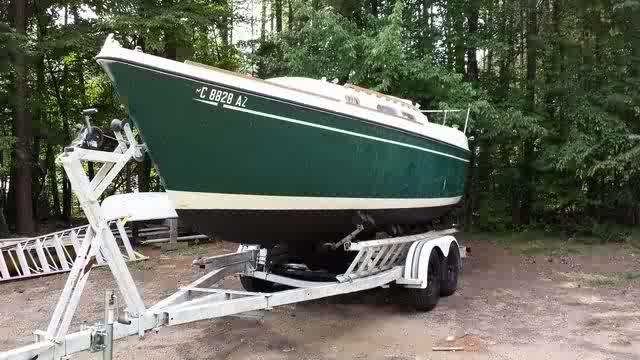

I also have our 25 Oday on a trailer . I've changed quite a bit to be able to step the mast and launch without assistance . Most was done for not a whole lot of money.
That looks like a giant turnbuckle cut in half
