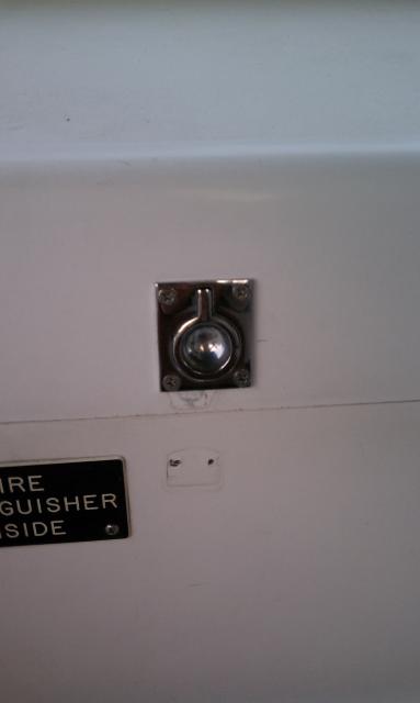

After cutting my leg again about two weeks ago I took the lock hasp off the port locker and installed a simple flush mount handle that has a ring that lifts up to open the hatch. Had in in the pile of boat stuff I have collected over the last 40 years and a hole saw the right size handy for the drill. Took all of five minutes to do. I put where the hasp screw holes were.
I'm glad I did it and not worried about locking it since a thief would do more damage removing the lock any ways. Plan to remove the other two also.
