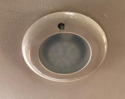

Are you talking about the puck-style ones or the spotlight style? I haven't found any bullet connectors, only crimped butt joints. I figured the issue was either the socket for the bulb or the switch. Replacing the switches fixed the spotlights that weren't working for me. I have these on order, so we will see how they work to fix my issue with the puck-lights as they look like a direct replacement.i found several problems with these lights:
the led bulbs are intermittent;
the wiring bullet connecteurs needed cleaning.
the toggle switches were actually fine.

I replaced one with an entire unit off Amazon. The whole thing, LED, bezel, integrated switch. I think it was around $10. Also the new one has a 3 position switch with one side being white light and the other red.Great find! I've replaced 3 now.
Anybody find replacement switches for these? Having similar intermittent switch issues.
