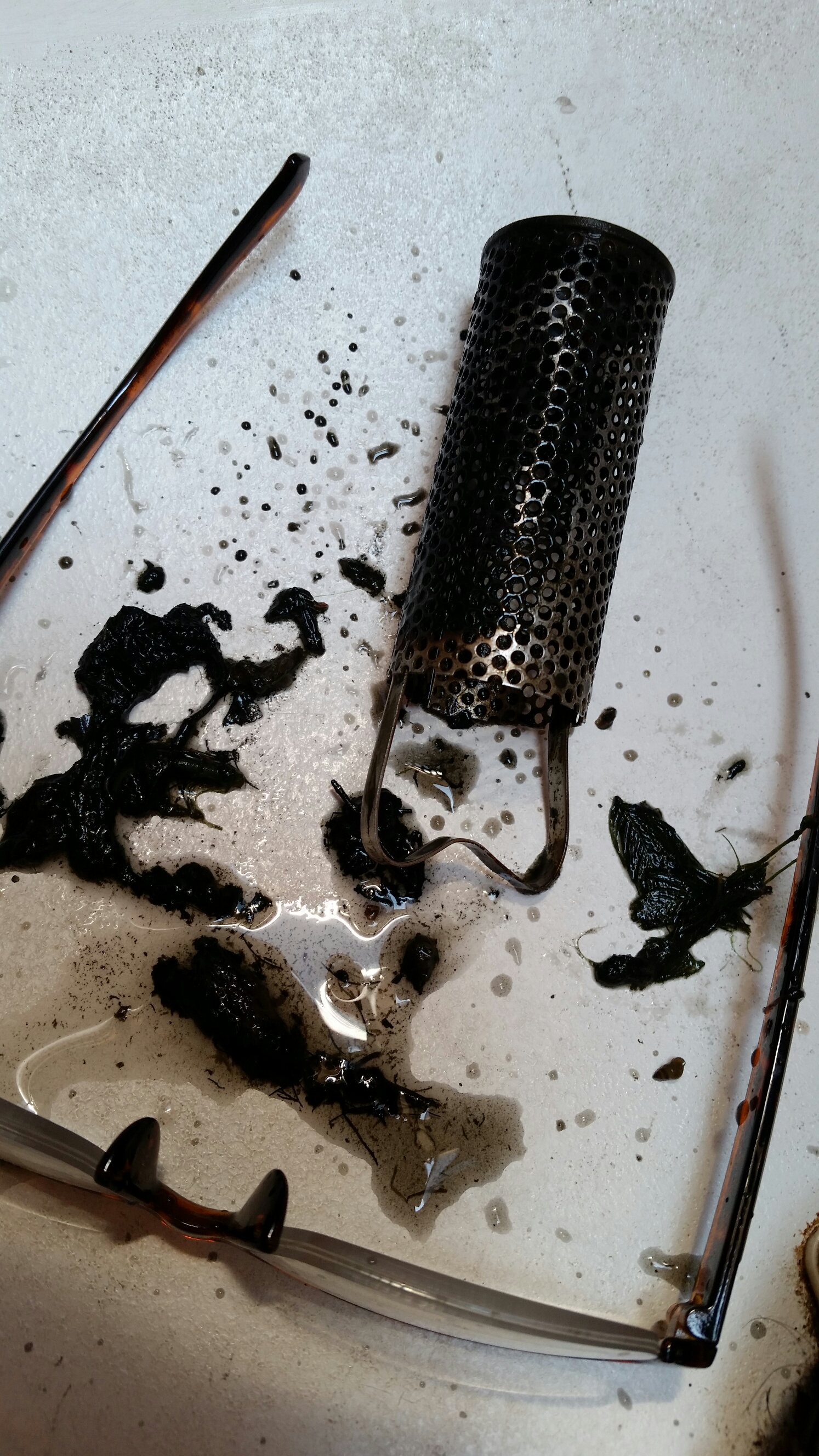

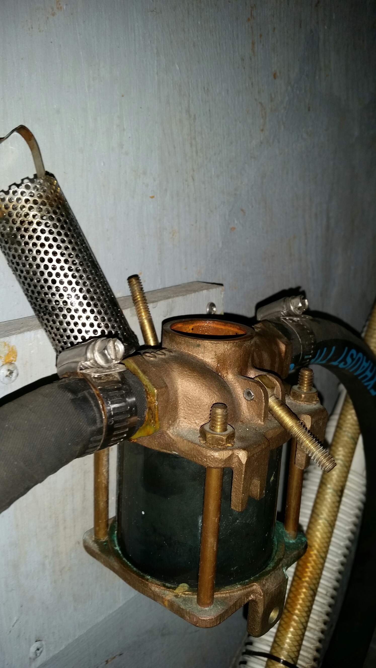

update...just back from my boat...started motor, good news, cooling water is coming out of engine...also checked my raw water intake strainer (1st time this season) and results can be seen in 2 of the attached photos also taken today. 20160826_144141_resized.jpg 20160826_144001_resized.jpg

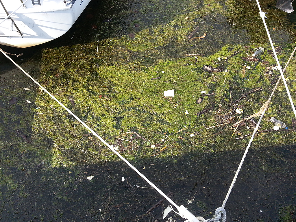

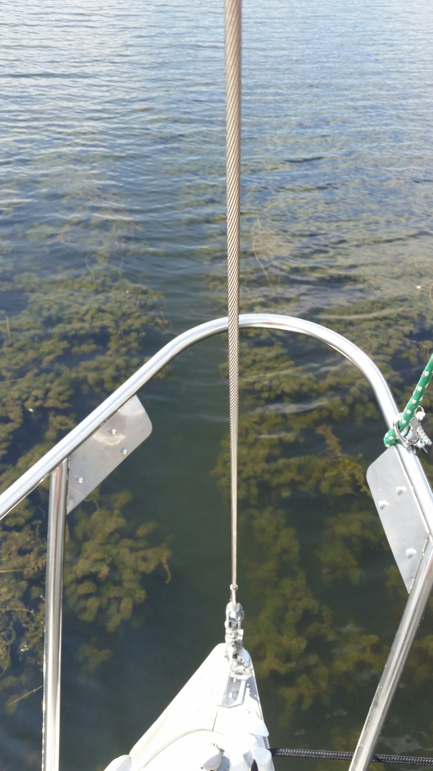

If you look carefully at 1 of the photos, you can see my path through the seagrasses 2 nights ago.

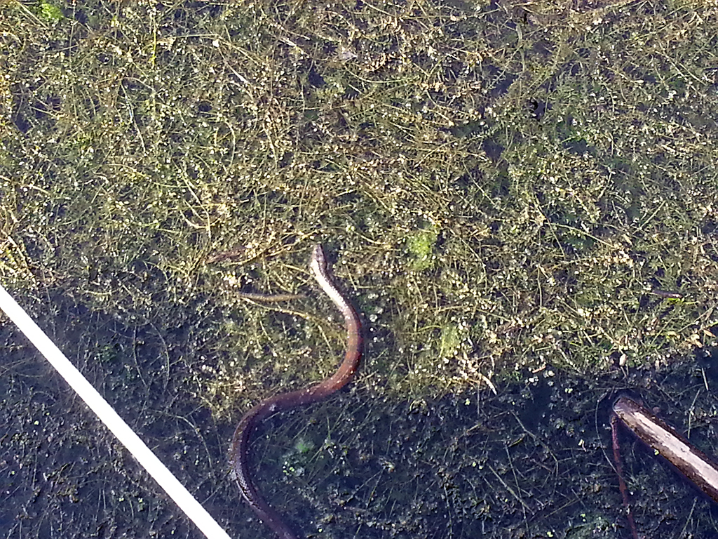

Can anyone identify this type of seagrass?
Is it Hydrilla?
