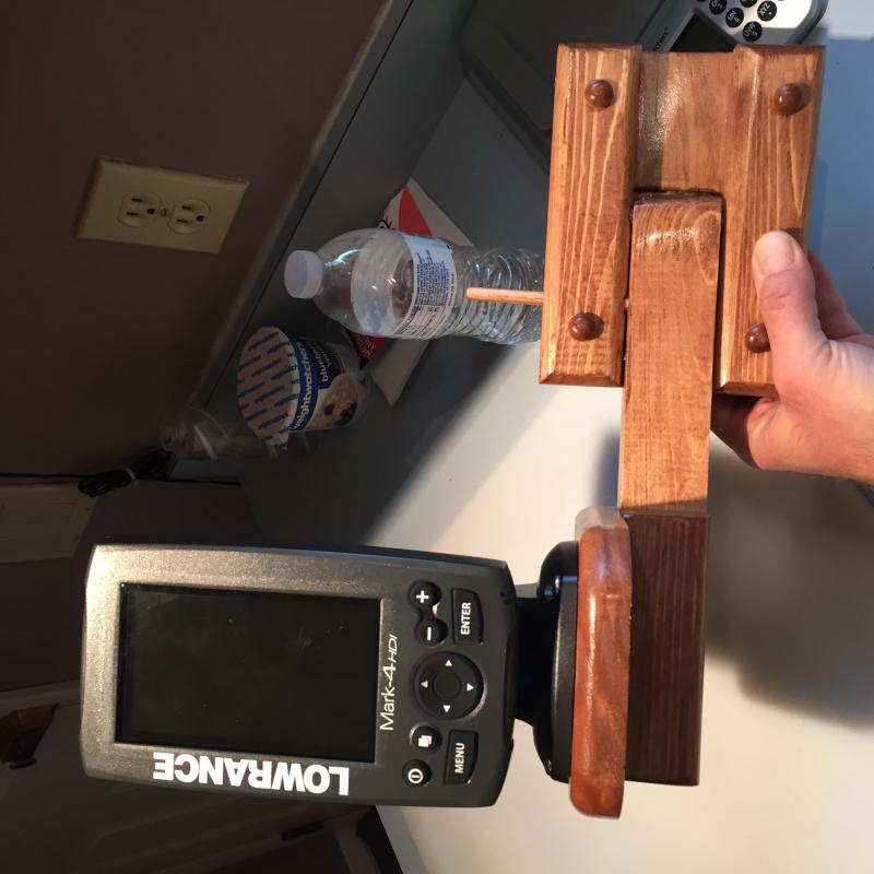

I bought a small GPS/finder unit for my 240. I was feeling cheap so I made this wooden swingarm. It mounts inside the cabin and swings out to view from the cockpit. A wooden dowel will hold it at either end of the swing. It should hold up as long as nobody falls into it when it's in the outward position.

That looks fantastic...you got some fine carpentry skills. Would love to see what it looks like when it is mounted. Right now I'm just using an android tablet for a GPS but would like to mount something permanent.

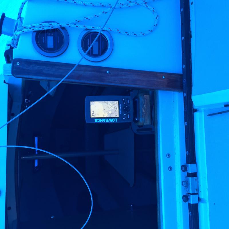

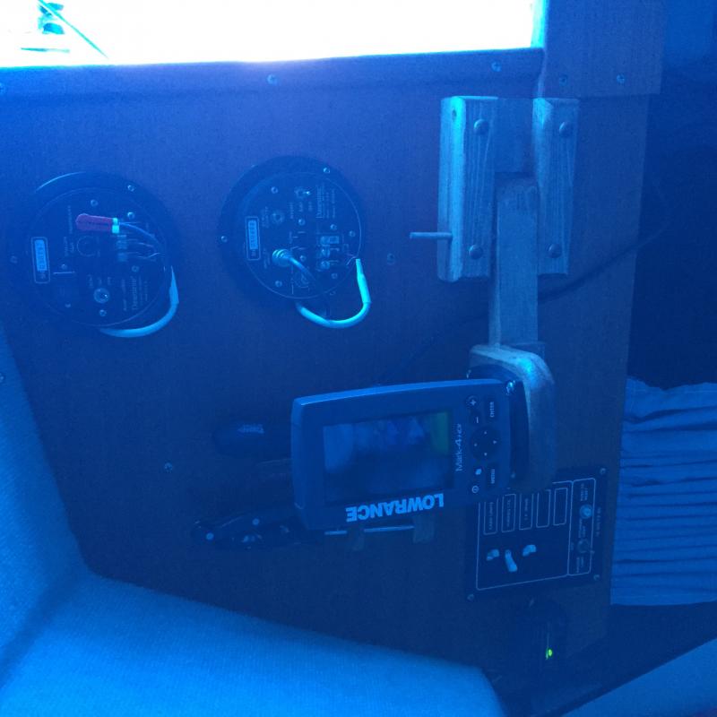

Greg, I attached a few photos. The boat is still covered as a result the pics came out dark.

Thanks for photos. I’ve seen other versions of swing brackets for mounting a GPS, but I think you made the best one yet. Looks both sturdy and very attractive in varnished wood.
I think I might put that on my to-do list (although I doubt it will have the same level of finish). Quick questions—looks like you have a dowel to lock it in either position, right? Also is the center hinge on a wooden dowel rod as well?

Yes the pivot point is on a 5/16 dowel. I use a 1/4 inch dowel to lock it in place.
