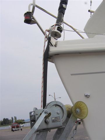

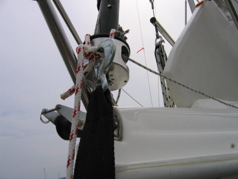

Jesse:
Yes, it can be difficult, especially if it has been a while since you rigged the boat. The 316ss shrouds shrink a little after being derigged. Have you reviewed the rigging instructions for the H260 at this link?: http://h260.com/rigging/rigging.html
I assume you are using the ginpole/mainsheet/spin halyard to pin the forestay. I've used the trailer winch to get a little more purchase on the forestay. See the pictures. More often I pin the furler in the slip and there I use the vang attached to the bow "U" bolt.
A Loos Gage to measure shroud tension is helpful but not essential. Once you get the forestay pinned you can check the tension on the cap shrouds and if they are within tolerences you are OK.

Thanks everybody. My conputer crashed and I have just now got it back up and running. I do use the ginpole/mainsheet/winch method and used to not have as much trouble. However lately I have to be careful as the gin pole tends to bend before I can get the pin in stem fitting. I really just use the trailer to get that last inch! I did not use the boat much this year and I beleive George's idea re shrouds shrinking a little may contribute. A copy of the lauching checklist (very nice) is posted in the cabin. I don't have a loose gage but may borrow one.
