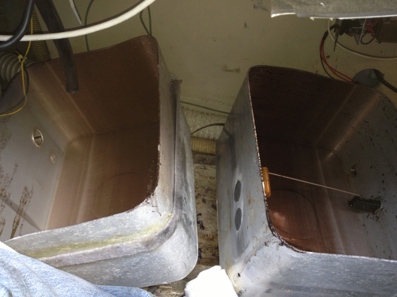

Progress report - So far so good. Bilge had lots of diesel in it unfortunately. TG i put that bilge filter in years ago. I had the tank unstrapped previously. I dipped the tank and found plenty if fuel in it. I hooked up the12v pump to the fuel feed valve, after i disconnected the line to the engine. I pumped a full 5 gallons out of the tank with it just sucking air at the end. I then removed the dip tube so i could use my oil vacuum to get the remainder (great idea Woodster). Then i cut the fuel fill hose with my sawzall and pulled off the vent. I tilted the tank so i could get as much out as possible, which was less than a liter. I also tried starting a cut in the tank with an old blade. Seems feasible, so after a break i will lay down a bunch of absorbers and go for it.
BobM
Jun 10, 2004
3,269
S2 9.2A Winthrop, MA
I lined a met tray with aborbant mats and inverted the disconnected tank over it. Nothing came out. It took less than five minutes to cut the tank in half. The tank fit fine in the original mounts. I just shortened up the straps. The flexible filler hose worked fine. Sorry no final pictures yet, but my phone died.

man thats a shame you couldn't get that tank out in one peace it looks like a welding shop could have repair the leaks and you could have reused it for 30 more years...

Your not wrong Woody
regards
woody
Given that it was leaking...it is a pretty heavy duty tank and it really is a personal decision to cut the tank or pull the bulkhead. In my case, given the choice of removing the bulkhead for the quarter berth...which is tabbed in and has my battery charger and a number of wires attached to it, I decided to change the tank as it was more expedient to do so and I have money but no time (I only sailed ONCE this year). Tank was about $120. I had to buy 10' of fuel filler for $100, but I have8' left (for sale!). Some 1/4 fuel line for about another $10, some absorbant mats to keep the job clean and some sawzall blades. Net cost for what I actually used was under $200, even if you include the $25 for the China Freight 12V pump and the total time will be about 5 hours. My bulkhead is tabbed all along the base. It just didn't seem easy to get to cut it and then I would have to put it back.
I think the problem is the absorbent wrapping they put around the tank and dissimilar metals...stainless straps around an aluminum tank. The leaks were right under the forward band. So, a little water on the inside from condensation...more on the outside from condensation...and viola...pinholes. If your tank is good, I'd shy away from re-installing it with that absorbent material and uses something like rubber instead. Or replace the bands with plastic ones.

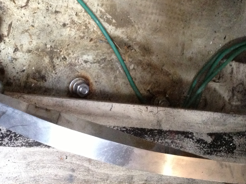

I am still trying to figure out a few things about the install. I want the straps tight, but can't have them too tight because you have to allow for 3% expansion per the manufacturer. So I did end up putting some of that absorbant material under the straps on the top of the tank to allow for compression/expansion. I still need to work out the grounds (probably unnecessary for safety, but required for the fuel tank sensor...which isn't working yet. The ground is attached to the bolts for the skeg, which I found under the fuel tank. They looked fine.

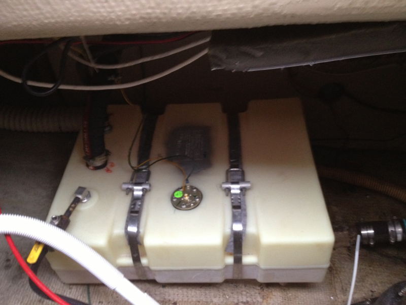

Wow...life is just got me down...which amazes me given we just sold our company . My sister-in-laws Mom died suddenly. Then we both were sick all weekend after we baby sat our nephew overnight to pitch in as the wonderful lady who passed had volunteered to do so for the whole week her Daughter and her Husband were in Ireland for their first real vacation in nigh 20 years. This unavoidable set of circumstances left me still in the middle of my fuel tank replacement with snow due to fly any time now. I think my record is Nov 9th, but i also have a couple of business trips the next two weeks. Suffice to say i was miserable fretting about it with my nerves already raw from all the anxiety associated with work
I was going to ditch out of work Monday, but i was not well enough yet anyway. I was going to do it yesterday, but there was a crisis i had to deal with that blew that. I snapped at my wife last night and she still wasnt talking to me this morning when i left to hit the boat this am. Two hours to do a 45 min drive.
After some miss steps i got the hose from the tank to the Raycor in place. I chickened out and decided to change the filters next year. I seem to have managed to get the air out, knock on wood, as after a few attempts, the engine has been running for 20 minutes without a hitch. Given my 2QM15 only burns about a cup of fuel every 30 minutes i plan to run it a solid hour to be sure it is okay and wont suddenly die stranding me in the rocks when i bring it into the marina soon. It is s pain, especially if there are others in the crane out slips and it is low tide.
Anyway, here is the long awaited finished product.
Bob

Bonus...the fuel gage is working and seems fairly accurate.
