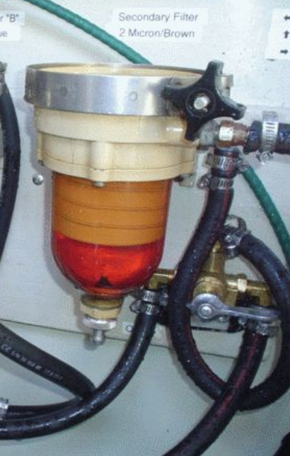

Hello,
I am thinking about replacing the ancient Racor 200fg filter on my Yanmar 2gm.
The stainless steel band that clamps the lid down with a side-mounted knob is difficult to secure and the bleeder valve on the bottom is somewhat stripped.
So, what would be the best replacement?
Would the Racor 500fg2 be the right call?
Also, when I do replace it, would it be wise to keep it in roughly the same position? (It appears to be at the same level as the bottom of the fuel tank, for what that is worth.) I would like to place it higher on the bulkhead to make it more accessible.

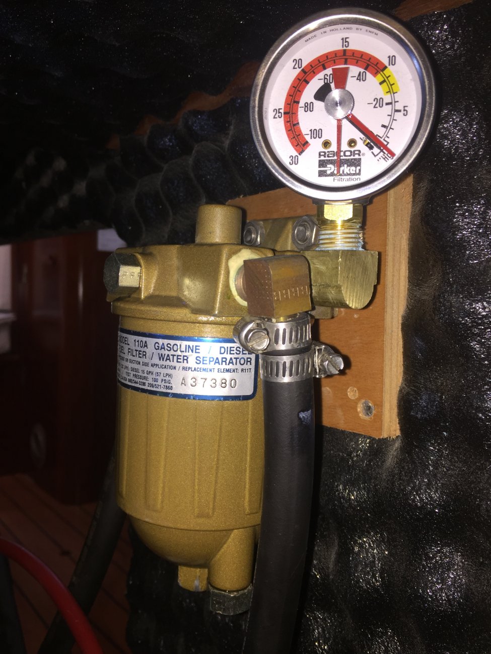

The Racor 110 will do the job in the same location. Add a vacuum gauge and you’ll never have to guess when to change the fuel filter. Just bleed the bowl every spring to determine if you have any water in there. This one is in the engine bay, so it is all metal.

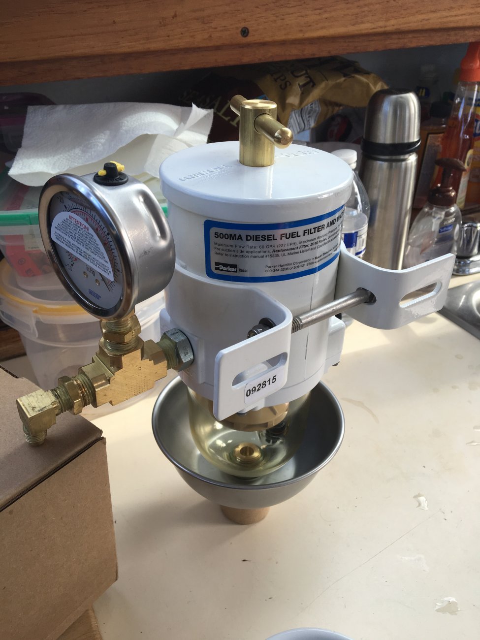

Parker/Racor page addressing CG aproval. https://www.parker.com/literature/Racor/Marine_Certifications.pdf
The Racor 500MA is the smallest filter that meets the standard for CG approval install in a diesel engine room when used on an inspected vessel.
United States Coast Guard accepted for use aboard inspected vessels per 33 CFR (Code of Federal Regulations). 500MA, 900MA, 900MAM, 1000MA, 1000MAM, 731000MA, 731000MAM and
771000MA.​
So yes with the metal bottom shield.
The vacuum gauge is an extra.

Quick question regarding the installing of the Vacuum Gauge.
In my 340 the Racor 110A is located just under the floor opening in the aft stateroom. There is zero clearance between the hatch opening and the top of the filter.
Can a Vacuum Gauge be installed on its side facing upwards?
The entire fuel line runs along the very edge of the flooring from the tank to the filter and after the filter there is about 2 inches of open area.
I like the idea of having the convenience of the Gauge, but location is not in my favor.
