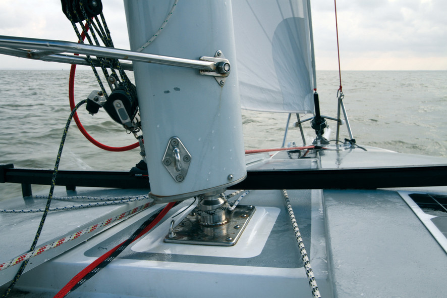

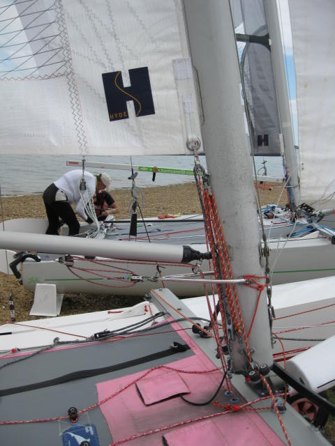

1. Figure out a way to limit the rotation of the mast when it's on the mooring. You could bolt a lever onto the mast near the foot, and attach lines to limit the rotation. Google "mast rotation control arm".
