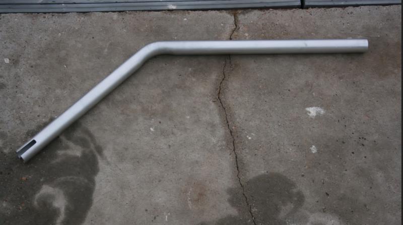

A friend stopped at a Mexican muffler shop, found some 2 inch OD thick-walled steel tubing, had the proprietor put in a 45 degree bend and make a couple of cuts to fit his e-tiller access.
$15.00.
