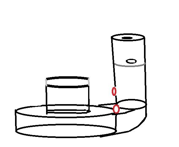

Purchased a new to me boat last year. Being new to outboards, I never knew there was supposed to be water coming out the hole out the bottom of the engine. I used the boat all last season, and no water ever came out the hole. So, I've now learned that hole exists, and one should see water coming out of it. I can't believe the engine lasted all season without any cooling. I never ran the engine wide open, and usually less than ten minutes at a time. Somehow it survived. Last week, I pulled apart the pump, expecting to find a damaged impeller, however the impeller is in perfect condition. I have blow air through the whole system, and air flows out the little hole, as well as down the vertical shaft. Put the whole thing back together and yet no water flows out the hole. I popped the rubber cover off, where the shifter access hole is. As soon as I did this, I could see water coming out he bleed hole. Basically what was happening is that as soon as there was any kind of back pressure against the exhaust, it would prevent the pump from pumping. Exhaust was actually coming out the bleed hole at the bottom of the engine. I looked at the pump and found there is a tiny hole that sprays water on the shaft. There was water coming out that hole, but no water pumping up the tube. I removed the lower unit again, and ran it with my drill. A small amount of water pushed up through the hole that connects to the tube, but as I put my thumb over the hole, there was no real pressure, and all the water flowed out the tiny hole that sprays on the shaft. Not knowing what else to do, I plugged the hole with JB weld, as well as plugged the hole that is drilled between the outlet and the pump housing. (Looks like it is some bleed back hole to drain the water out of the engine) Any way, plugged both holes, and now I could feel pressure with my thumb. Put the engine back together, and now have water flowing out the hole on the bottom of the engine like it is supposed to.
So, while it works, it all seems very strange. The holes I plugged are all original factory drilled holes. I have no idea why they are there, or how this was originally designed to work. Does anyone know? Does anyone have a DT-4, and know about these holes? Or do these holes not exist in other units?
