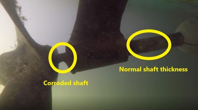

Almost two years since the last hull cleaning.
fstbttms . Feb 26, 2011 1,428 Achilles SD-130 Alameda, CA Jun 19, 2020 #1 Almost two years since the last hull cleaning. Likes: WayneH, DrJudyB and rgranger
Davidasailor26 . May 17, 2004 5,026 Beneteau Oceanis 37 Havre de Grace Jun 19, 2020 #2 That’s remarkably corroded. Is that a relatively in-wasted zinc just to the right of the normal thickness circle? If so; how does that happen?
fstbttms . Feb 26, 2011 1,428 Achilles SD-130 Alameda, CA Jun 19, 2020 #3 Davidasailor26 said: That’s remarkably corroded. Is that a relatively in-wasted zinc just to the right of the normal thickness circle? If so; how does that happen? Click to expand That anode had just been installed.
O odaydokay . Jul 5, 2011 702 Oday 28 Madison, CT Jun 19, 2020 #4 A stunning ad for replacing zincs in time..........
Ralph Johnstone . Jan 4, 2006 6,444 Hunter 310 West Vancouver, B.C. Jun 19, 2020 #5 Is that a bronze or SS shaft ?
FastOlson . Apr 8, 2010 1,942 Ericson Yachts Olson 34 28400 Portland OR Jun 24, 2020 #6 odaydokay said: A stunning ad for replacing zincs in time.......... Click to expand Looks a warning about 'stray current' as well. Yikes!
